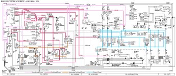

I went to hookup my shredder to my JD4700 and when I wanted to engage the the PTO, the engage light came on but the PTO would not spin. Someone has told me there might be a fuse that controls this but I would assume since the Engage light came on that it would not be a fuse. Does anyone have any thoughts, will they freeze up? Have not used the PTO in over a year?

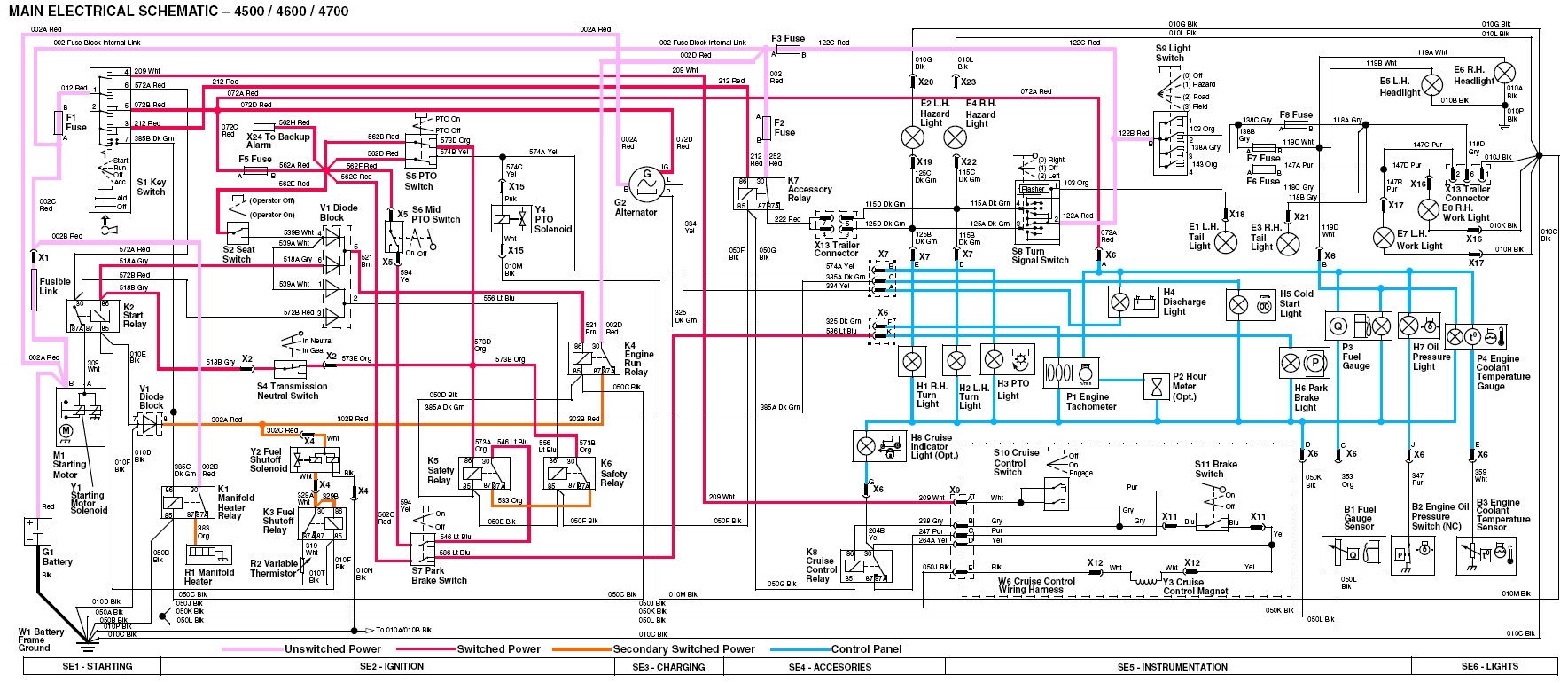

If problem is electrical this may help some.
   / JD 4700 PTO problem
Thanks, I will check the fuses to see if any are blown.
