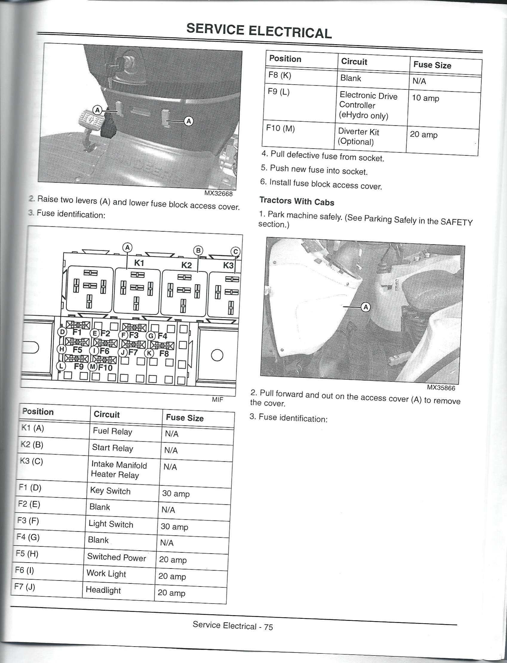

I have a question for all the JD open station 4x20 owners out there. The cab version has different fuses so I am not sure if there is any correlation.
My owners manual says that I have fuses in the following positions
F1 Key Switch 30 amp
F2 blank
F3 Light Switch 30 amp
F4 blank
F5 Switched Power 20 amp
F6 Work Light 20 amp
F7 Headlight 20 amp
F8 Blank
F9 Electronic drive controller eHydro 10 amp
F10 Optional Diverter Kit (Blank for my tractor)
Owners manual picture
I have fuses in the positions listed but I also have a 20 amp fuse in the F8 position which the owners manual says is blank.
I have been unable to determined what the extra fuse controls.

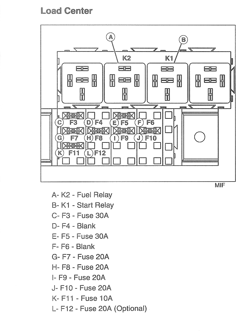

The JD service manual confuses the issue a bit as they label the fuse positions differently where.
F1 is labeled F3
F2 is labeled F4
and so on each position is numbered 2 higher than the owners manual. The relays are also labeled different in the service manual than the owners manual. (ie K1 is K2 and K2 is K1) In addition the service manual does not show a third relay, K3 Intake Manifold Heater Relay, that is in the owners manual.
Service manual picture
In the wiring diagram of the service manual it shows that K3 is the glow plug relay. I do not know if the glow plug relay and the intake manifold heater relay are the same but suspect that they are and just are called two different names in different manuals. When it gets cold enough to have to use the glow plugs where I am they seem to work with no faults. However now I find that the relay that controls them is not there in my tractor.
The service manual does have a fuse located in the F10 position which is the F8 position in the owners manual which the owners manual says is blank. The wiring diagram show this circuit to be the right and left turn light circuit. If I remove the fuse in the owners manual F8/service manual F10 position location the turn signals continue to work fine. I have been unable to figure this fuse's reason to be.

Does the owners manual have a serial number range? Does it match your tractor's serial number? You may have received an older, out dated, book for your tractor.
See if F8 is the headlights.
   / JD 4x20 Electrical system question
No; The fuse (second row third in from the left) that is in the owners manual position F7 and service manual position F9 runs the headlights.
I have to re-run the wiring both on the tractor and in the service manual and compare again. I am beginning to think my service manual does not match the tractor and the operators manual does not match the tractor. The operators manual came from the dealer with the tractor and the service manual from JD pubs after I gave them the serial number.

Latest manual for your tractor on JD's web site is J7. It also shows F8 as blank.
I'd be pulling the panel and seeing if I could trace the wires from F8. Later tractors (past your serial number by a long way) had F8 for headlights, which is why I asked.
