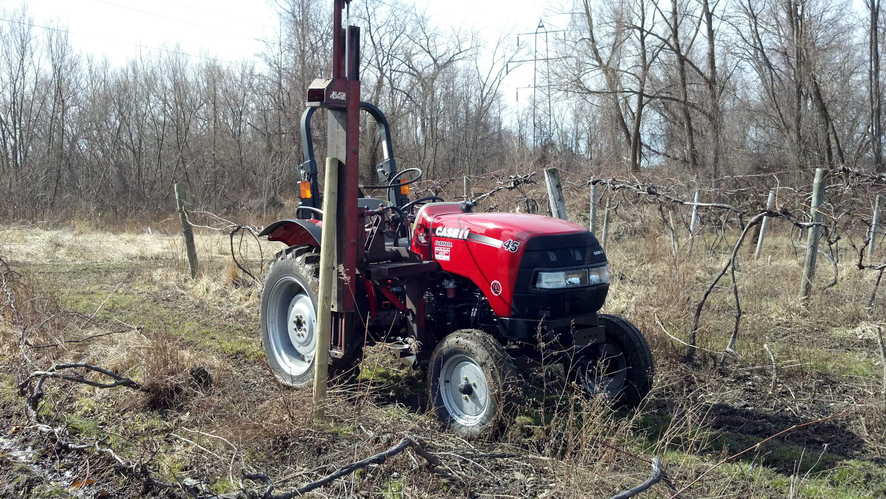

I just bought a Case-IH Farmall 45A which is the same as the New Holland Workmaster 45 and I love it. Its been a very good surprise as I was expecting a basic, no frills, bare bones utility tractor without much refinement but what I ended up getting was a very well thought out and put together machine that I enjoy using. I don't know what seat NH puts on the workmaster but the seat on my Case is very comfortable. The controls are easy to reach as well. The operators station as a whole is very comfortable. And best of all the engine is extremely quiet even at full throttle.
I bought the 2wd version and am considering buying another but with FWA and possibly going to the 55. I just can't say enough good things about it. If you have a Case-IH dealer near you talk to them. Looks are personal but I do think the Farmall is a much sharper looking machine then the Workmaster. Its amazing what a hood and different paint can do to the looks :laughing:
