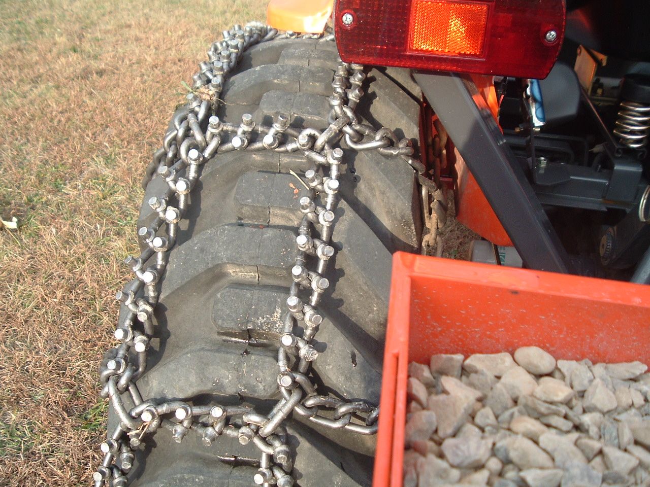

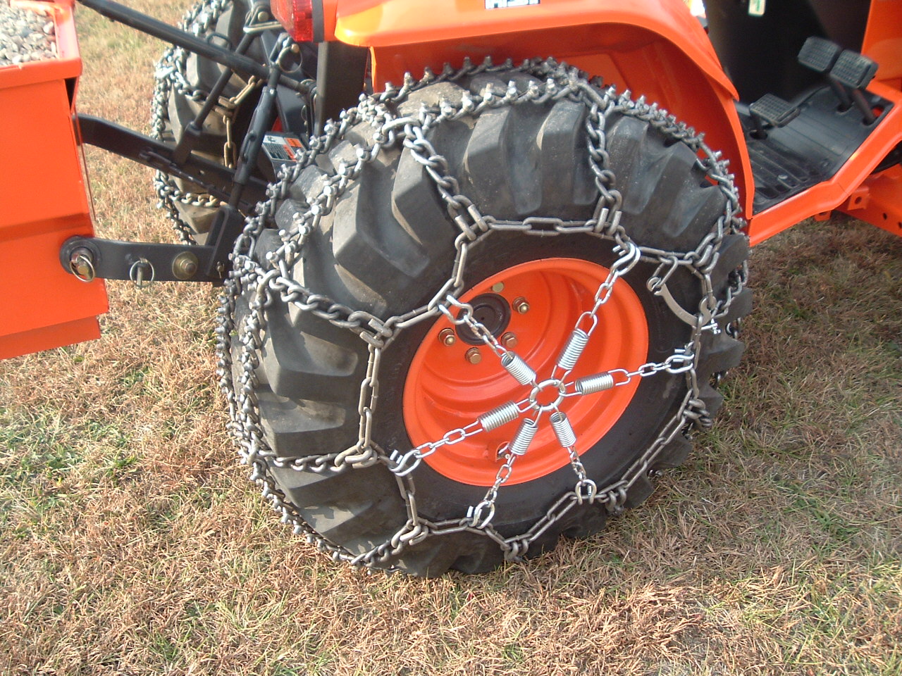

I have R4's and bought the most aggressive studded chains that I could find. Recommended minimum clearance between the tire and fender per the dealer was 2". It is tight but does work very well. Chain has to be snug and everything tucked and safety wired. Try these folks:Tire Chains by TireChains.com. Or these guys: Buy Tire Chains from the Traction Specialistsゥ. You can call these folks and and find out anything you want to know about tire chains. They are a significant investment and the call well worthwhile. These are Aquiline Talons. Not for an asphalt or concrete driveway.
