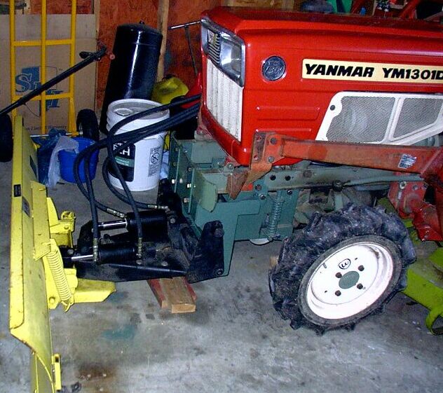

I just finished mounting a JD 54" hydraulic lift and angle snow blade to the front of my Yanmar YM1301D. I thought you guys might enjoy a couple of photos.
This blade was originally briefly used on a JD 317 garden tractor. It hadn't been used for at least 25 years when I got it.

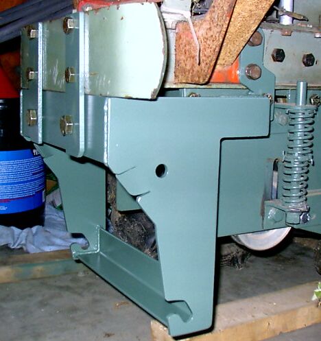

This first one is of the removable "adapter" I made. It attaches to the tractor with 4 removable pins.

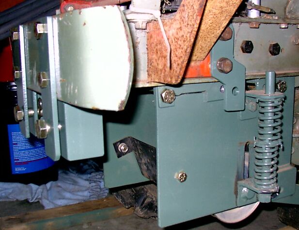

This photo is of the tractor with the permanently mounted brackets to attach the adapter. You can see the belly mower tensioner for the front pto on the tractor also.

This is a photo of the tractor with the "adaptor" mounted on the front. You can see that it is designed to accomodate use of the blade with the belly mower hardware mounted.

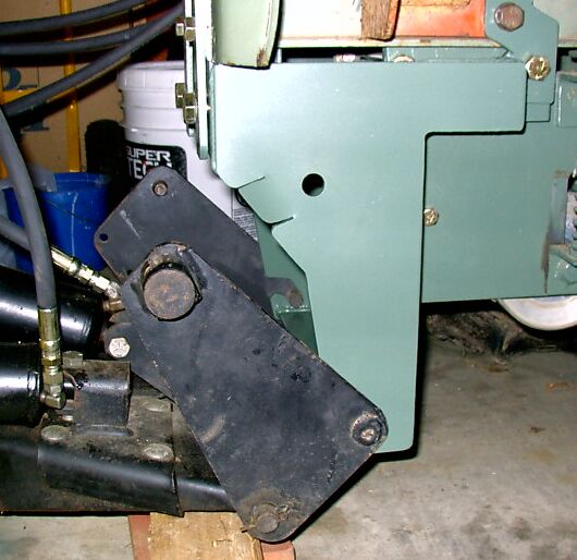

Here is a photo of the blade half mounted. The procedure is to have the blade resting on a block of wood of the correct height so that when you pull up to the blade, the fixed lower pins enter the slotted holes at the bottom of the adapter.
   / JD 54" Hydraulic Snow Blade
Re: JD 54\" Hydraulic Snow Blade
Once those bottom pins are engaged, you hook up the hydraulics, then work the lift cylinder as though you are forcing the blade down. This forces the top of the bracket on the blade back pivoting on the lower pins. The upper pins are spring loaded, and I made the adapter so that the pins are forced outward as the blade bracket is forced over the adapter. Then the pins spring into place in the holes on the adapter.
