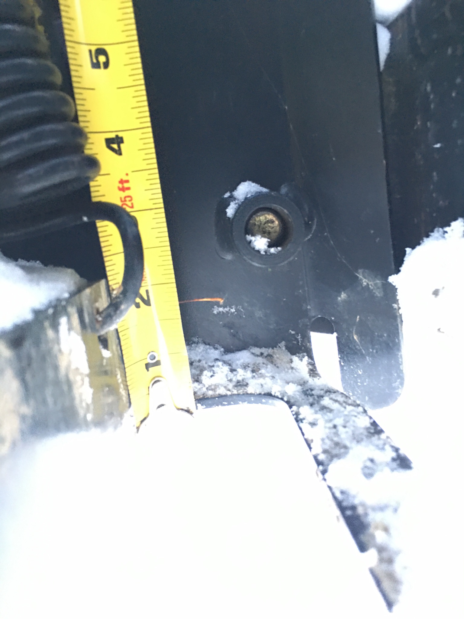

Hey all! Just preparing for the snow season and came across an unexpected deal on a front snow blade set up. Was planning on just using the front loader and rear blower, but couldn稚 pass it up. The catch though, the bracket for the blade is missing. I was wondering if there痴 anyone out there with a schematic/blue print of the dimensions for that bracket so I can fabricate one. Or if anyone has one available to sell, that could work too. I have access to steel, both a milling machine and lathe, so fabricating one wouldn稚 be to difficult. So if possible, an actual print or a pic of the bracket with measurements, would be greatly appreciated! Thanks in advance.

I have that set up. I took some pictures I can send if someone can direct me to the directions for posting pictures. Basic bracket is 4.5 x 16 3/8 across bottom, 7 x 10.5 on the two sides, and open on top. The blade side is even and the tractor side has flanges on the vertical edges bent in about 15 degrees so it slides in easily.

Sorry to be slow. Measured tonight. Snowy bracket and 0 degrees so could be off a bit. Top is about 3/4” back. Top corner of bracket is rounded and blade curves and I didn’t have a handy straight edge so it could be 7/8”. Middle is about 1/8. Bottom was hard to measure as the brace across the bottom of the blade is in the way. The pivot pin is about 3/4” back from front edge of bracket and about 1 1/4”above bottom edge. If other dimensions will help, let me know.

It looks like the centerline of the black rod is 5 1/8 back from front edge and 9 9/16 up from bottom of the bottom. The back of the trip spring attach piece is 2 3/4 back from front edge. The holes are about 2 up from the bottom of the bottom. Let me know if anything else will help (or if my description is confusing). Got about 4 inches of very fluffy snow yesterday and got most of it moved today.
