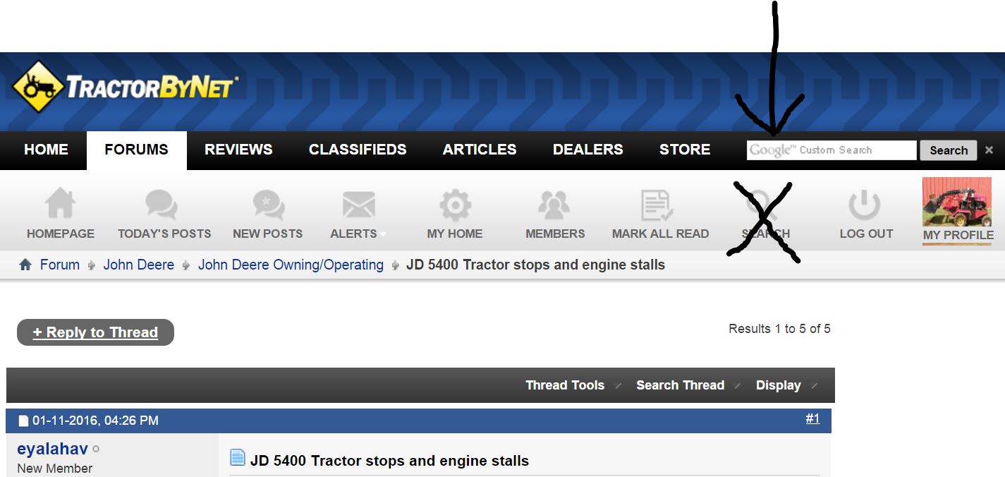

Dear Mr. Beethere.
I am new to this forum.
How do I "Search that model" and see if that is one that has the brake problems?
Is there a list of tractors for which there are documented "brake problems"?
Thank you for your help.
John Murphy, Engineering Services.
   / JD 5400 Tractor stops and engine stalls #5
There's a long history of JD 5000 series tractor brakes dragging from weakened brake disk pull off springs. My neighbor just completed R&R of these springs on his 5310. One needs to remove rear axle housings
   / JD 5400 Tractor stops and engine stalls #6
Use the "Google Custom Search" located at the top of the page.
