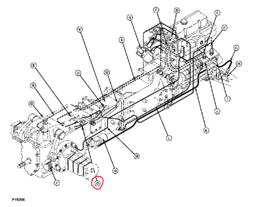

My knowledge of JD tractors built after '92 is very limited. A friend called me inquiring why his 5403 with 512 loader stopped having ability to pick up 1800# sack of feed. He stated he recently changed hyd filter & cleaned suction screen. I instructed him to plug a 5000 psi gauge in rear breakaway then move control lever to pressurize the gauge. Gauge registered 2500 psi instead of factory setting of 2800 psi. Which relief valve controls the system pressure?

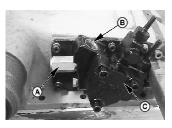

I have attached two pictures. The first one is where on the tractor you can find the main relief valve. It is item "O" on that diagram. The second is a picture of the SCV valve where the relief valve is located. The relief valve is item "A" on that picture. It doesn't appear that the valve is adjustable. The manual just says to replace it.
   / JD 5403/512 FEL low lift capacity
Thank you for info. I will forward that info to my friend.

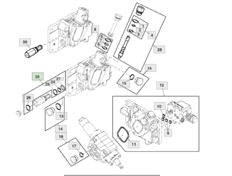

I searched JD 5403 parts catalog & was unable to locate the hyd relief valve. Would you be so kind to pst it's part #? Thanks, Jim
   / JD 5403/512 FEL low lift capacity #7
Here is what I found on the JD website- Item#30, P/N SJ290467. It's description just says "Kit" but in the comments it states "Relief Valve Sub Assembly". Hope this helps.
JD Parts Catalog
