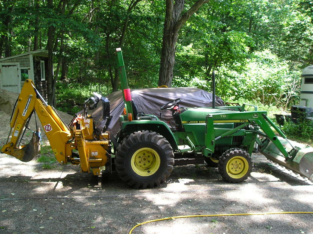

Hello,
I have a 770 and I am looking at putting a used #7 backhoe on it. The guy who had it has a 755. Does anyone know if the mounting kit from it will fit on to a 770?
Thanks in advance,
Bill

Hi Bill, no the subframe won't bolt up to the 770. However if you have any welding ability..might be worth trying to modify it...or you could buy the right subframe from Deere. A couple/three years ago I called to see if it was still available and it was at that time..most likely still is.
If you do buy it, make sure you do get the frame off the 755 and all the mounting pieces..you never know what will be needed.;)

Oh yeah, backhoes aren't cheap, but $2500 is a good price...and, $5000.00 for a mounted and ready to use backhoe is not a bad price at all. Are you sure you don't have the power beyond already? What you'll see will just be 2 hydraulic fittings with a single hose connecting them, situated just above the top link mount. Another way to power the backhoe would be a PTO pump and reservior tank, might even be cheaper than the power beyond installed.
I paid about $3700.00 for the Taylor Way 766 I mounted on my old 770. I also paid a few hundred for framing channel pieces and other iron, about $20.00 for welding rod. Then several weekends fabbing it and welding. It would've been much easier to have someone else do it or buy the subframe and just fab the hoe to frame pieces.

Bill, I've seen power beyond kits for your 770 on ebay for a couple hundred bucks or less. They are quite easy to install on your tractor. I had a 670 which is basically the same tractor and installed mine myself in about a half hour. I also have an operators manual for the #7 backhoe and the subframe doesn't look to difficult to install. If your up to the task, I say go for it and install it yourself and save a few hundrend bucks.

If you are talking about the sub-frame............you do not need to "break the tractor in 2" to put it on. I had a JD 770 with a 70 FEL and 7 BH.......the process to take the backhoe on and off was about 15 minutes. I believe that if you can spin a wrench then you can put a power beyond kit on........they don't look that hard. Also..........don't let BH price scare you.......your tractor will increase in value and marketability when and if you ever go to sell it and.........you won't believe how handy a backhoe becomes when you have one.
