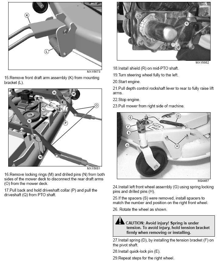

   / JD 72" Mid Mower Issue #7
Re: JD 72\" Mid Mower Issue
if i did this right, you should see a page
out of the op manual for the 4115,,
i'm sure it's similar to what the 2520 instructions
would say,, with a few differences..
but there are ways to make it fit
under the tractor.. turning some of the gage wheels
and removing that one front gage wheel..
let us know if this doesn't help ,, but your manual
should have similar instructions for your deck.
/forums/images/graemlins/cool.gif

   / JD 72" Mid Mower Issue #9
2nd page of instructions,, again for 4115 /forums/images/graemlins/cool.gif
