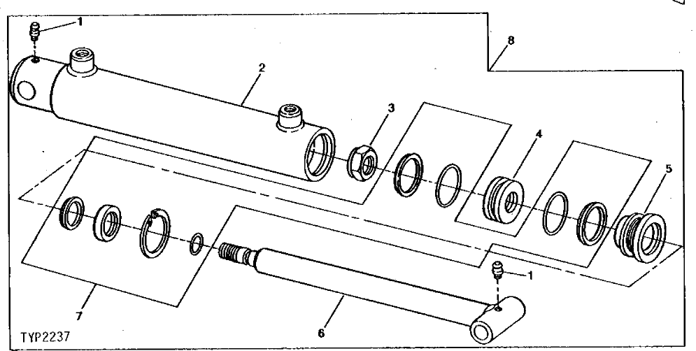

HI all .
I have done some searching about troubleshooting the loader hyd system , to find a specific problem I am having with my JD model 67 loader, on my 750 tractor .
I thought if I described it here , maybe someone could narrow it down for me.
I recently bought the tractor , and it had this problem when I bought it .
It seems as if the loader cylinders are leaking by , or the valve for the loader cylinders is leaking by .
The loader will not lift the front of the tractor off the ground , nor will it lift the back of the tractor off the ground (no counterweight, or loaded tires) .
IF I lower the loader , and lay the bucket flat on the ground , then try to "dump" the bucket , it will just start to lift the tractor slightly, then just push the loader arms up.
With the bucket in the "dump" position , resting on the ground , sometimes I can get the tractor to start raising , if I find just the right combo of valve position and high engine rpms.
The valve on this tractor is a two lever type .
If I run the bucket cylinders to the end of their stroke , either all the way extended or closed , I can hear , what I believe is the relief valve operating ( sounds like turning your steering wheel on your car too far and holding it there)
If I run the boom lift cylinders to their extremes you do NOT hear the relief valve much , if at all , making any noise .
I don't know if this is enough info to indicate either the valve . or cylinder leaking by , but I thought I would ask anyway .
Any info for further checks will be welcome
thanks
Joe

Joe, the cylinders are easy to rebuild and it's quite common for a machine that age for them to be leaking by internally. Most valves can't be rebuilt since there are very precise tolerances involves.

Check out the relief pressure with a 3000 psi hyd gage and see how close to specs are the hyd pressure readings.

I would rebuild the cyls as kennyd said about the age of you machine.

Here is the breakdown of the cylinders:
HYDRAULIC CYLINDER
(650 AND 750 TRACTORS)
Cart KEY PART NO. PART NAME QTY SERIAL NO. OR YEAR REMARKS
1 JD7826 FITTING 2
2 PT5249 HYDRAULIC CYLINDER BARREL 2 BOOM
PT5251 HYDRAULIC CYLINDER BARREL 2 BUCKET
3 14H863 NUT 1 3/4"
4 PT5246 PISTON 1
5 PT5247 SEAL 1
6 PT5248 ROD 2 BOOM
PT5250 ROD 2 BUCKET
7 AM118390 SEAL KIT 1 (SUB FOR PT5252)
8 PT5220 HYDRAULIC CYLINDER 2 BOOM
PT5221 HYDRAULIC CYLINDER 2 BUCKET
   / JD 750 compact loader problem
kennyd
To rebuild the cylinders I would need parts 4 , 5, and 7 ?????

I was waiting for kennyd to come back and help, but he must be offline. All you need is #7. You might want to wait until he gets back to you. That # 5 you might need.
   / JD 750 compact loader problem #8
Generally the seal kit, #7 will take care of everything.
Here is a quick and easy test: use the loader for a while, then feel the cylinders. If they are extremely hot, then you can pretty much bet they are bypassing-or at least one is.
Cylinders, like windshield wipers, brakes, headlights and socks should be changed/rebuilt in pairs IMHO.
