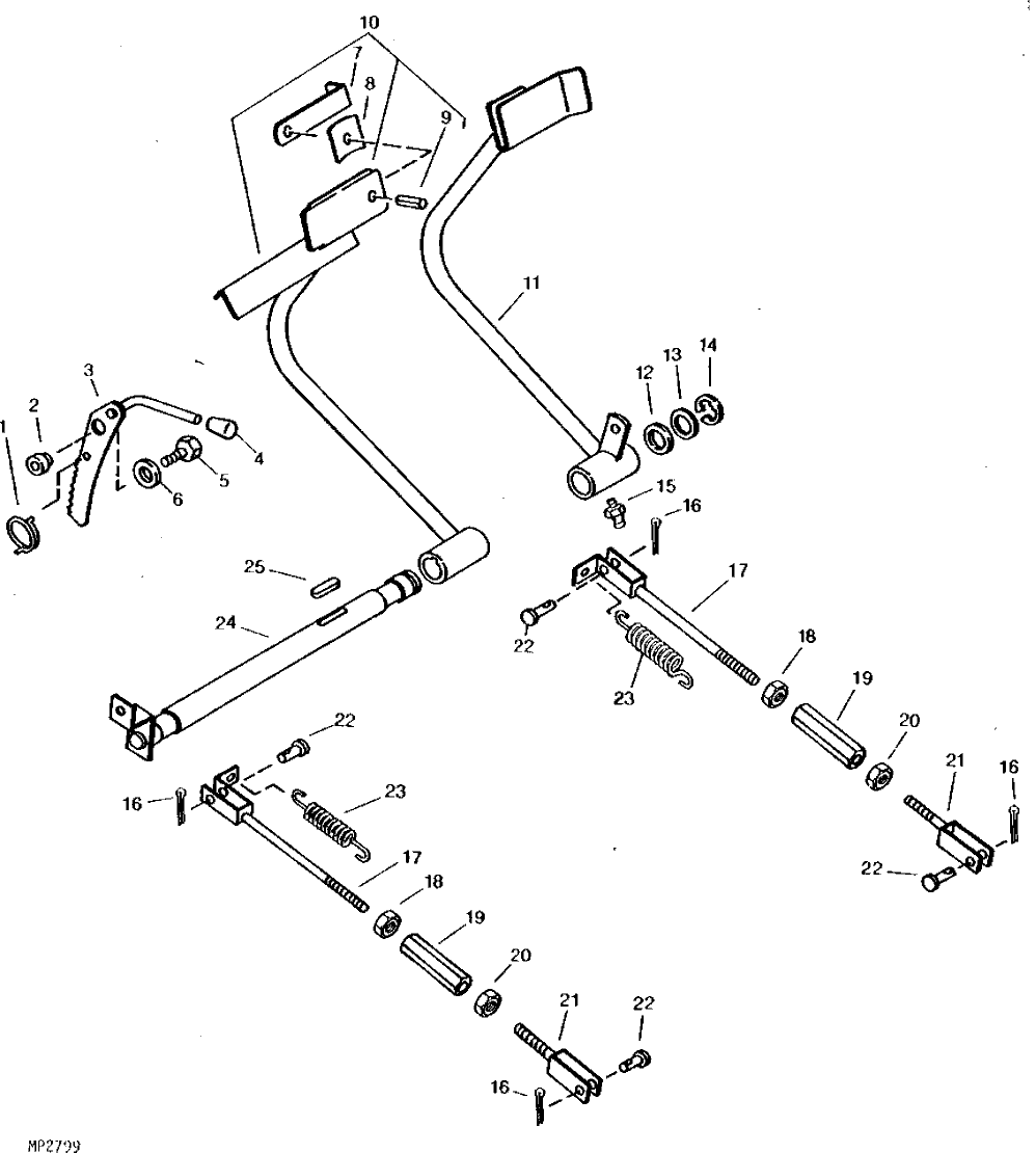

We have had 3 tractors come through with serious brake linkage problems. Found all of them with Brake pedals frozen down due to cross shaft rusted and RH pedal mount on shaft also frozen to the cross shaft. All the units came in with the same problem of loss of power, and serious smoke problems. Freed them up and solved all!

I will check out the brakes. I can get on a slight hill and see if it rolls freely.

I checked the brakes today (suggested in this thread). No problem rolling down a slight incline.
