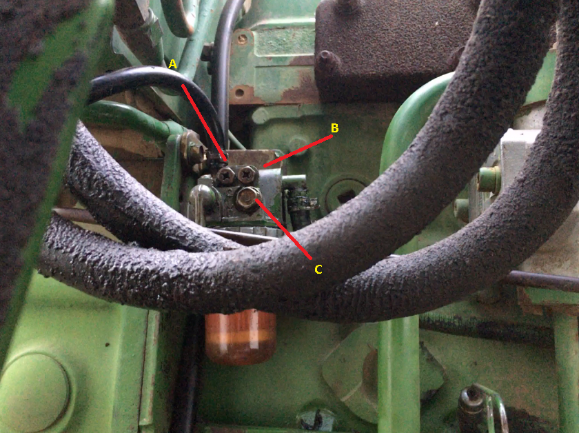

When I put the bowl back on, I removed the line coming out of the fuel injection pump to the filter from the filter housing. If I lowered it below the fuel filter bowl, fuel flows though, when I hold it above it stops(makes sense because where that line ends up going into the fuel injector pump is located higher up than the fuel filter bowl)--This also appears to be the last point that is receiving fuel.

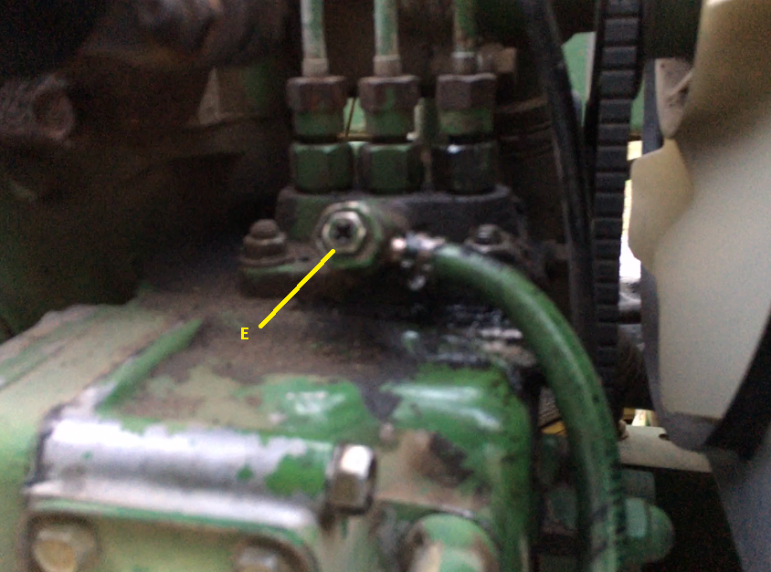

3. This is where I start to get confused on which screw/part is which. I unscrewed what I believe is a air release/bleeder screw right next to where the line from filter goes (This is the labeled "E" on the pictures i attached) into the fuel injection(the the injection side of the above mentioned line), Nothing comes out, I tried cranking the engine over for a few minutes, still nothing came out. Is this a bleed hole or am I just wasting my time messin with it?

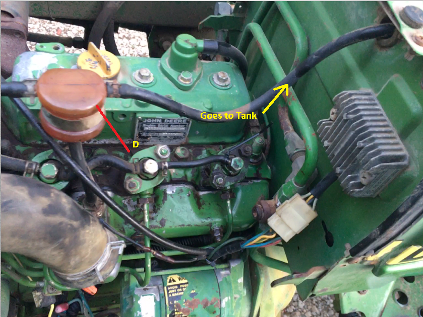

Also, could someone help me identify the reservoir above the cylinders (its letter D in one of the pictures I attached). One end im not sure where it is coming from (not able to look right now, but can find out) the other end goes back into the tank (return?) and then there is a bigger rubber hose that runs down to the air intake near the block. I originally though it was some sort of primer, but you cant really squeeze or pump it. It is full right below where the hoses on top go in and come out.Could this be the problem? Should it be all the way full past the hoses to create a suction/siphon in order draw fuel up?
