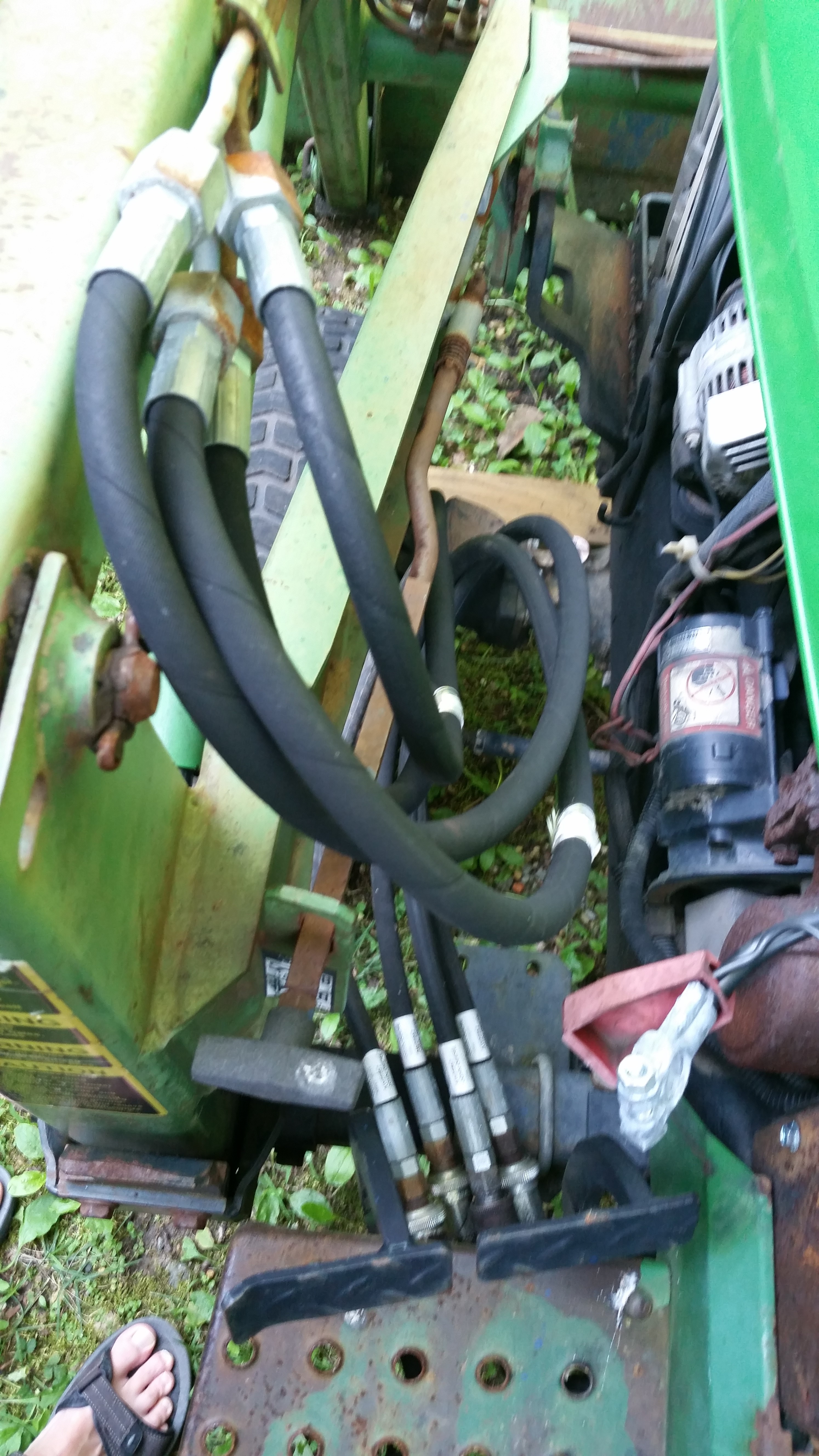

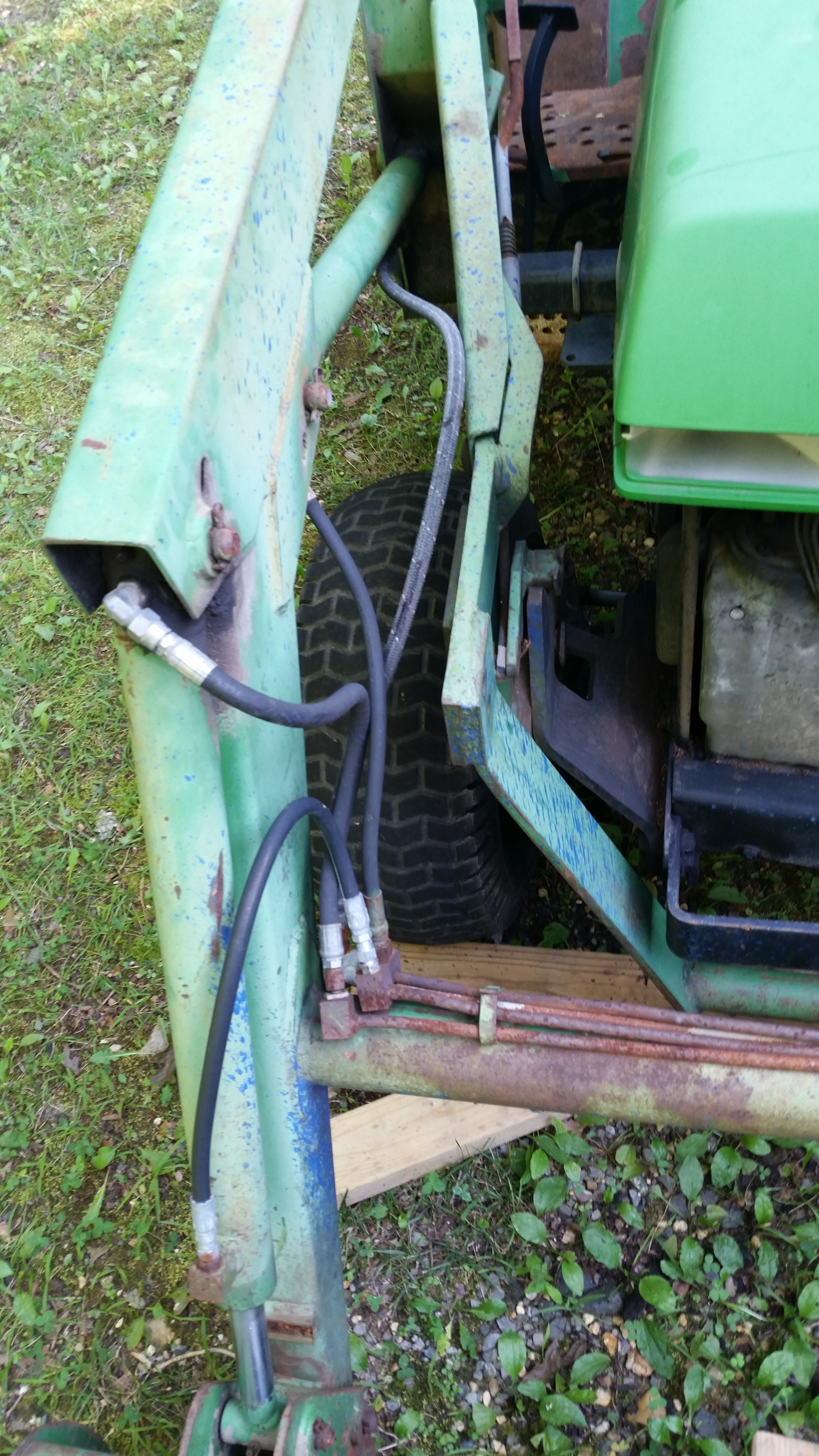

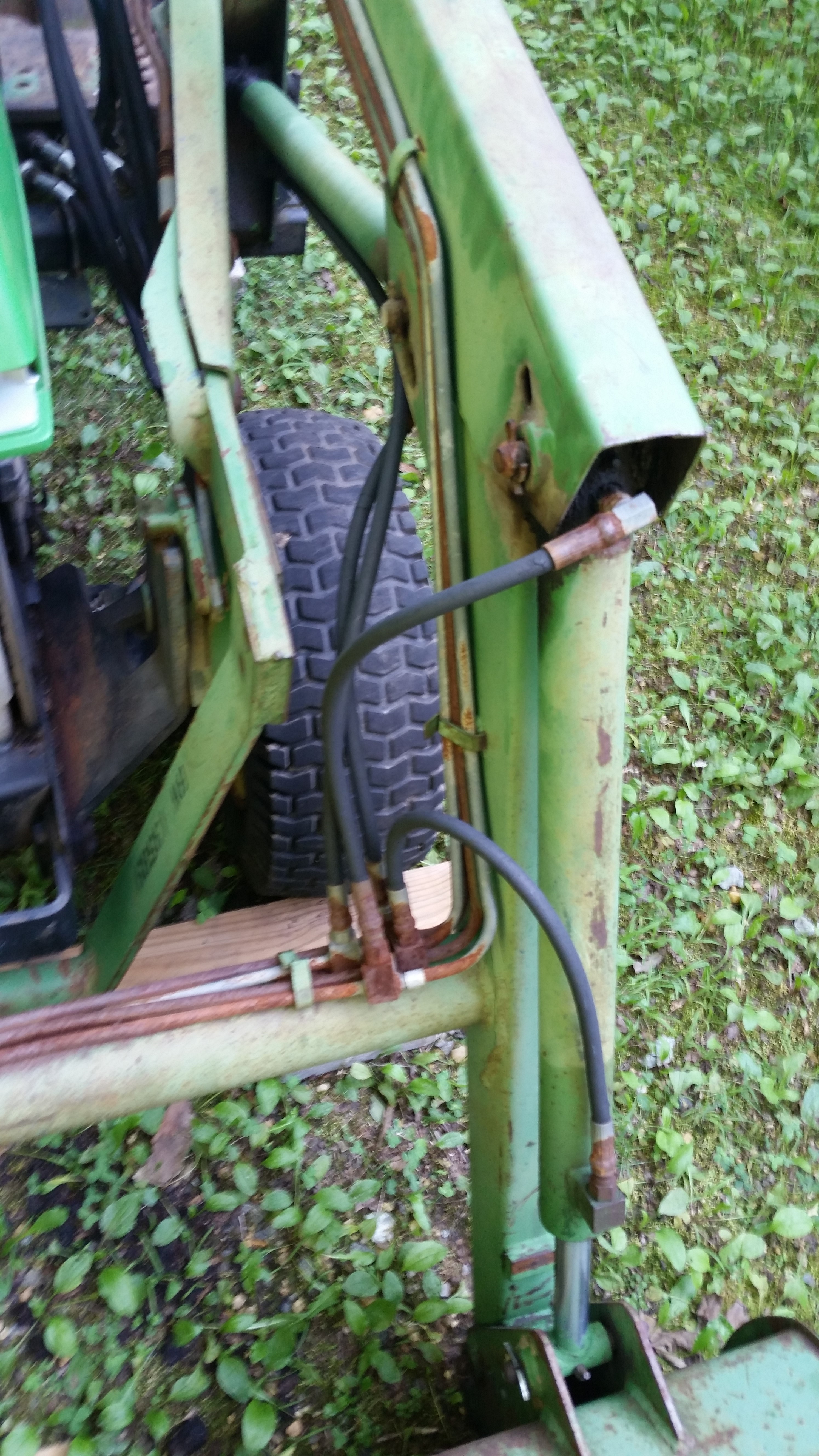

I was finally able to purchase a JD 755 with FEL and finish mower. The tractor has over a 1000 hours on it and has some rust as you see in the pictures. The one major issue with it is that the hydrostatic transmission stopped working. The previous owner was able to purchase a new tractor so he didn't finish fixing it. The furthest he got was to get the output drive off the tractor and get replacement parts, new washer and bolt. The issue with the hydro trans is that the bolt and washer sheared off of the output drive and fell into the transaxle. I got the tractor back to my house with the help of my brother-in-law and his friend and a nice wench from Harbor Freight.
Now I just need to get the tractor back up and running. First things first is to retrieve the bolt head and washer in the trans axle. I bought a couple of retrievable magnet tools off of amazon and hope they can do the trick. I really don't want to disassemble the trans axle but I guess I will if the magnet tools don't work. I know that there's an upgrade to the output drive that JD has but when calling the local dealer, the parts department guy wasn't able to find it. Does anyone happen to know what this part number is?
Currently, the tractor from what I see needs the following:
-New Grill
-New Taillights
-New Gas Tank
-New front headlights - ones above the grill
-New Paint
My plan is to work on fixing the tractor to an operating state and then work on the cosmetics and other things that need fixing. I have no experience working on tractors but hope that with enough resources out there, I can do a lot of the work on my own since money is tight. I do have the operator's manual, maintenance manual, and parts manual for reference. I might even try to make some youtube videos if there's enough time. Anyways here's the tractor.
