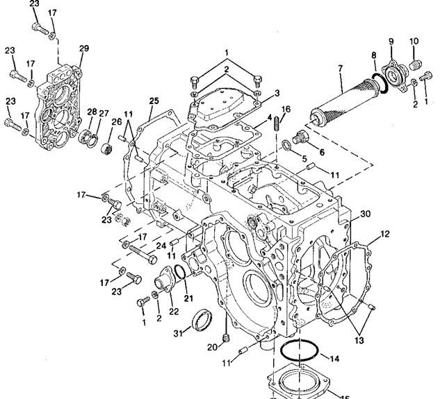

   / jd 790 fel #6
Here is a pic of the transmission screen that should be cleaned when changing tranny oil and filter. Part # 7
