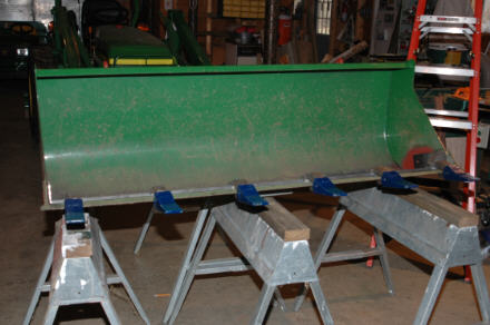

Hi All
I finally got off my duff and put all of the knowledge I have gained from all of you re: Toothbars and Bucket hooks on this site to work. I had a good day today, got out in to the shop early this morning and just came in. It is now 10:00 PM. I am not finished, but I could not wait to share what got done today. I have been listening and looking at all the fine work all of you have done and all my efforts just fell in to place. You are good instructors.

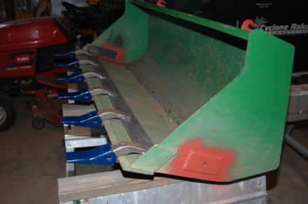

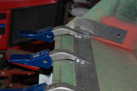

I have the tooth bar stuck together. Picked up the tooth adapters and teeth through a friend who works for John Deere at a good price. I had a bar of 1/2" x 3" and 1/4" x 2 1/2" for the side plates in the steel pile . I also added reinforcing plates at the side of the bucket where the retaining bolts came through. I did that because the side plates are made of 10 ga. looked mighty flimsy.

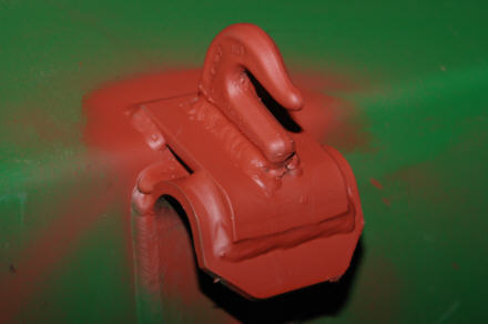

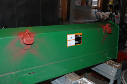

I welded the chain grab hooks on top of the bucket quick attache brackets. I will put a reinforcing bar across the top of the bucket and weld a slip hook in the center of the reinforcing bar. I am thinking of using a 1"x 1" x 1/8" inverted angle for the reinforcing bar. What do you think?
The hooks have strengthened the quick attache brackets. I am a little ticked at myself for undercutting the weld on one of the grab hooks. I won't do anything with it. The JD 790 will never pull it loose.
Will finish up next week hopefully and post some finished pictures.
Kids got together and gave me a canopy for Christmas got that on today also. Want to put lights on using the welding ground magnets and of course a cup holder. Got the tool box on last week. I like spending days like today. Have to get back to work rest of week. Theres always next week.
Thanks to all
Best Wishes
Ray

Looks great Ray,
But the plates welded to the side of the bucket are real overkill, those bolts just keep the toothbar from falling off, there is no stress on the side of the bucket.
The hooks look great!
   / JD 790 Toothbar & Bucket Hooks #3
Fine looking work, very professional. I think you will enjoy it much more since you did it yourself.
