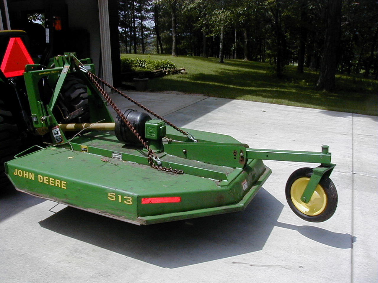

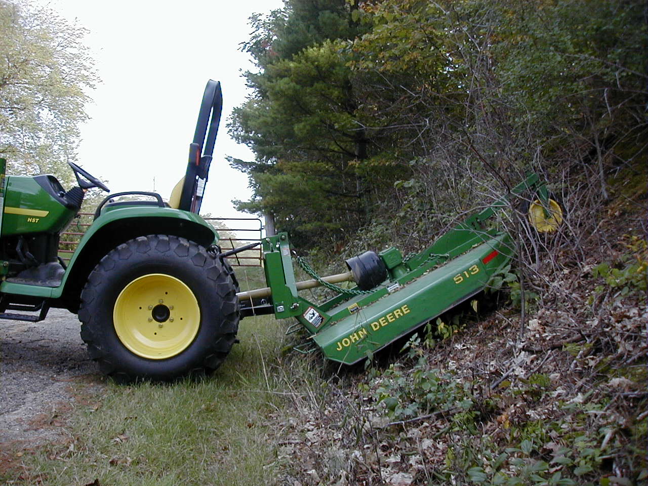

   / JD 790 won't lift rear wheel of my King Kutter 4' Bush Hog #3
I replaced the steel angled straps with chains, and made a much better attachment for hogging over uneven ground.
Pic of how that works, as the straps would keep getting bent from compression forces.
