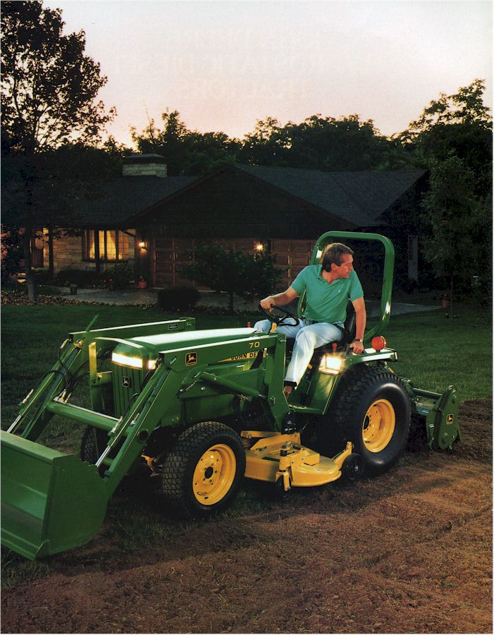

The 2520 and 855 are similar in size, within a few pounds weight and an inch wheelbase. The 855 does looks larger, especially when you sit on one. This may be because the seat is higher and the hood is flat, not sloped. The 855 tires are 33 inches tall. This picture may help give you a size comparison. BTW, check further on the model year. The last year for 855 was 1998. S/n number range checking is available.
