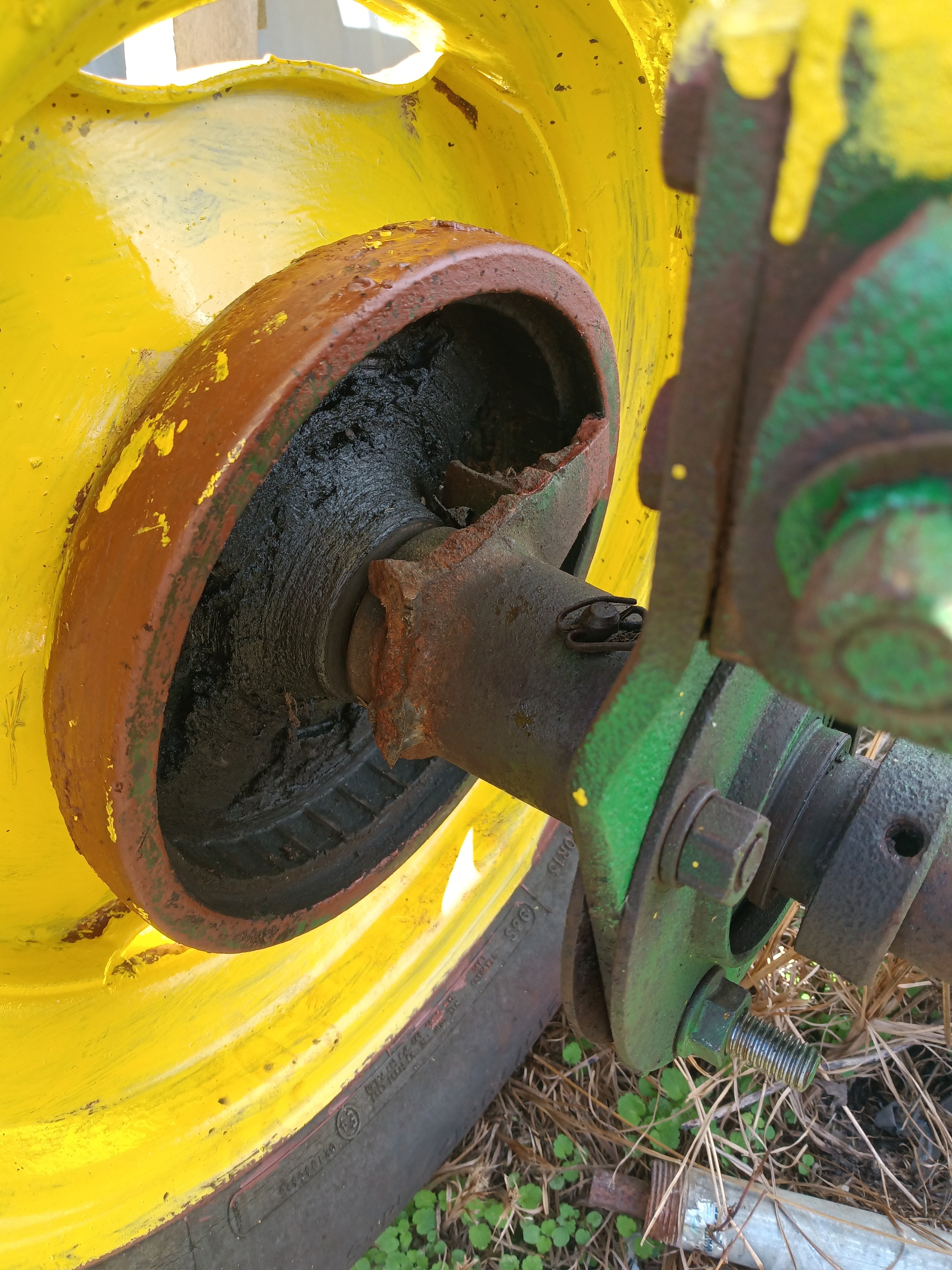

I have this hay rake I am re doing.
It has teeth worn out on the hubs that make the rake turn.
Can't find replacement parts.
Any ideas how to add some kind of clutch to lock the wheels?
Thanks
   / JD 896 hay rake #3
The parts catalogs are available on JD parts however you have to put in 890 instead of 896.
Looks like All State Ag Parts has a parts rake.
I would check the parts manual as it appears that there is a serial number break for most the parts in the wheel area. Then see if All State Ag Parts has the parts.
If allstates cannot help, then Midwest Made might be able to.
The parts will probably not be cheap, so it might be a good idea to start looking for a new rake.
