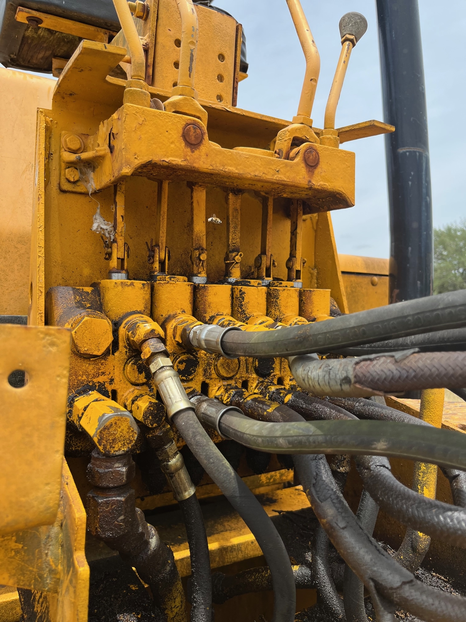

I'm nursing along an old 93A backhoe attachment for my JD 450 track loader. Of course it leaks hydraulic fluid from multiple locations but the worst culprit are some little round things located on one or two of the control valves between the two hose connections.
this photo shows the overall control valve setup on this old hoe....
and this photo:
shows the little round things that are leaking. It's the cleanest one in this photo that leaks the most and, curiously (to me, anyway), it leaks when I pull any of the control levers, not just the one for that valve.
What are those round things? They don't have any feature to allow a wrench to unscrew them. They appear to be pressed in place. They do have a sort of lip that would enable one to pry them outwards but they seem pretty well stuck in place.
Any an all suggestions would be most welcome.
Thanks
Scott

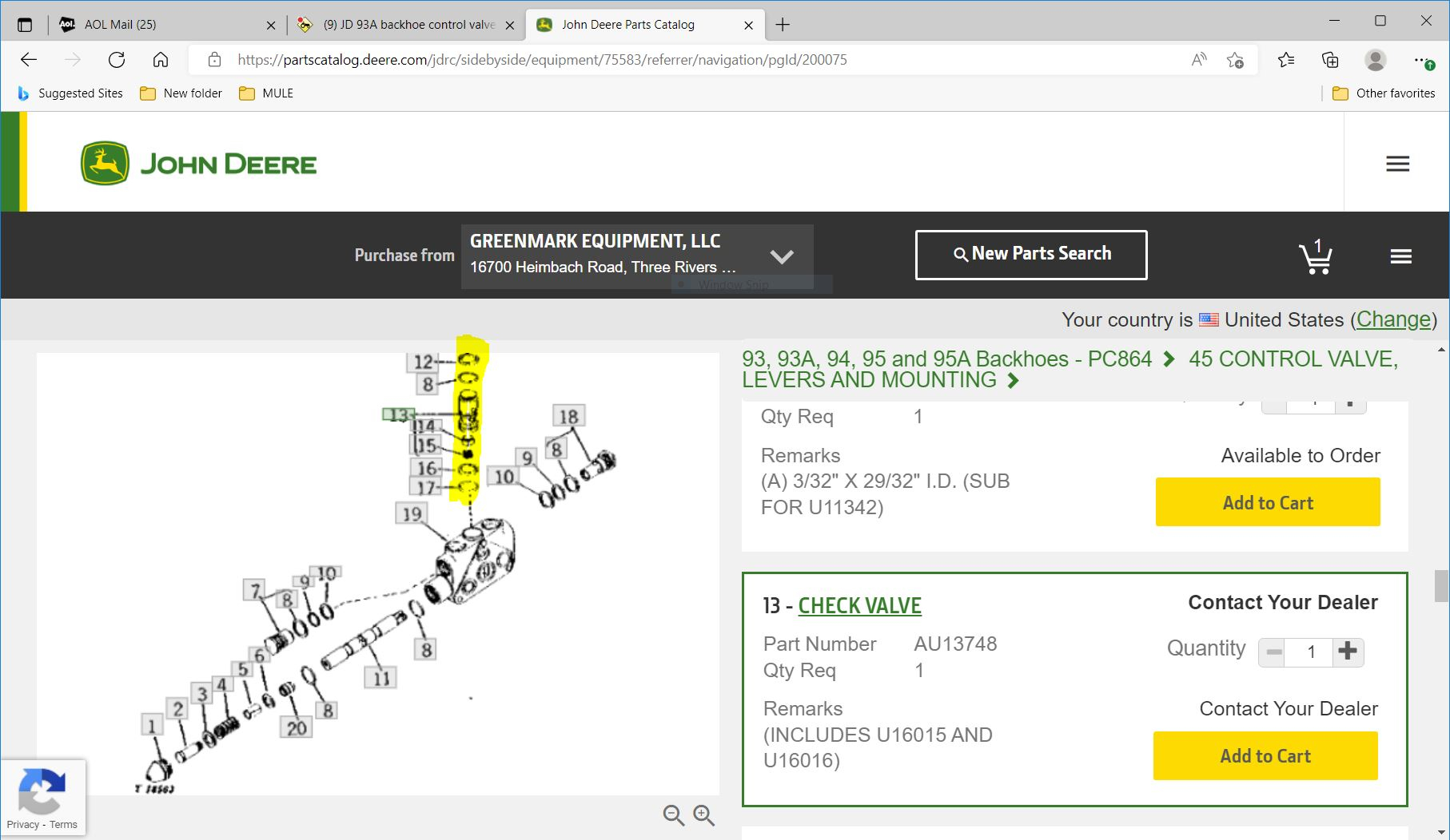

JD parts catalog shows a check valve in that location. I can't tell how it is retained in the valve body from the drawing
   / JD 93A backhoe control valve leak in odd place
Thanks, Zebra, that almost explains it. I see an O-ring and backup ring right near the outside that are surely what's leaking in my case. But how does one get that check valve out of the whole valve block? I have a sinking feeling that I'll have to take the stack of valves apart and access something from the side that holds that check valve into the block........
Any ideas?

They are held in with the tie bolt that holds the valve stack together. Might get lucky and be able to remove 1 bolt and the plug will come out. Replace them all while you have them apart. It’s an open center system and only leaks when you build pressure.

Thanks a lot, gang. Removing the tie bolt did indeed release the check valves. They slide right out. There's even a little spring and irreplaceable square steel block in the back of the valve that you can lose when you pull out the valve.
Here's what the tie bolt looks like when it's halfway out (I had to drive it out with a long piece of 3/8" diameter steel rod):
And here's what one of the check valve bodies looks like:
The photo's a little out of focus on the valve but you can see that part of the backup ring is missing on one of the o-rings and the whole backup ring appears to be gone on the other o-ring. The tie bolt goes thru that dirty hole towards the outside and the other hole is the fluid port. The little spring hanging out the back presses a square steel block up against the backside of the axial port and that is the check valve. Both the spring and the steel square block are loose and liable to fall out when you remove the valve from the body. As usual, I don't understand where the fluid is going in this valve but at least I know to replace the o-rings. Looking at the grooves, it appears to me that the factory installed fairly skinny o-rings with backup rings. I wonder if I could get by with fatter o-rings alone that fill the groove more completely?
Thanks again for the valuable advice. This strikes me as a rather unusual assembly and I doubt if I would have ever tried driving out that long bolt without yall's advice.
