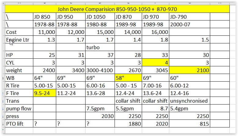

I am researching buying a JD950 and I cannot find any literature on the lift
capacity of a 950 3 Point hitch? I have read old threads and it was never really
answered. Lots of guesses, which is nice, but I am hoping for some hard numbers.
Has anyone seen any official JD published numbers?
This forum is great and I really appreciate the help?

I appreciate the reply. I am looking at the stats on various models that are available and I really want to know how they compare with each other.
JD publishes the rear lift at 24" for most models, but oddly, not for the 950 and 1050 which just happens to be the ones that I am really looking at.
I agree that 2000 lbs at 24" seems like a reasonable estimate, but....
The 790 which is a 30HP tractor only has 815 lbs of lift and the 870 which is a 28 HP tractor publishes a lift of 1880lbs.......I am thinking that there must be hard numbers that are published....somewhere.
I appreciate the help.

It is not so much as a particular implement that I am looking at.....as much as I am wanting to verify the ratings on various models so I really know for sure what I am buying.
Based on the numbers for the 870 vs 790....I really want to try to get hard numbers if they are available.
All the rear lift values that JD publishes (at this for this range of tractors) is at 24".....
I am actually building a spreadsheet that compares the various stats on the models I am looking at. It is far from done, and a work in progress, so please forgive the rough format and the way it looks at this stage....(also I tried to attach it in spreadsheet format and got an error so I took a screen shot of it)...
