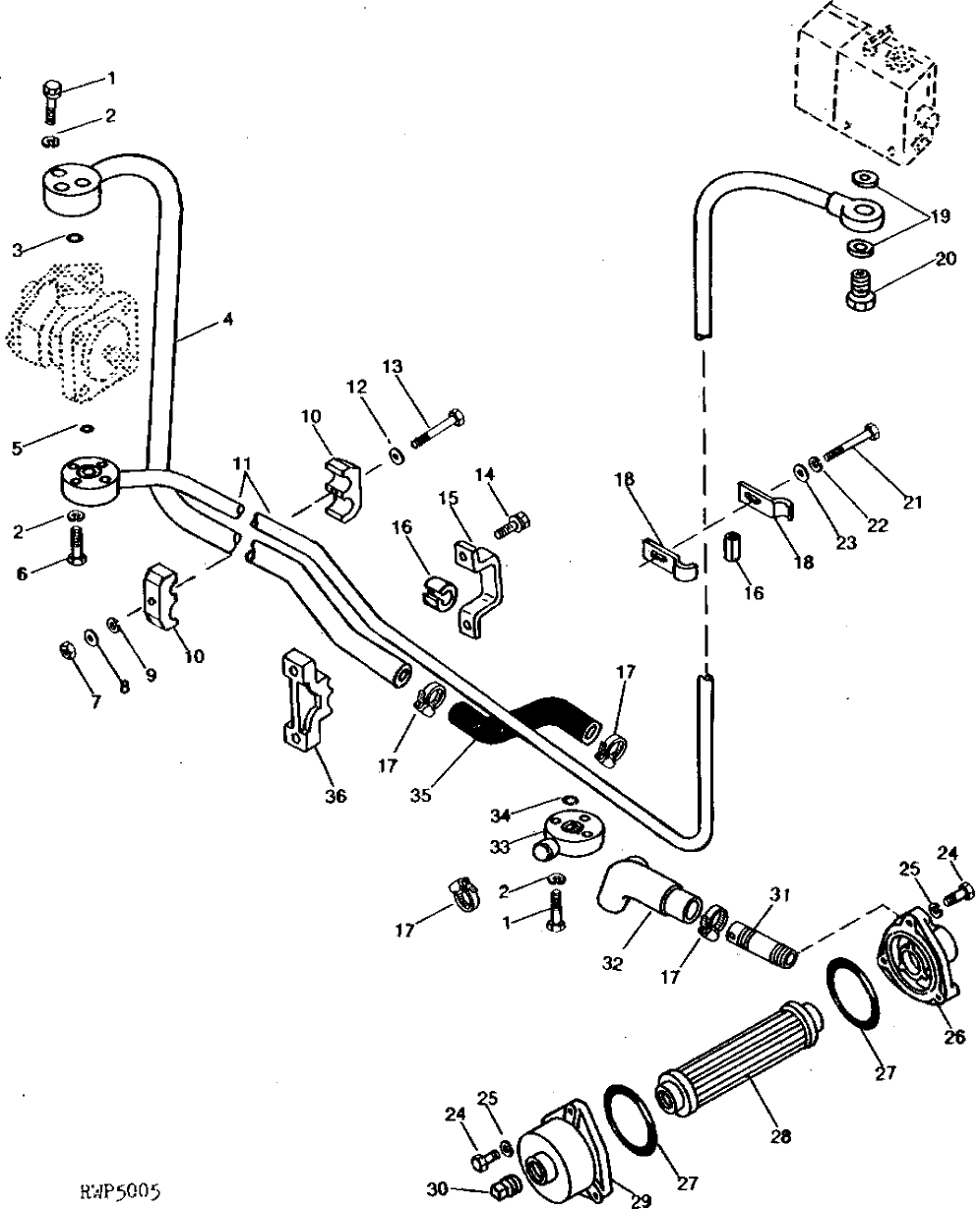

Just below the left side floor panel there is a cover with a port on it, I am assuming this is the filter. Pictures here:
and again:
Is this indeed the filter? If so, is the port on that cover a return point into the system or pressure?

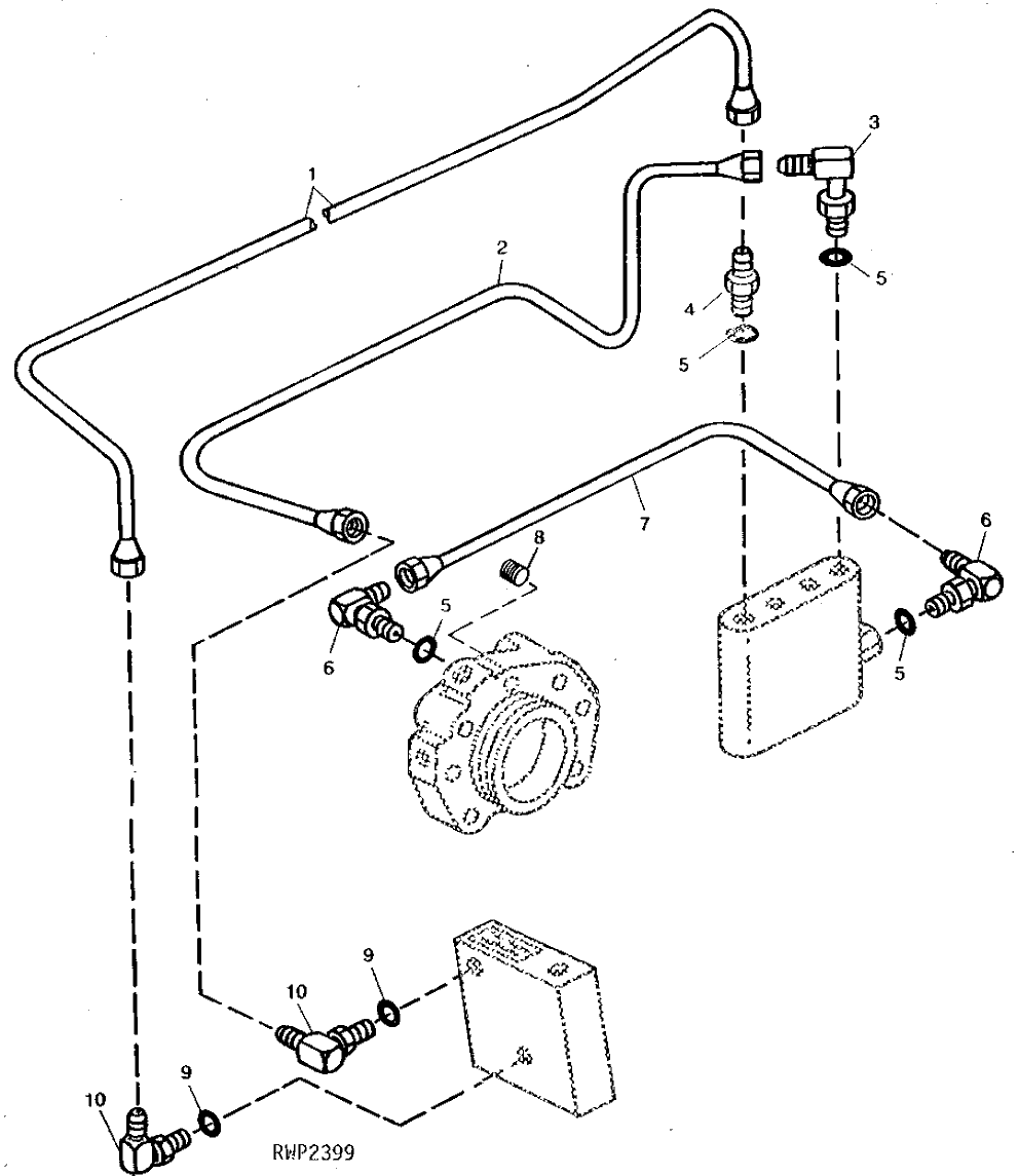

Also, I have some questions on the ports. Here is a picture of them:
The two lines just below the rock shaft rate of drop knob both go to the loader valve. Are these both pressure lines? If I went to a single joystick valve instead of the dual levers would that free one of these ports up? Also, is the nut that is just above these two ports(right next to the rockshaft rate of drop shaft) also a pressure port? And please correct me if I am wrong, but the line going down to the port next to the final drive is the return right?

The first and second picture show the "strainer", a steel mesh thing that can be cleaned and re-used (see first diagram below)
There should be three lines connected to the valve body (again see second diagram):
#1 is the pressure line FROM the pump TO the valve
#2 is the low pressure return FROM the valve to the sump
#7 is the Power Beyond line FROM the valve that feeds the 3PH
Changing to a joystick valve will not help, you still need all three lines to feed it.
All these diagrams are from www.jdparts.com and are free...do yourself a favor and register there-just remember to "think like a parts guy" since this is the same basic system the dealers use at the parts counter.
