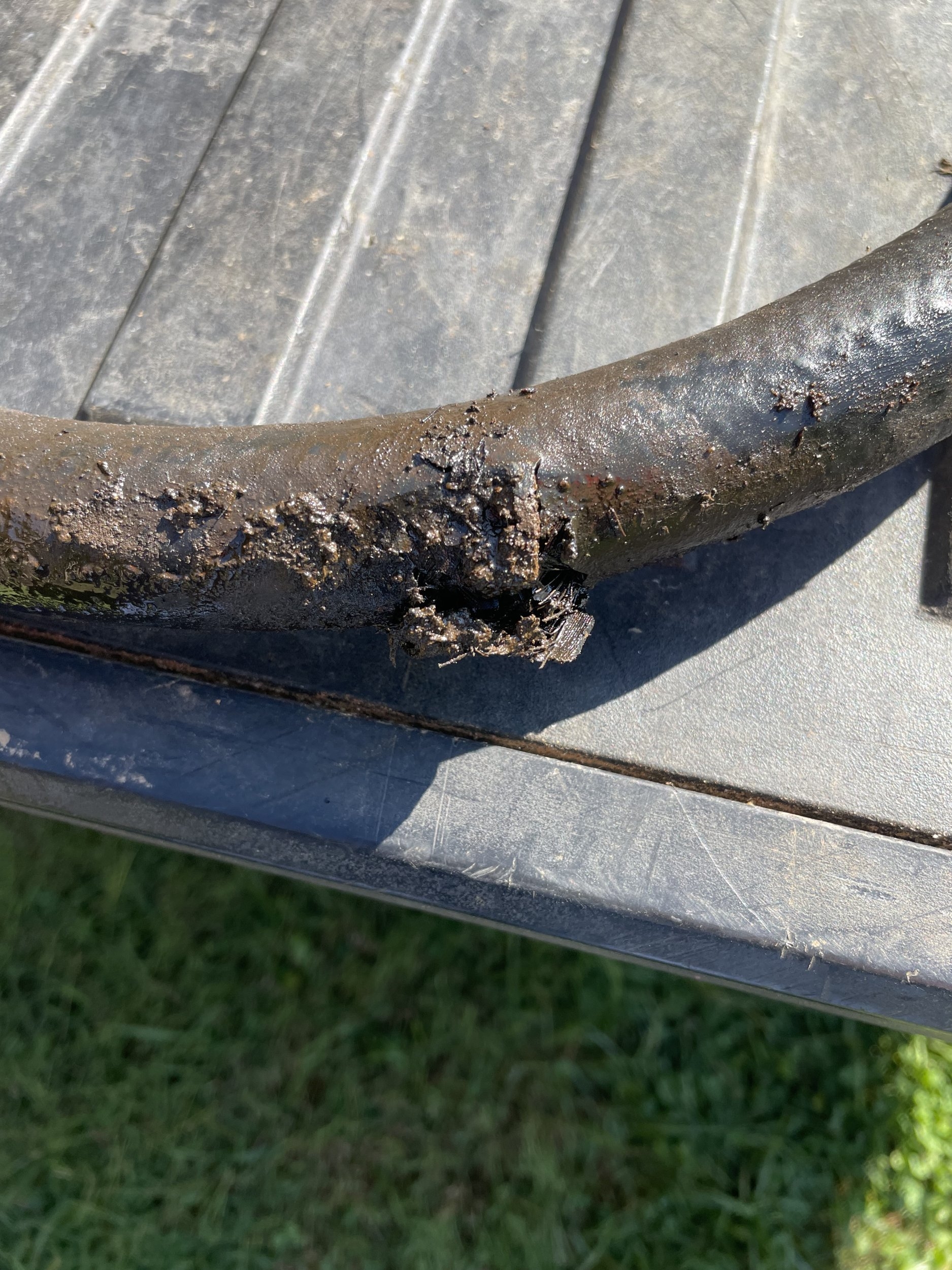

Found the leak. Left drive motor hyd hose. It was in a 90 degree bend and pressed against the belly pan. I couldn’t get my hand under it when I was feeling for a rupture. Not an easy fix but in the grand scheme of things it could have been worse.

Good call. After starting it for a few seconds I could hear the leak due to the air in the lines. I popped the cab up and was able to see oil running down the pan. The hose busted on bottom side where it was pressed against the pan. I had a torn a tendon on my right middle finger which was splinted and wrapped so I was operating one handed and just missed it on my earlier attempts.

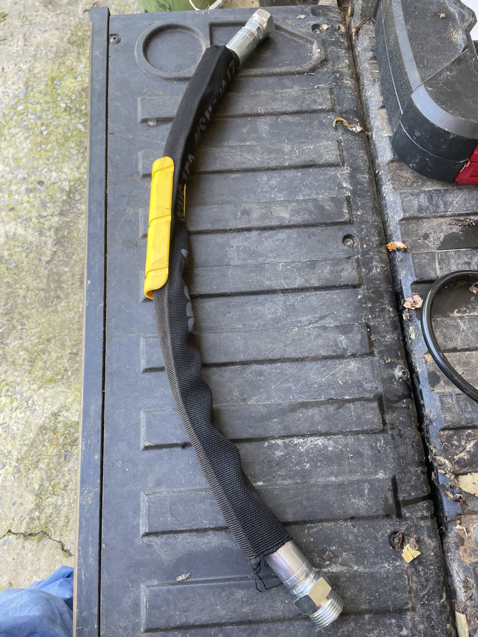

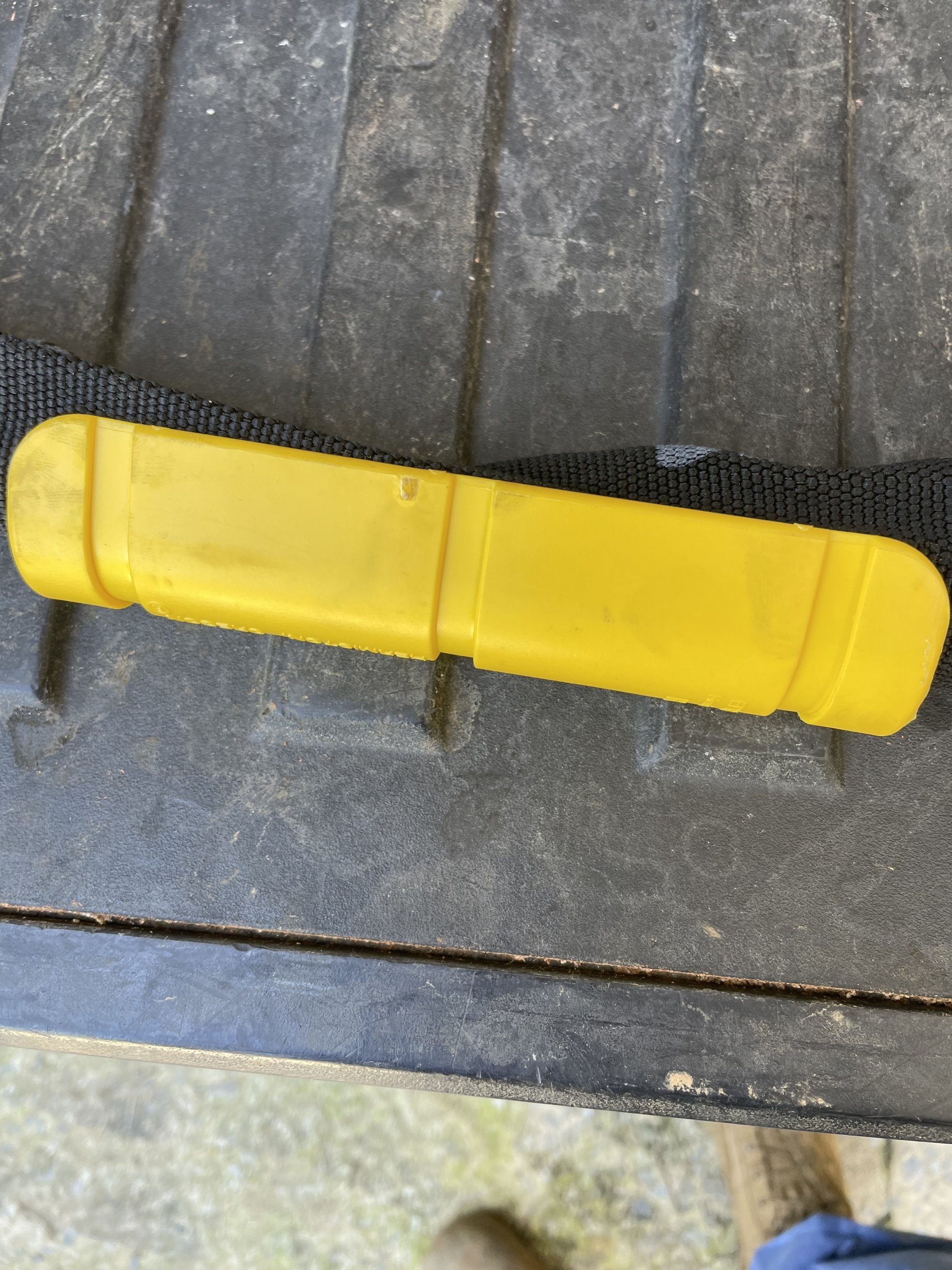

Thought I would share this. Got the hose off this morning. No problem actually. Had a new hose made up locally. I told the folks there what my problem was around the hose bearing against the steel floor pan. They sold me some neat hose guards to try. The hose was also showing signs of wear where it lays between the two other hoses that run to the drive motor. We put a sleeve on it to help that. I have attached pics of old hose and new hardware.
