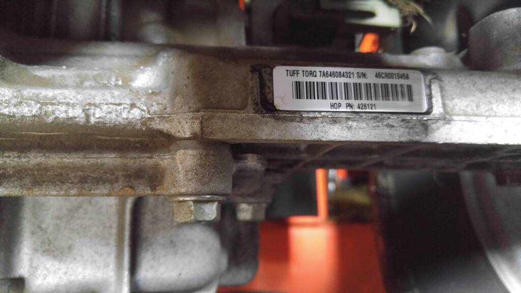

On the back of the transaxle, there will be a sticker with serial number. Looks like this pic. After 46 is 2 digits, mine is a CR. There are a bunch of K46 variations. Go to tuff torq website and look up your model. You can purchase parts, or whole new transaxle from them. A new k46cr is $1k.
My axle broke on mine. A new axle kit is $180. I will be repairing it this week. Mine is 10 yrs old. 0530181759.jpeg

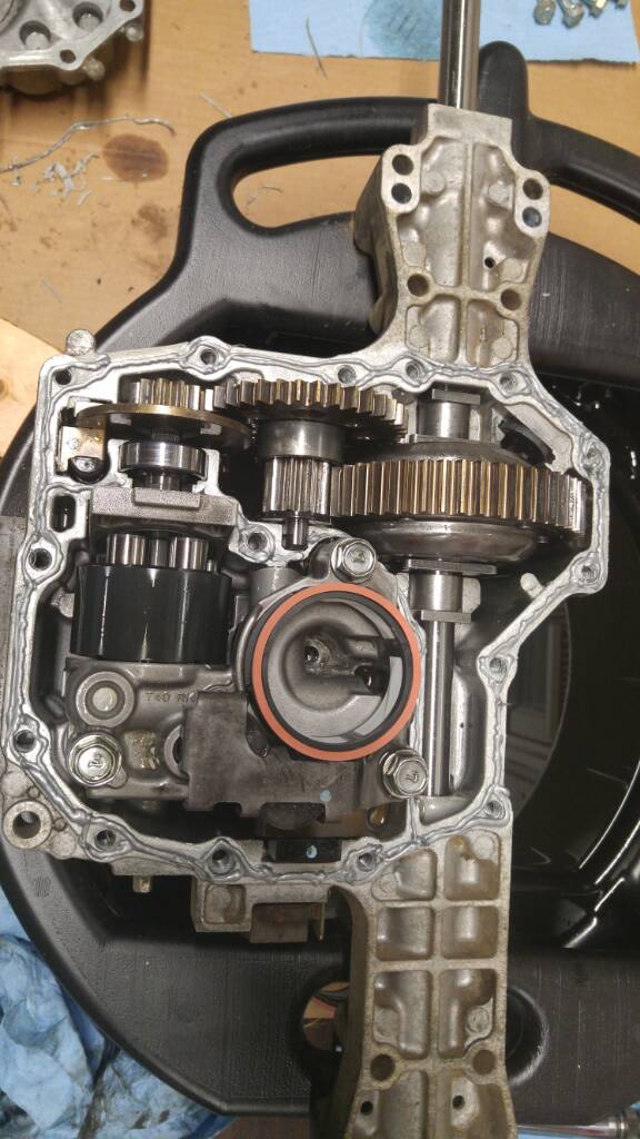

That's real early for a failure, even with this transmission. I'd look for a broken part, axle, stripped drive pulley, even low oil in the unit. Fairly simple to remove and take off the top, look it over, might spot the issue. I would not recommend a Tuff Torq replacement of any type, or a new mower with this brand trans. With the gear train and hydraulic unit running in the same oil, and those gears made from pressed metal, the life span of those hydros is very limited. I put a Peerless trans in my L130, not real satisfied with it (noisy) but it does work well.
