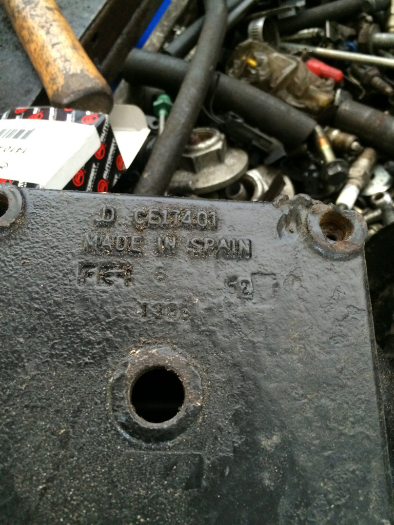

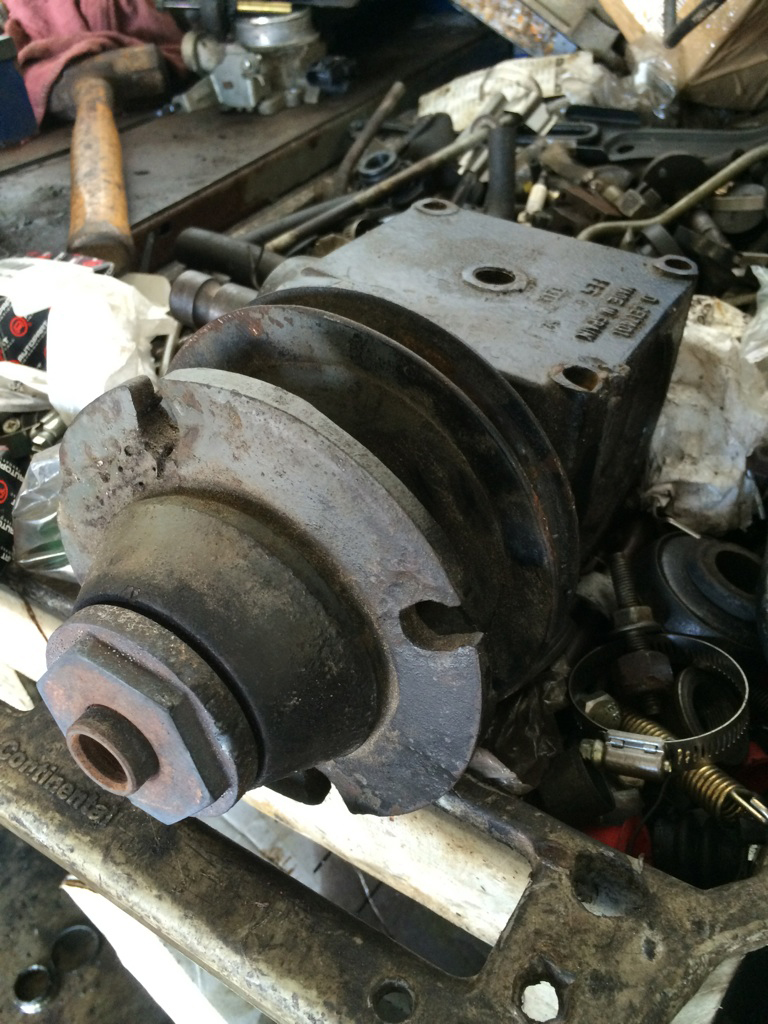

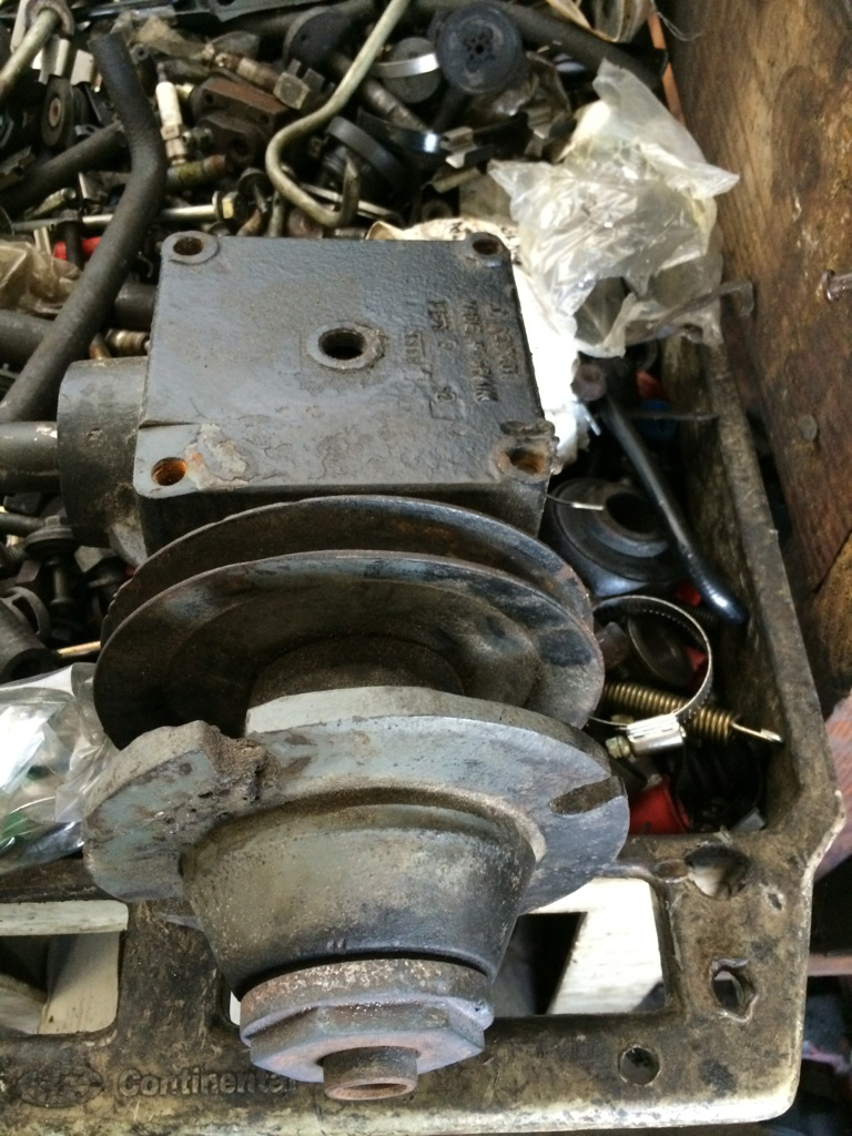

   / JD F1145 Front Mower w/ 72" deck - Gearbox Disassembly Information
I am trying to remove the hub (2nd and 3rd picture) from the output shaft. A blade also bolts to the end of the output shaft. I have tried heat and a big wrench with no luck. Is the hub threaded or pressed on?
Thanks,
Brian
   / JD F1145 Front Mower w/ 72" deck - Gearbox Disassembly Information #9
View attachment 386137View attachment 386138View attachment 386139
Thanks,
Brian
The pulley #20 in the picture just rusted out on my f1145 and belt came off. Had to remove that 2 inch nut to get to the pulley. I followed the manual and gripped input shaft in vice with copper jaws and used 18 volt Milwaukee impact wrench and nut came off easily. Used a 3 jaw puller to pull hub off and one of the bearing fell apart. Ordered new pulley, bearings and seals. I believe my gear box was okay so didn't take it apart but will change gear lube while its
off the mower. Thread was right hand.
Mark
