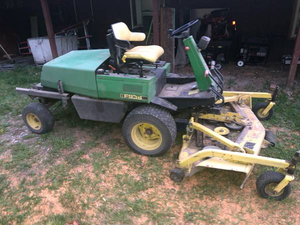

Hi,
I am looking at an older JD f935 diesel mower with a 6'deck (they say). Seller doesn't know what year it is, has had it a long time. He has changed the oil, filters, annually, not much else. I don't really need a deck that big, and I want to haul a utility cart with tools, field rock, compost, etc. My Kioti is just too big for this job. He is asking $2,300. Seems high, but there is very little for sale used around here, mostly box store junk. I looked at a new Husqvarna GT with a 20h Kawasaki for $3,600 at the dealer. It is cheaply made, lots of plastic, just was not impressed. Probably a good machine compared to other new equipment.
I will be mowing rough areas, need to be able to set the deck high. Seller has no clue about how high it goes. I would actually like to put a smaller deck on it, sell the big one. Anyone know how many blades this has or how high it can be set?
The engine is a Yanmar, 3TKA72OJ.
Any feedback on this is appreciated! I am going to look at it tomorrow evening.

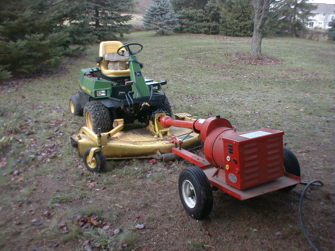

I bought a gearbox that mounts on the mower deck that gives me a standard 540 pto stub shaft. From this I run a pto generator when the lights go out or I need 120/240 out in the field (as in welder).

You price is pretty good. A 'newer' one around here can go for twice your price.PIC00015.JPG

I found the full ad for this machine on your local Craigslist. Wizz-bang seat, aftermarket front tires, and the support frame for the Material Collection System. No deck covers (I recommend getting them (ebay) to keep the belt from getting frayed by trash. The deck is SHAFT drive. Hydraulically raised. The deck lift valve has a float position so it will ride with the terrain. It will have a foot operated, electric differential lock on it, too.
I put a trailer hitch ball on mine. (There is a bracket for it on the steering cylinder guard). I see 2 handles for the hydraulic circuits there, too. No ROPS bar. PITA around low hanging trees.
