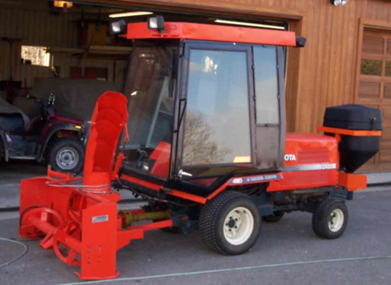

I have the Kubota equivalent and I am totally satisfied with it. The one I bought had been owned by a small town for several years. I am the second owner. The hour meter was broken at about 4500 hours, so who knows how many hours are on it. Several sources told me to expect to get at least 8000 hours from the engine. The only maintenance I have had to do is replace the alternator and fix a connection in the wiring harness. I paid the equivalent of about $US6500 for the tractor, a 60" side discharge mower deck, a 50" snowblower, a 50" dozer blade and a full metal cab. I just converted a 3ph tiller to a front mount to work on the tractor and will likely pick up a rotary broom in the near future. My main uses are cutting grass and blowing snow. I previously had a Snapper 1855 and I am much happier with the F2400. There are times when I wish I had a FEL but I wouldn't trade for a CUT. This is a perfect outfit for my property.
I have heard conflicting stories about the Yanmar engines in the JD F935. Some say they only last about 3000 hours while others say they last up to 5000 hours.

Cool looking cab! /forums/images/graemlins/wink.gif I bet that makes snow blowing so much more tolerable. Nice rig you have there.
