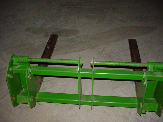

Does anyone know how I can convert these JD forks from a 950/1050 loader attach style to a JD 4300 with 430 Loader quick attach style?
   / JD Forks
#2
Here is another shot of the connection.
   / JD Forks #3
just build a bracket that mimics the 4310 loader that attaches with two pins thru existing holes unless the cylinder spacing is different then you need to bridge the fork brackets with an adapting plate with q/a copies or sell it to me cheap and I'll make it fit my loader.
   / JD Forks #4
Do you have a welder?
Looks like you just need a plate on each side to bridge the existing mounts, then weld on the hook and pins.
You can but the hooks and pins from JD for about $35.00, its much easier than making your own.
