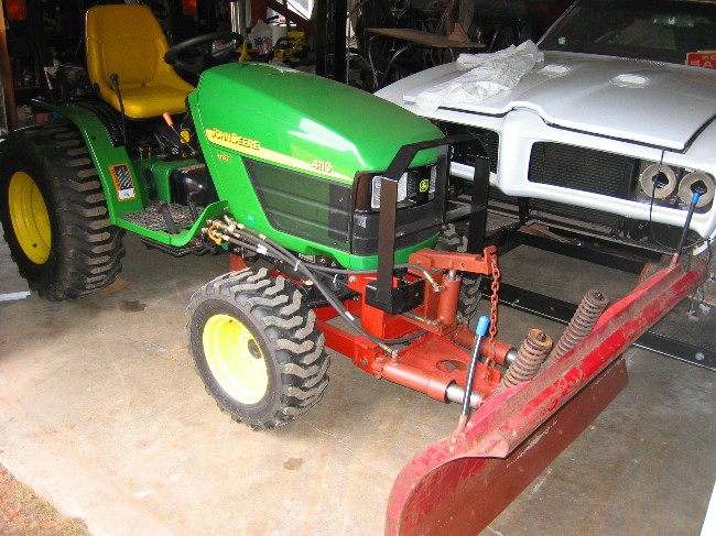

I bought a used 5' Western hydroturn blade with lift and angle cylinders for $100.00. The plow was used very little, wear blade looks perfect. I built a subframe out of 1 1/2" x 3" steel tube. I rebuilt the turn cylinders with $16.00 in O rings. At an extreme angle it covers the tractor tires by a couple inches. I felt the 54" blades were too narrow. Incidently the 4110 has a 561# weight box. It plowed 2' snow drifts with no problem. It almost makes plowing too fast !!! I bought a set of chains but haven't mounted them.
Very cool front blade...nice job:D
