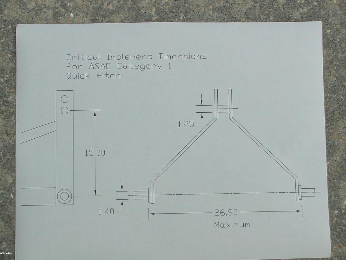

What other brands of attachments are compatable with the JD iMatch 3pt hitch system? Can any iMatch owners supply me with the pin width and lower pin to top link pin measurements? I'm about to order a JD 2520, but I'm not sure if I want/need the iMatch. Thanks.

You will like the iMatch, IMO.
There were and are a lot of attachments that don't 'mate' with the ASAE standard, but more and more are doing so. I just alter the ones that don't (which has only been 2 out of 6 that I needed to do anything) and I'm good to go.
The standard specs are attached:
