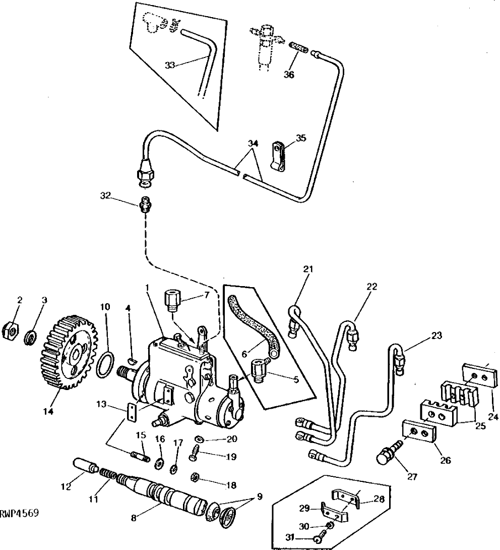

I went over to the widow's place and replaced the fuel filters on her old JD diesel (4 cyl direct injection). Checked the air filter. Looks as though somone put a new one in.
Started right up. Decided to run the bush hog for a little bit to check it out. After about 5-10 minutes running, it wouldn't go above idle. Had to creep it back up near the house in 1st or 2nd gear.
I'm betting the valves are too tight. The clearances aren't there. After the valves warm up, they don't seal good and yield low compression.

It could be tight valves, but it might also be starving for fuel.
   / JD lost power after warming up good. #3
Its hard to give a definite answer without the model number, but I doubt that the valve clearance is the problem. It sounds as if the injection pump may be the problem. There is a rubber ring inside the pump that deteriorates over time that clogs the fuel return circuit between the pump and the tank. I am guessing you have a Roosa Master pump. On the side of the pump facing the outside should be a rectangular plate secured with two small screws. That is the timing window. remove that plate and if you see black particles in there similar to coffee grounds, the pump will need to be rebuilt. If you run it long enough to loose power again, loosen those two screws while it is running to let out fuel pressure and it will probably speed back up again. Let me know if you need any more advice and get the model number.

The injection pump problem doesn't really have anything to do with engine temperature, but usually a certain amount of time of running. If you shut it down for a couple of minutes it will probably rev up for a short time until the pressure builds up in the pump housing again. There were two versions of the pump on these tractors.The earlier version was a smaller pump that did not have the problem I am talking about. The later ones with the larger pump did have this possibility. The 820 three cylinder was built from 1968-1973. There was also a 2 cylinder 820 model that was built from 1956-1958. Something else you may want to check is the flow of fuel from the tank. A restricted fuel line or filter could give similar symptoms. I am attempting to post a link that shows the pump I am refering to. The timing window plate is item #13.
   / JD lost power after warming up good. #7
I'll try the link again. Sorry if it doesn't work.

I went over this afternoon and fired up the JD 820. It didn't take it but 2 or 3 minutes before it slowed down this time. Never really got fully warmed up. Shut it off for 2 minutes. Started back up fine and revved up for a minute or so. So, I think it definitely points toward an injector problem as it follows the symptoms mentioned.
Will call the local JD dealer for an estimate for them to replace the injector and the cost of a rebuilt or new injector. There's a mechanic who has been doing work for her. He might have the knowhow or might have done one of these before. I COULD do it IF I could get the timing requirements, etc.
