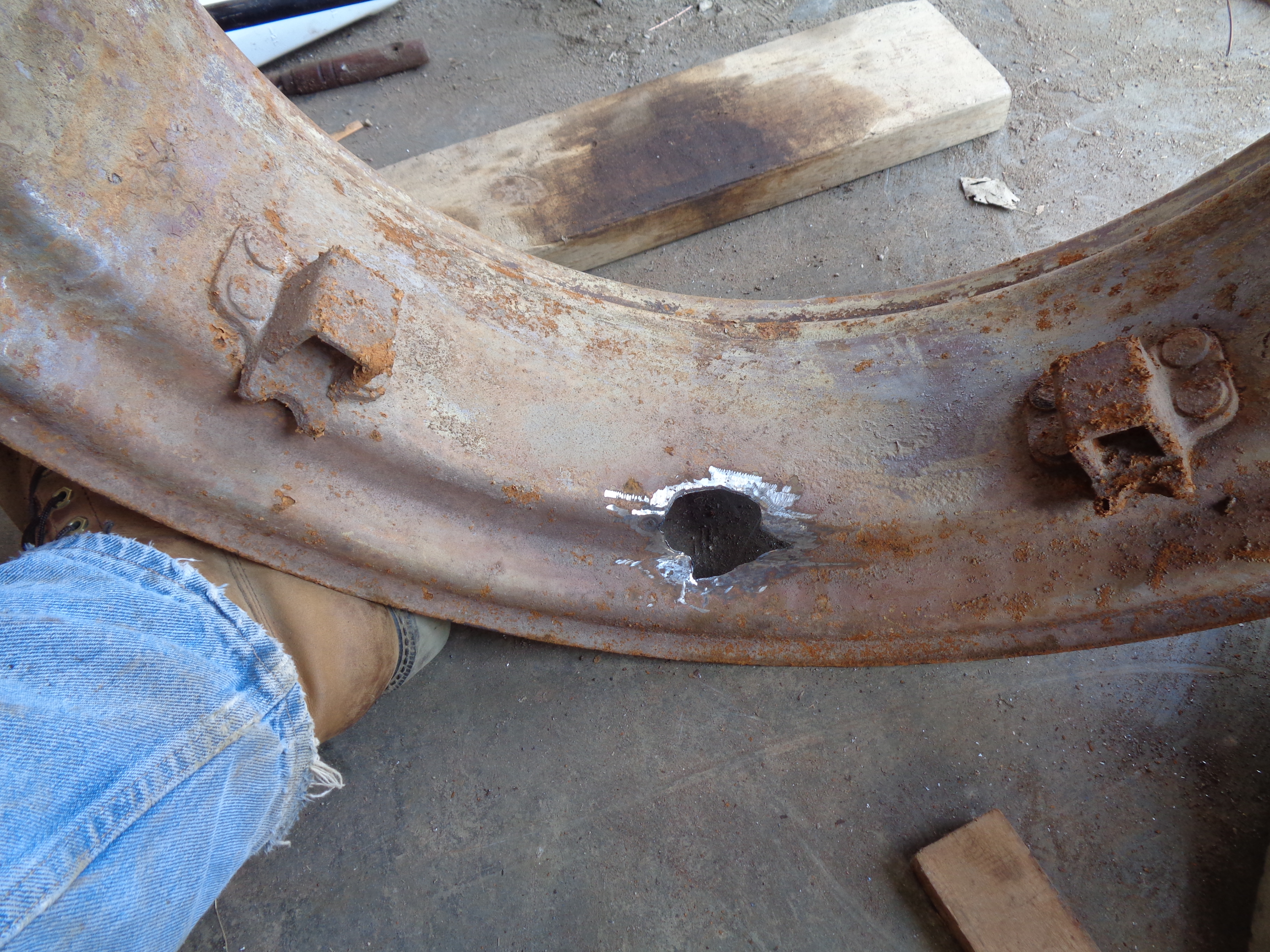

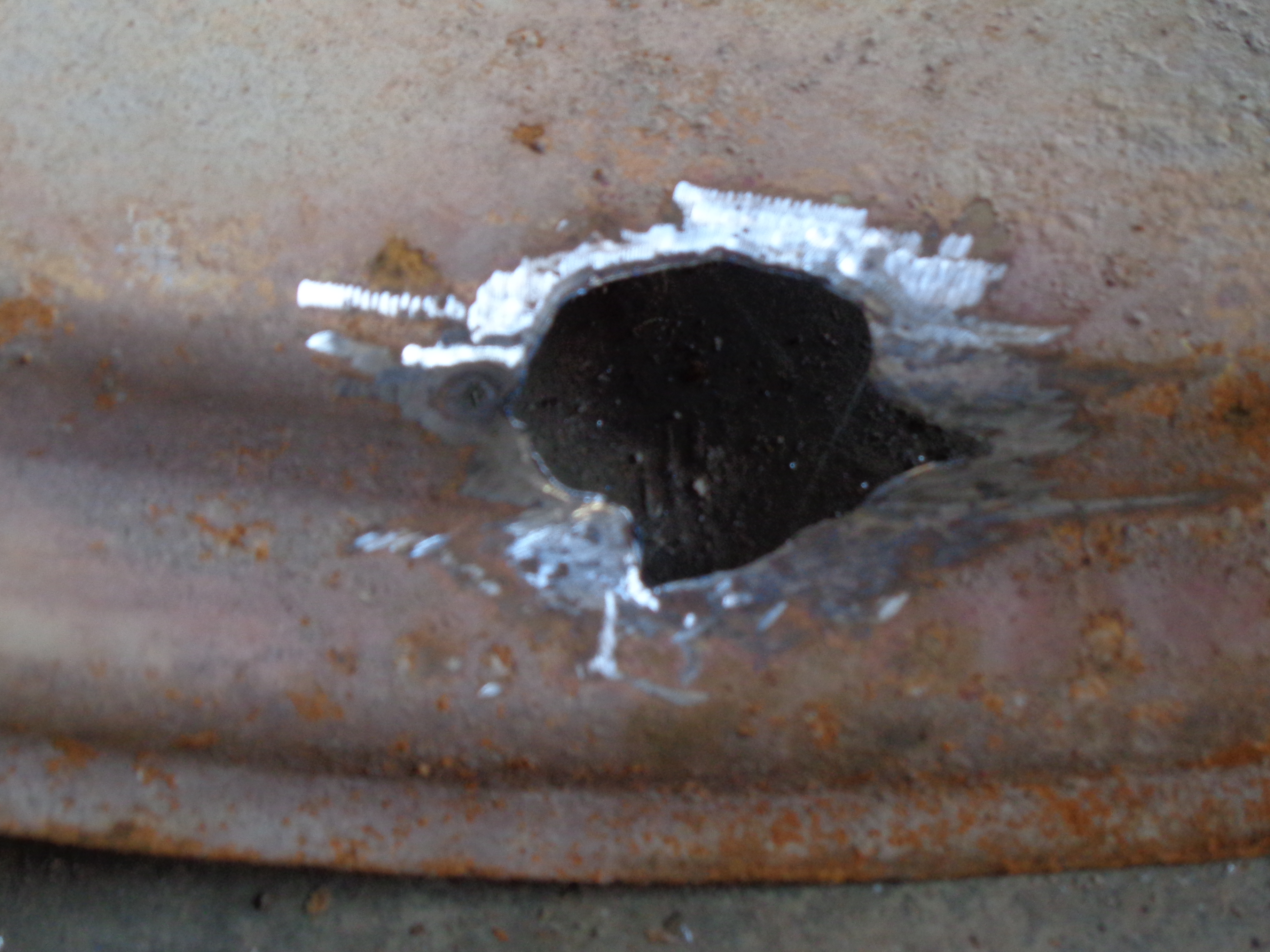

One is perfectly fine and the other, I can only assume set for a long time on a flat tire with calcium chloride inside the rim. Which has caused a rust spot completely through the valve stem area and all along the outer rim.

Depending on how far away from that hole they are damaged, as in, between where the rim attaches/spot welded to the pressed steel center, a decent welder could section you in a piece of good rim of the same size fairly easy, you just need to drill a new hole, for the valve stem to come through. It still can be done, if beyond where they attach, it will just take more work, and a maybe a better used rim. If more than that, buy a new blank, open center rim to match, cut the old one off, and weld anew rim onto the pressed steel center.

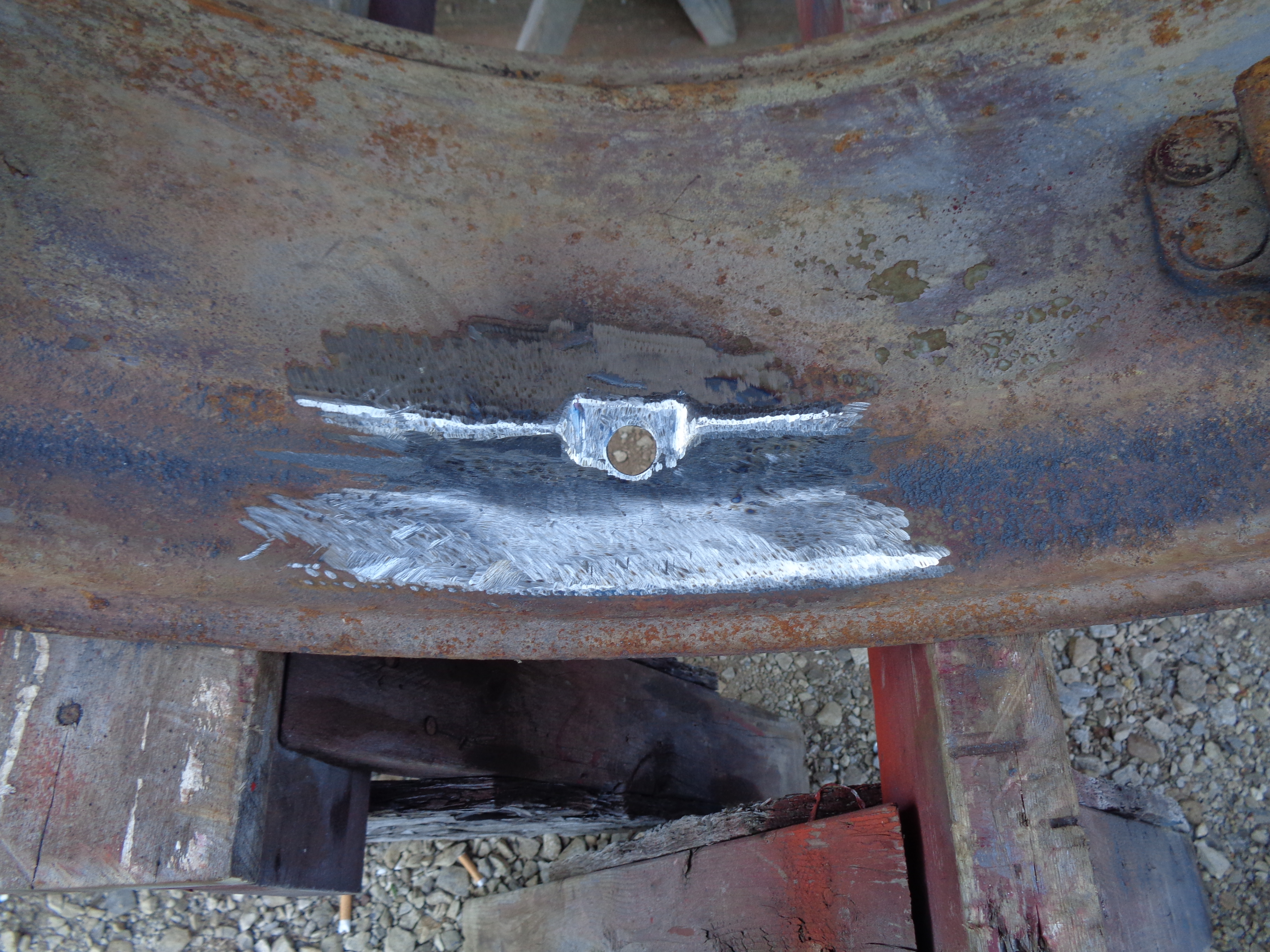

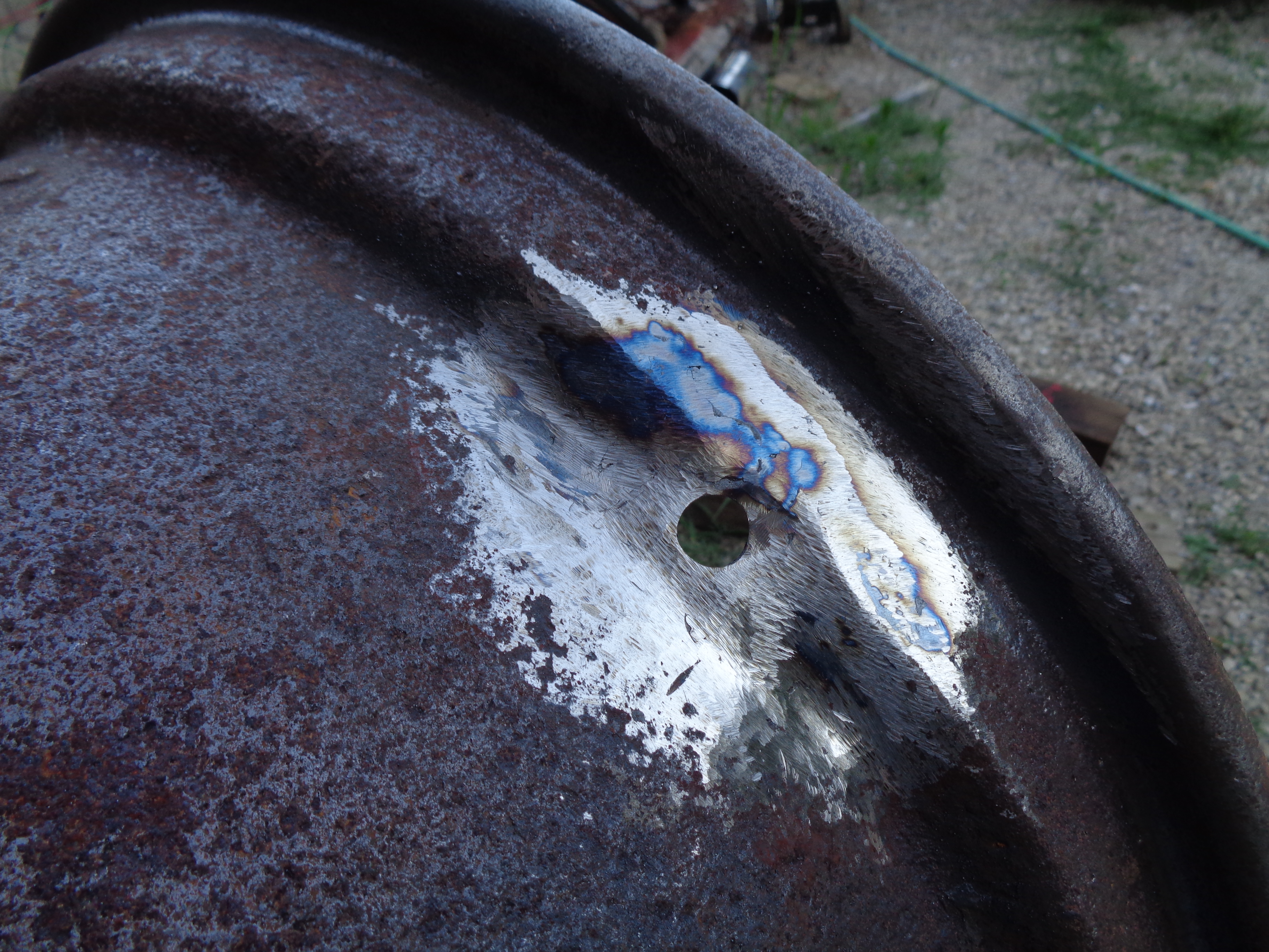

If it's a smaller area, just around the valve stem area, it can be repaired with multiple passes with a decent 110V mig welder, doing multiple passes, and grind off excess to get the desired repair. This is one I did on my Farmall 140 this Spring. Far from perfect on the outside, but good enough for who it is for. I made multiple passes, until I could fit apiece of 1/8" thick X 1" wide flat strap, and weld it in place for the flat spot in the rim for the valve stem to come through. I probably had 6 hours involved in this, welding, cooling, grinding, etc. etc. But, after pricing a new rim, and wasn't exactly oem style, I figured I had more time, than money. A good rainy day job in the shop. I figured less than $20 in consumables, between wire, gas, and wear on a grinding stone. A LOT less than a new rim..!!

I repaired a rim similar to the above example. Only I never built the area up I just cut a nice square hole and cut and bent a piece to fit into what I had cut out.
