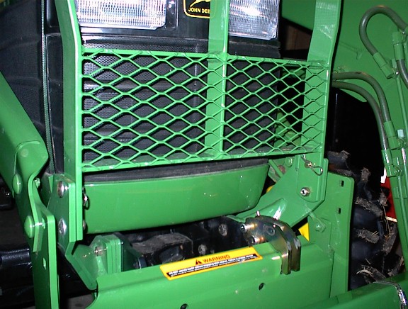

/ JD tractor armor #10
..........hood and grill guard...........

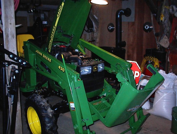

MarkinMN, thanks re photos. Now I understand about the big tires and hydraulic coupling. What about accessing engine compartment?
/ JD tractor armor #12
Hey Ray, Getting access to engine compartment is a snap! The hood/brush guard, is mounted by 4 pins in front. To open it, just remove the top 2 pins (pull the hitch-pin clips first) and lift and swing, forward the guard up,over and down and let it rest on the loader horizontal member the bottom pins act as hinges.................hope this helps...........mark
/ JD tractor armor #13
.........................and "TA DAA"........................
