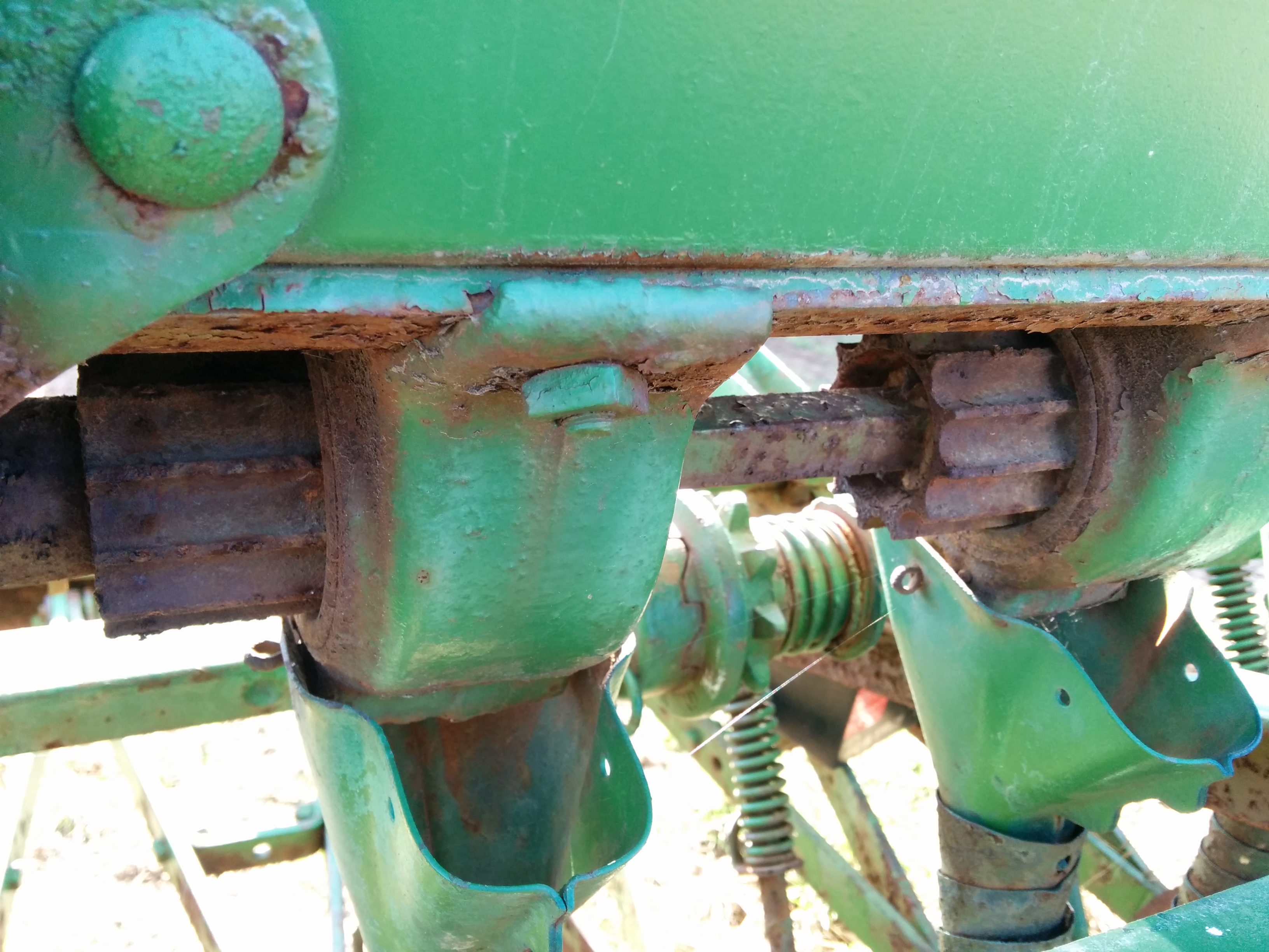

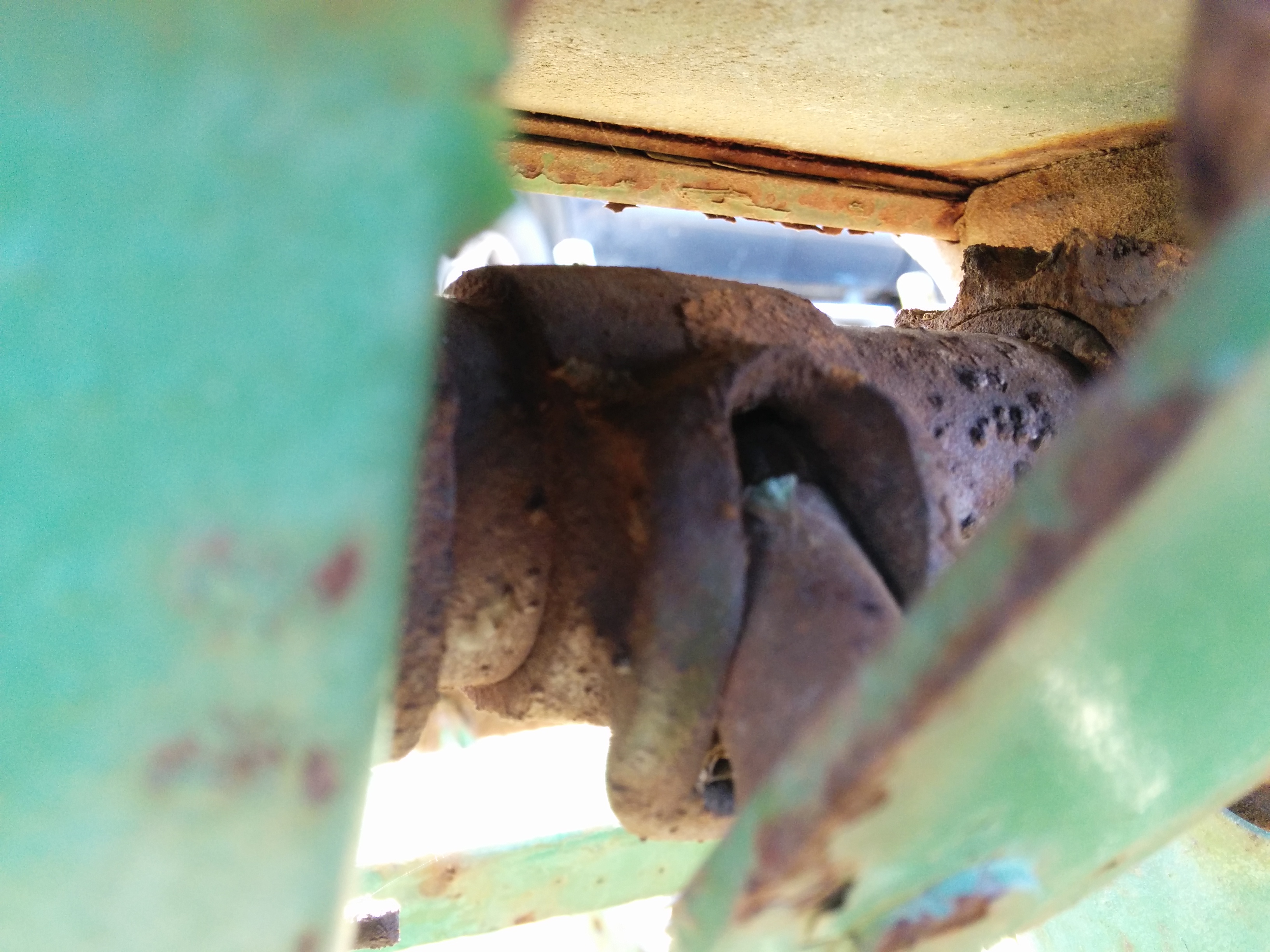

I traded for this John Deere Van Brunt Model B grain drill.

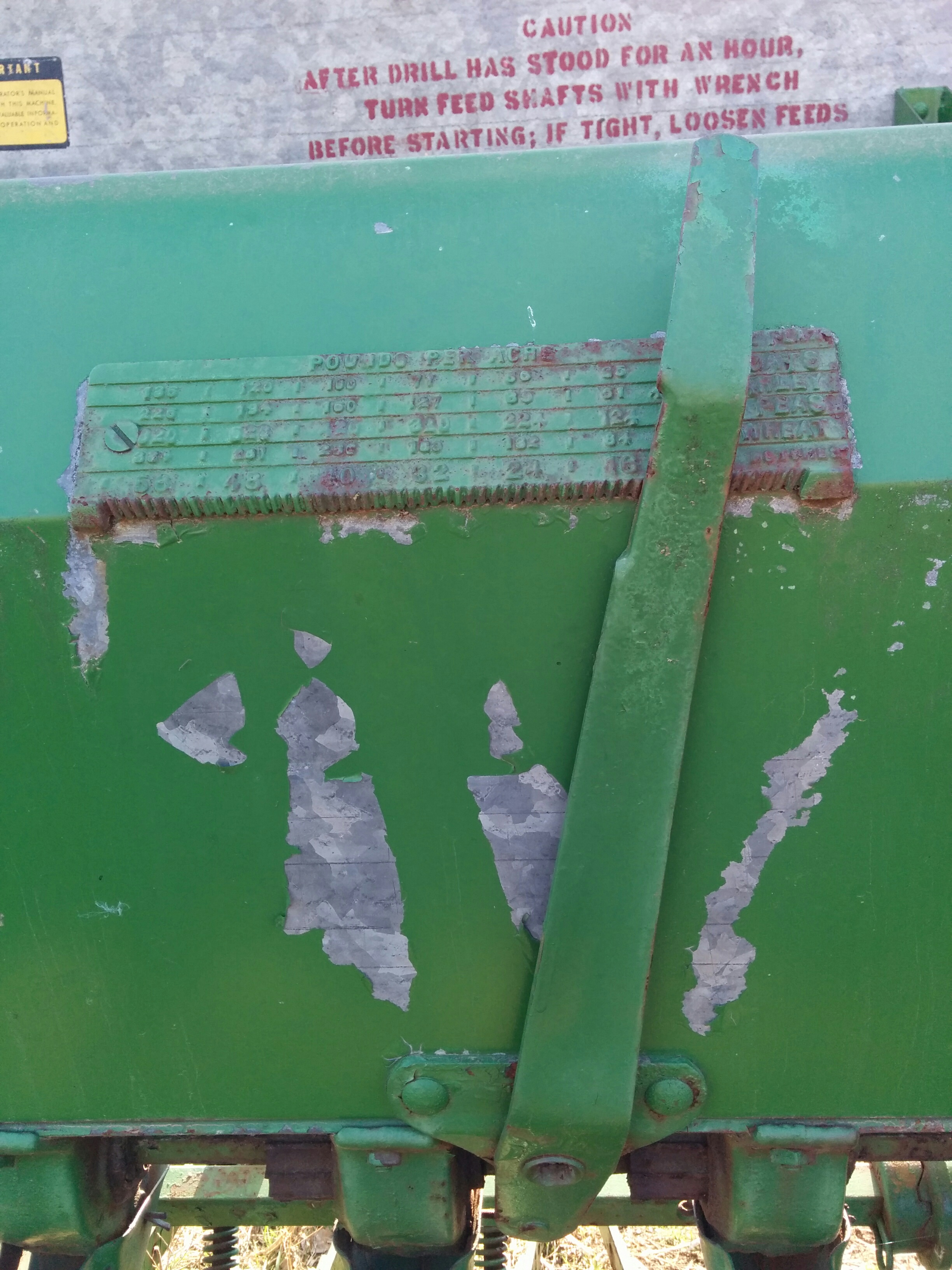

It looks like it is in OK shape and I want to plant some soybeans this year. I cannot get the seed rate adjustment levers to move... They are rusted in place.
I assume them lever goes left or right and the whole rod assembly moves and restricts or opens the hole to allow less or more grain through. Is that right?
How can I get them loose? I though of penetrating oil where they'd move. Also, more aggressively, maybe pouring used motor oil in seed hopper and letting that run down.... but not sure.
So, thoughts and suggestions would be helpful. I don't want to break anything. Thanks!

YES. Saturate with a lot of penetrating oil then you may have to resort to heat to loosen the feed cups.

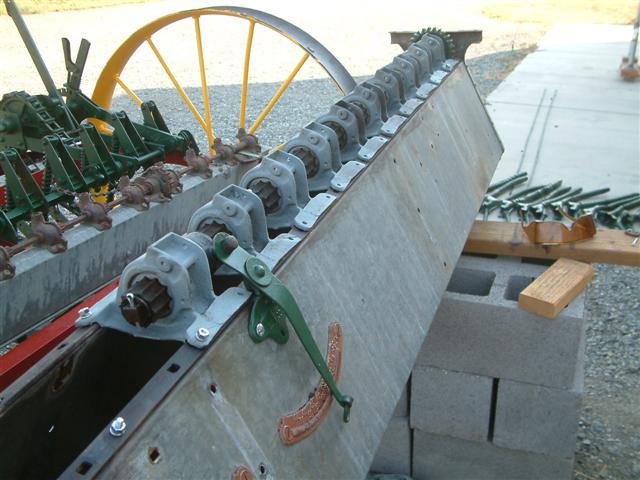

I'd jack up the drill and spray those rusted seed cup parts with diesel. Then grab the wheels and work them back and forth by hand to loosen the parts that are rusted together. If you're lucky, this will solve the problem. Otherwise you'll have to start disassembly.
You don't want to use penetrating oil or motor oil because it will be a real job to clean up the residue so the seed doesn't clog the feed cups.
Spray the rotating parts with diesel after each use to keep the rust from returning.

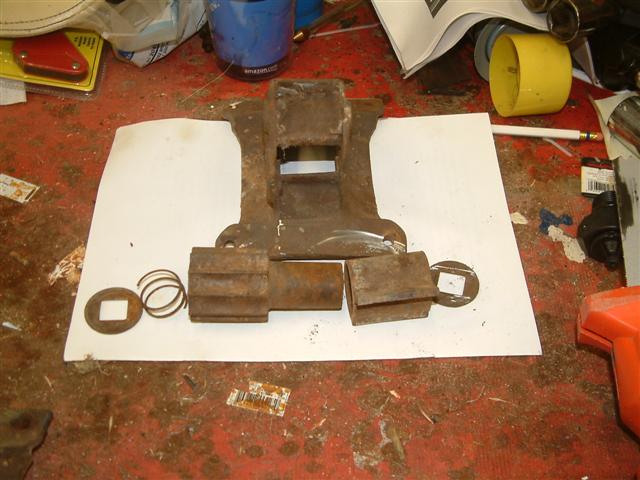

I rebuilt two old Minneapolis Moline P3-6 grain drills (10 ft wide, 20 drops, single disc openers) that had the same rust problem as your JD. I had to disassemble those drills completely, clean the rust off the parts, and then spray the parts with galvanized coating before reassembly.
