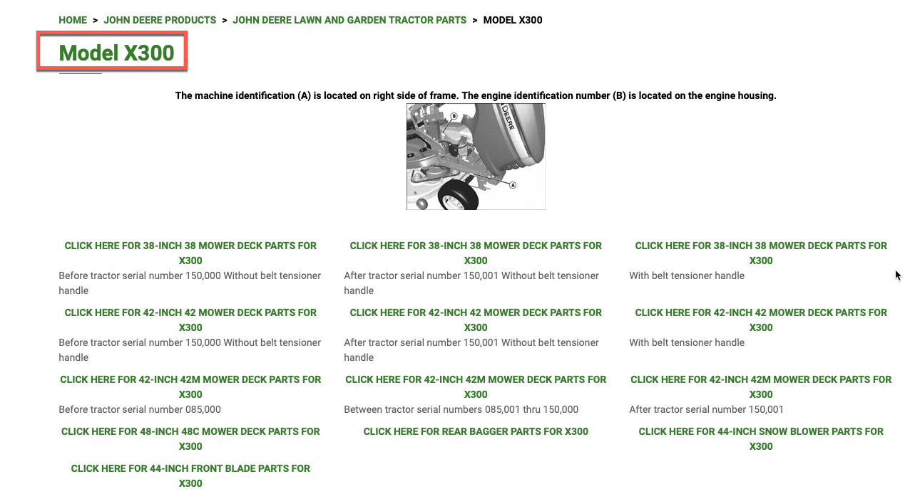

I'm having problems with replacing my mower deck belt on a JD X300. The original broke. I measured it and it measures 141". All the replacements I find are 146". I've tried one of them but it twisted and hopped off. I suspect the extra length was part of problem. Googling I see lots of problems/bad reviews with replacing this belt. I'd like to start over with the proper length.

Before you go further, Deere has a fix for this that works. Ask about 42C deck belt failure Solution 116525. This assumes that you have the deck w/ belt # M154621 which is slightly more that 146". I've not seen a 141" deck belt.

Unfortunately, you did not include which deck you have. According to this site, Click Here, the X300 could have a 38 inch deck or a 42 inch deck. Note that you also ned to know your serial number in order to buy the correct belt. I buy almost all the parts I need for my X310 from these folks. Always a great experience.

sorry, it is a 42" deck. i didn't know that there was something smaller. I see with and w/o tension handle. I don't think I have a tension handle just that bracket in the middle with the spring on it. It has a hole for a 3/8 square drive. I'm going to look around in yard again to see if somehow part of that belt broke off in the middle leaving me with only 141" since I see no references to a belt that short in any belt specs.

I clicked on each of the 42 inch links, there are only 6 of them.
M154621 146.244" This is the belt for the 42" deck on my X310.
M153160 156.614"
M172924 66.062"
M138583 115.000" (secondary drive belt)
