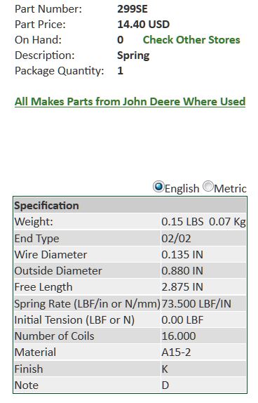

Before you try to bale any more bales be sure that the plunger head stop is free to operate correctly and that it's spring is in good condition. Here's the spec's on the hay dog springs.

Thanks Tx Jim. I forgot to mention that the guy I bought it from had been running it while he was working on getting it to tie. He demonstrated it before I bought it. He said he came up on a faster sq. baler cheap that already worked so he bought it. He hadn't tried long to get this one working, or so he said.
One thing I saw right off was that he was running round baler sized twine through it. He also has replaced a couple long springs with 2 shorter ones to try to take the place of the original longer springs. One place he did that was the pickup idler and the other place was the plungerhead safty stop. They seem to be strong enough but I still feel like they should be replaced with a single spring each. What do you think?
Thanks for the heads up on checking that spring. I was wondering if I can't get a spring already cut to the appropriate length, can I buy longer ones and cut them to the correct length? Or, would I be better off just breaking down and paying John Deere for their high dollar ones?
Thanks again.

Only way I know to swap forums is for a forum moderator to change it. I think this forum is fine. As long as the springs have enough length & tension that's fine they don't necessarily have to be GREEN.
