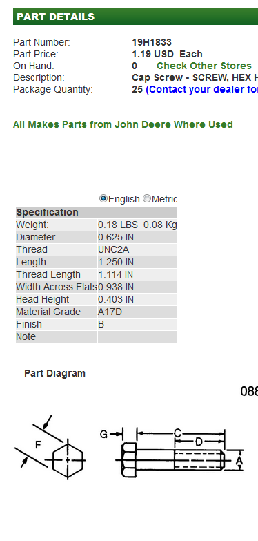

BTW what thread is that bolt #11 so I can have one ready?
   / JD2020 power steering leak #5
Here's the capscrew(key 11) spec's.
Thanks, 5/8 UNC, is there a web link to those JD 'part details' so I can look things up on my own?

   / JD2020 power steering leak #7
To look up spec's on JDparts.com website one must register with a JD dealer on website. Then parts are put in shopping cart then one can right click on part number entered in shopping cart to reveal the JD part spec's. Most but not all parts spec's are available. HTH's,Jim
