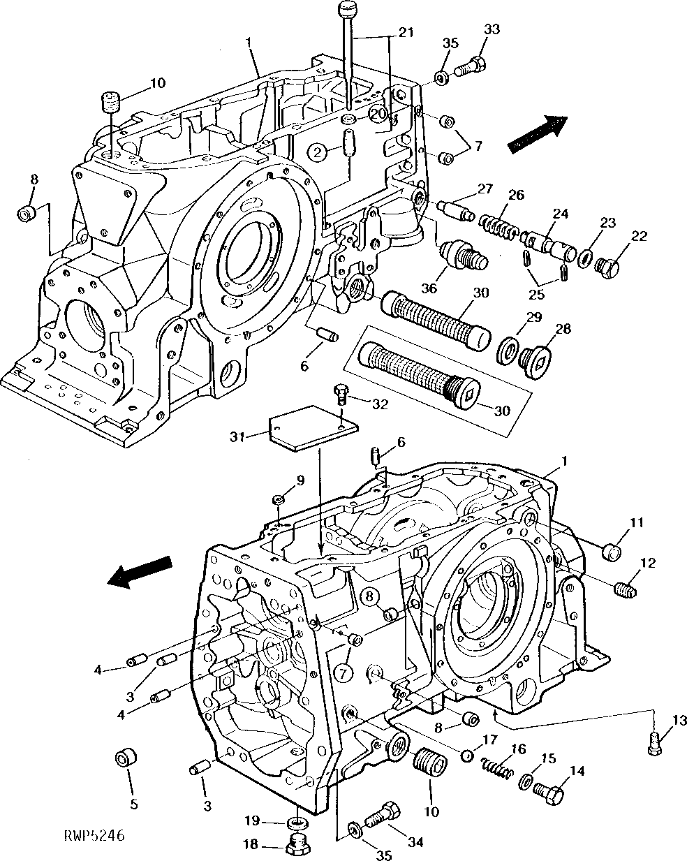

Did you check/clean sump screen(parts key #30)? Does tractor have hyd in pto &/or hyd hi-lo or reverser? If so have you tried using hyd's with pto on & off and in high & low? I'd suggest to check hyd stand-by pressure which should be 2250 psi. How is loader controlled(ind valve or scv)??

How long since hyd filter was changed & sump screen(parts key 15) was checked/cleaned? With 3 pt raised engine running look inside hyd filler hole for spraying oil. Remove FEL control valve return hose,with FEL control valve in neutral crank engine and no oil should exit open hose. Does your tractor have hyd hi-lo or hyd ind pto?

Technically a JD closed hyd system shouldn't have a PB hose. I just remembered that hyd filter relief valve(parts key 24-27) in photo I posted could be stuck open.

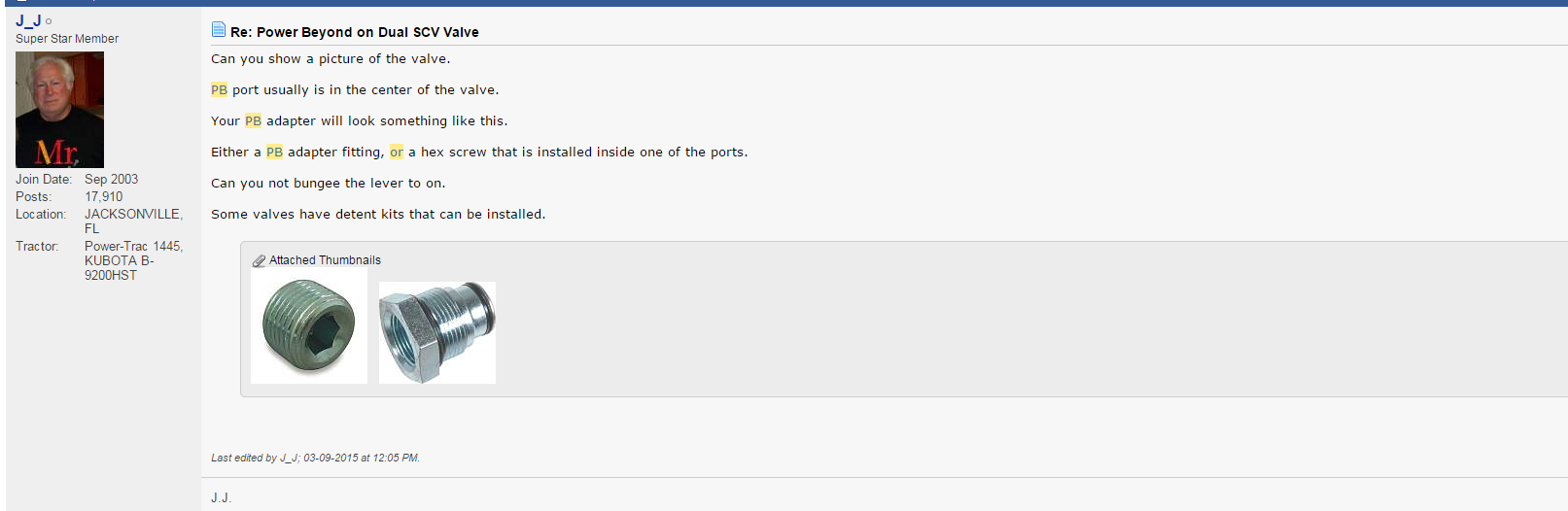

J_J
Please don't take offense when I disagree with you but this post of yours below appears to me that you're referring a PB as "power beyond" which to my knowledge a JD closed center hyd system does not have. All I'm trying to do is keep the information posted as true as possible.
Jim
   / JD2130 hydraulics work but no pressure when working loader or implament #10
No problem.
I know PB and closed center terms are not supposed to be used together, but a PB port with adapter is used to make some valves a closed center valve.
I know all valves in an open center system are in series, and the line that carries the flow from one valve to another is called a PB line.
I also know that all valves in a closed center hyd system are in parallel, with one feed line or whatever you call it.
I know that only one relief valve is used for all valves in a parallel hyd system.
What would you call the flow/pressure line from a closed center pump? The supply line actually goes to an IN port on each valve.
