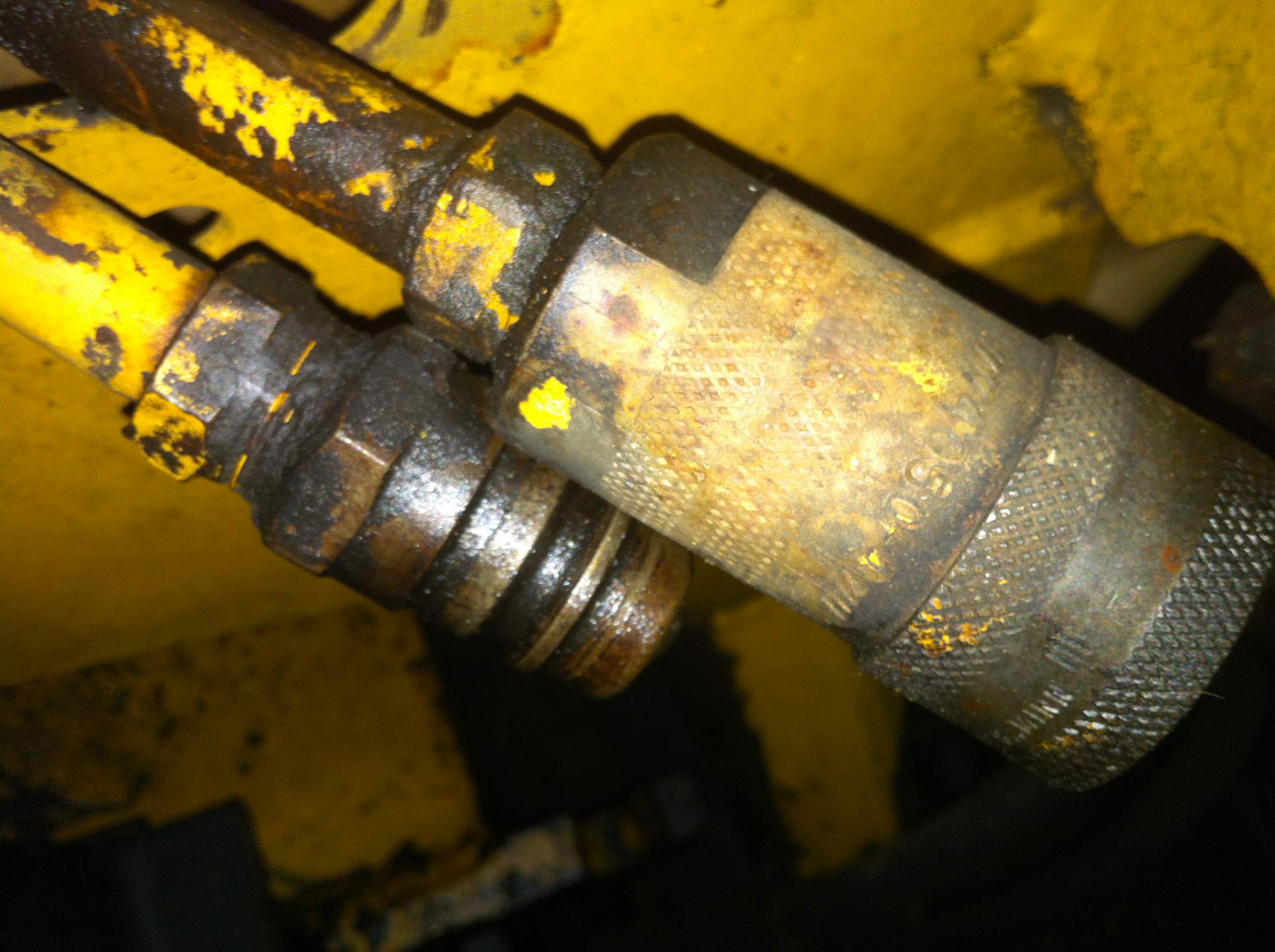

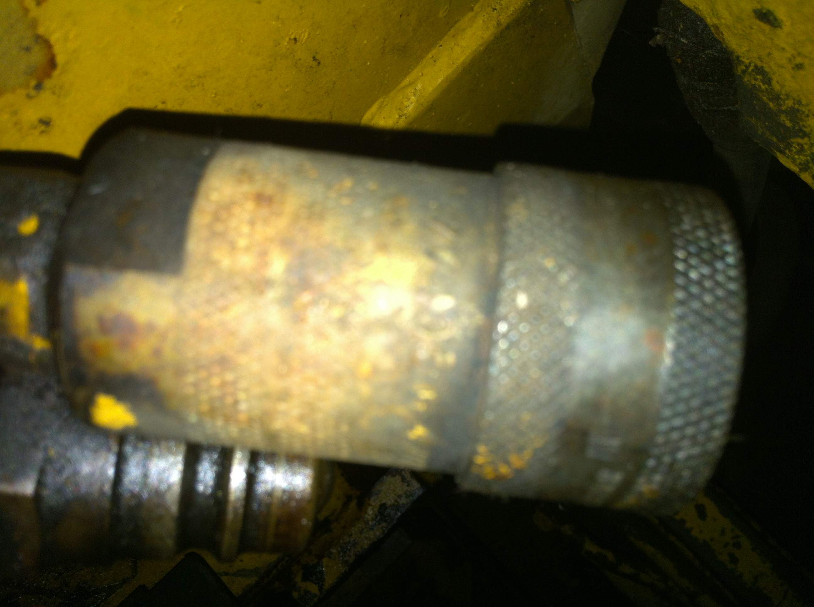

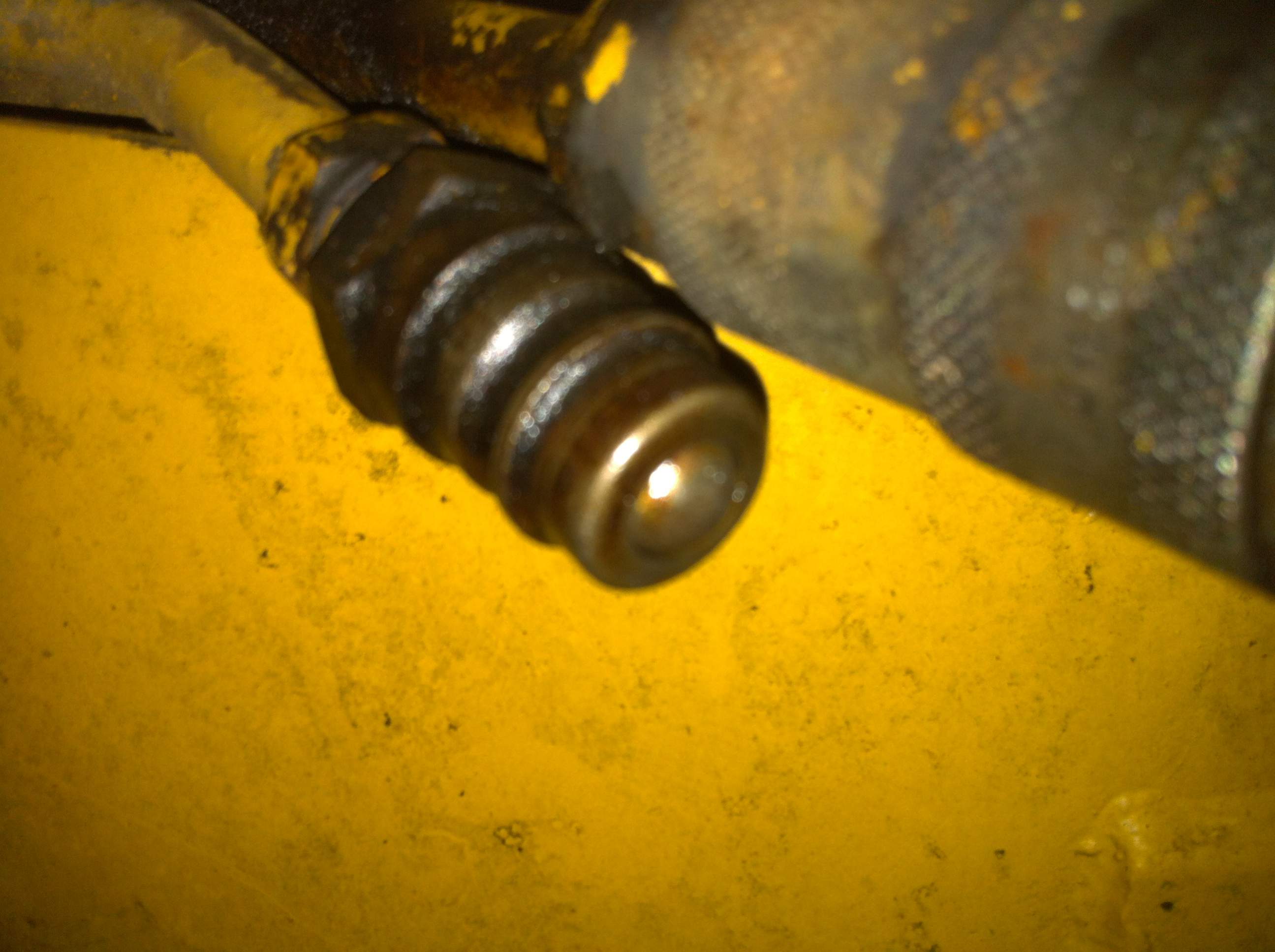

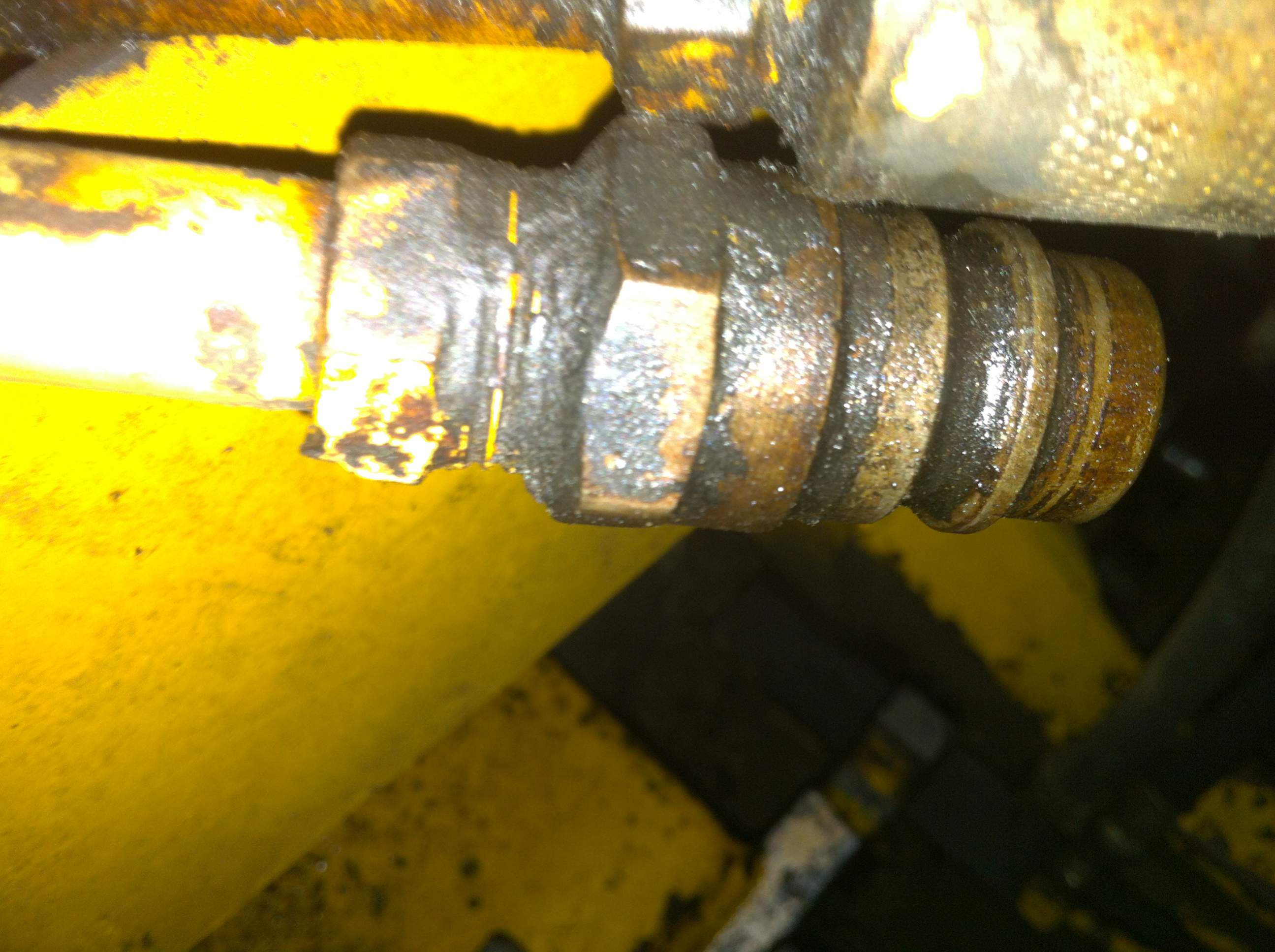

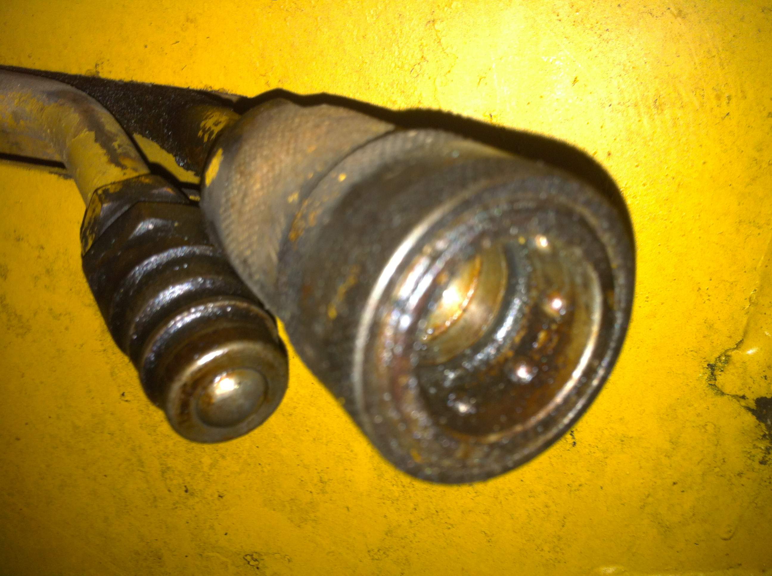

I'm the new owner of an old skid steer machine. This one has front connections, but they look different than most that I've seen. Can anyone tell me if they recognize this connector? I am not familiar with hydraulics, so if the answer is obvious I apologize.
Everett
   / JD24 aux front hydraulic connections #2
They look like std AG couplers instead of Skid Steer Flat Face couplers
Do you think I should replace them with flat faced couplers? The male one leaks a bit anyway.
   / JD24 aux front hydraulic connections #4
Most hyd attachments for a skid-steer will have flat face connectors.
They are also easy to keep clean, and most can connect under low pressure, and some under full pressure.
Thanks. I have a feeling the PO had a log splitter on the front that he powered with this style. I ordered a couple sets for future attachments.
I ran into a bit of a problem. I got these couplers Flat Face Flush Face Skid Steer Hydrulic Coupler Faster 2 Pair | eBay and they appear to be slightly small for my connections. I measured my threading at 14 tpi and a small end taper diameter of 0.725 inches. I'm guessing that's 1/2 NPT which is what I thought 2FFI12 connectors were. Is there any harm in running with an adapter once I figure out the size mismatch?
   / JD24 aux front hydraulic connections #7
Adapter will not be a problem.
