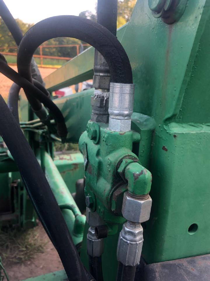

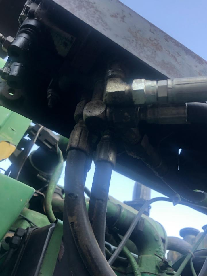

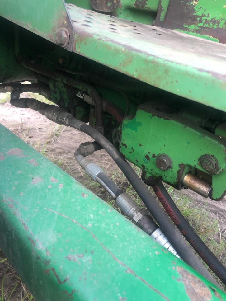

   / JD2750 MFWD w/loader hydraulics get weak after short time running
   / JD2750 MFWD w/loader hydraulics get weak after short time running #7
FEL valve hoses are attached correctly to your tractor. I suggest to check to determine if FEL control valve is designed for closed center hyd system. You can perform a test by disconnecting return hose(see photo below) from hyd filter cover & cap fitting on filter cover. Then with both FEL control valve levers in neutral, aim open FEL valve return hose in a bucket then start engine & NO oil should exit hose.
