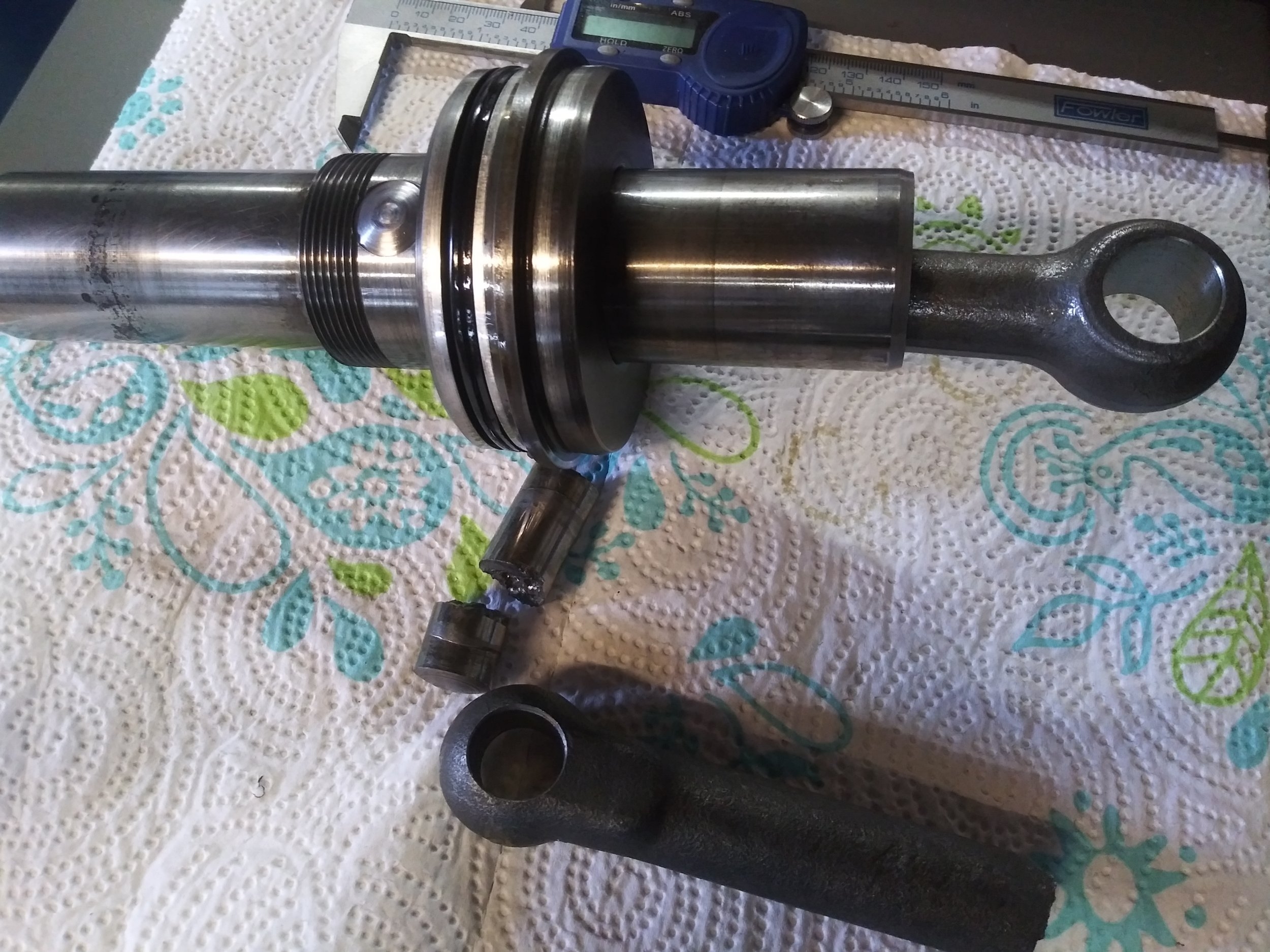

Jd400 recently put in new seal kit in the steering wheel body because it was leaking at the top and it was working good, no issues other than chasing leaks, first in the nylon return line then side cover with the bushing below steering wheel.
Yesterday the left tire went up slight incline and cocked hard left and I lost 99% steering.
Looking for opinions, I think i blew a seal in the steering wheel body when the tire went hard left and the pressure was too much for the seals.
Update: Shaft broke off 2" above the pin. Not sure if I could weld it back together or if I need find new assembly.

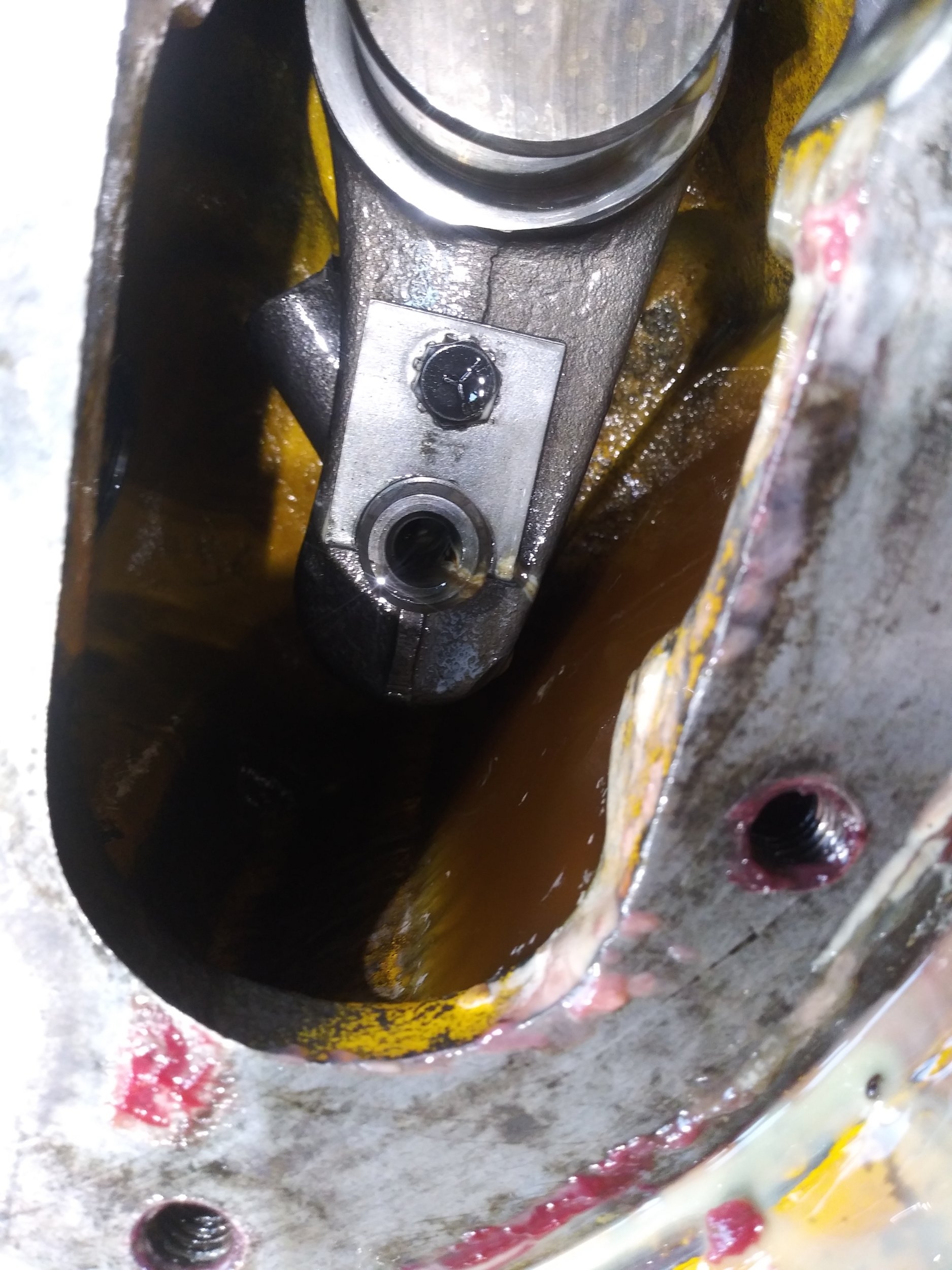

   / Jd400 power steering failure #2
I suppose opposite ear is intact. I think successfully welding ear back in place will require removal of shaft(part # T36482). There is very limited space to "V" then weld area of ear furthest from view. I think tractor salvage yards would have a more than ample supply of the used shafts.

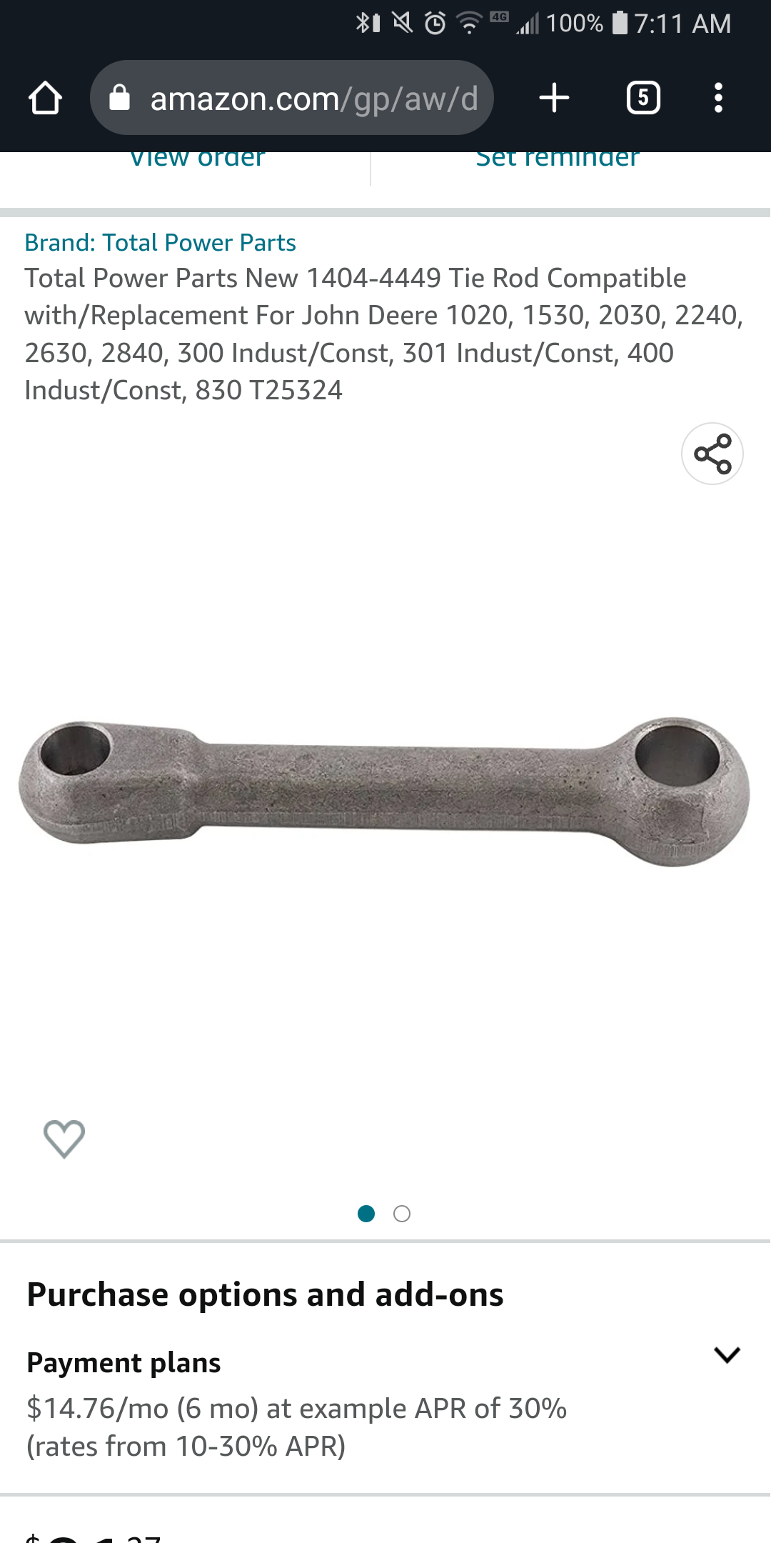

I found the replacement part. Thankfully I won't need to try repair it.

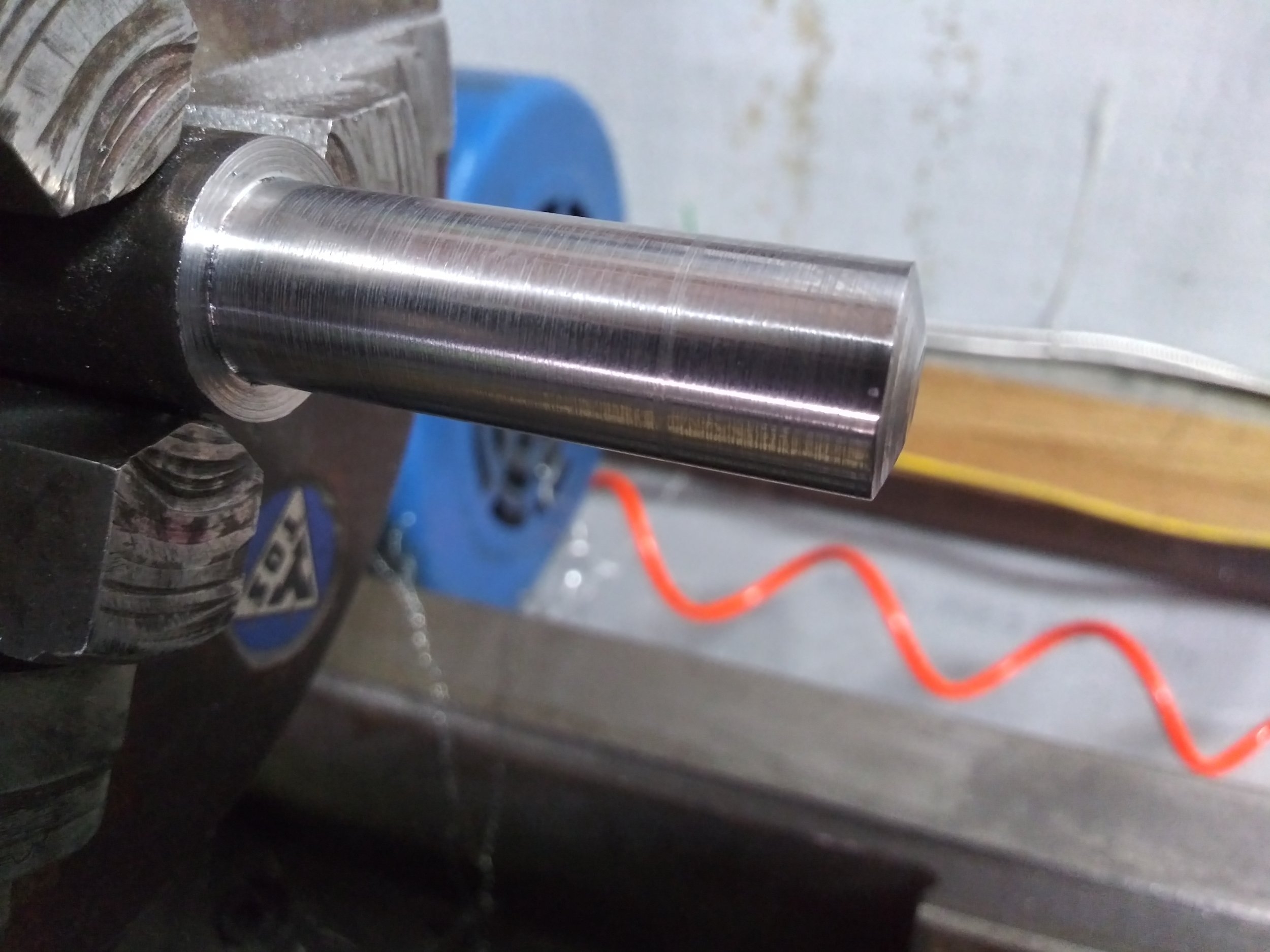

Here's the finished repair. Ended up breaking the pin pressing it out so I had to turn a new one. The pin is 1.75 x .621.

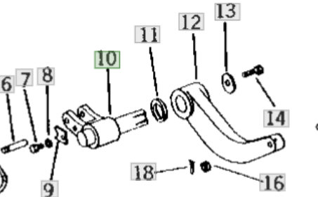

Do you have part# for #11 oil seal? Could you recommend where to get the parts catalog from? I see ones on ebay but they only cover the tractor.
#12
Found part diagrams! For anyone needing part # and diagrams go to: jdparts and search PC973. Backhoe PC864 Loader PC980
