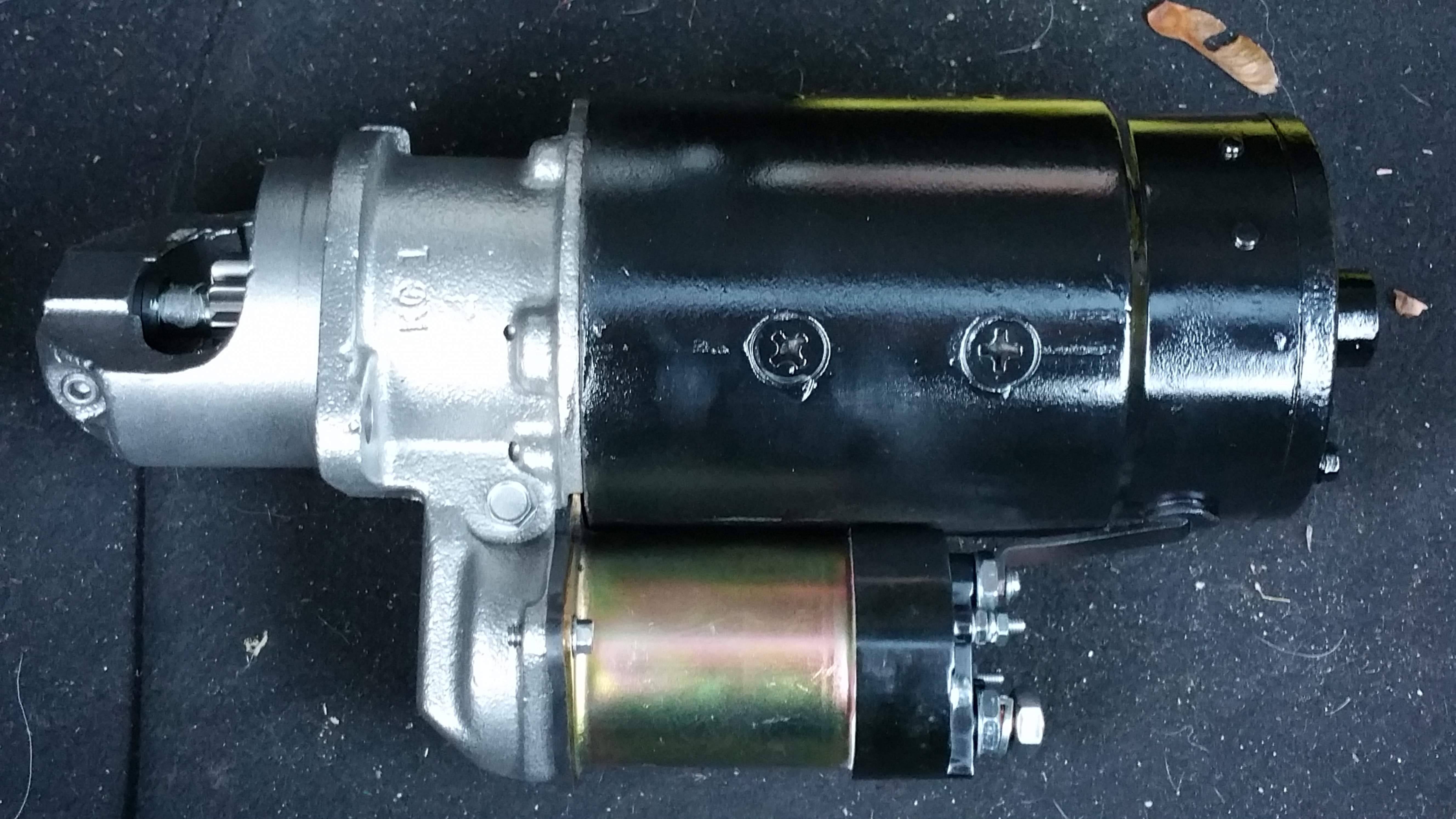

I got it back today and it looks like new. It's shiny and amazing looking. I hardly recognize it. They said they had to rebuild the whole thing.
I stopped at a couple tool places, trying to figure out if there was anything that could help me get these bolts back in place. I settled on a low profile 1/4" rachet with a short handle and a set of 1/4" sockets that go up at least to 9/16", since that is what I need. Hopefully this will let me squeeze in there and tighten them up faster than I got them off.

BTW, I grabbed a picture of the starter to show what it looks like before installation:
   / JD400 Starter issues - Service manual
End story: Starter installed fine. Tractor fired up, easier than ever.
It installed much quicker than taking it out. I think the take-away lesson is that I should use liquid wrench products more heavily. I tend to hold off using them unless I can't get something to budge. In this case, I think if I had used them on the starter bolts I could have gotten them loose enough to turn by hand earlier and it would have saved me a lot of time/grief. I cleaned off all the threads before re-installing, and I was able to tighten them by hand most of the way very quickly. Then used a wrench for the last little bit.
