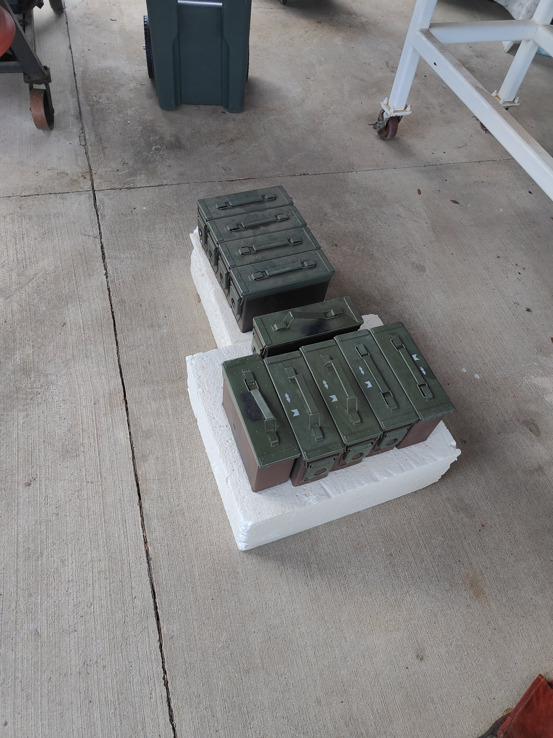

I have a JD4300 with a 430 front loader and I would like to know if I could substitute the fluid filled tires ballast with more weight one the 3p hitch. I am currently in the middle of fabricating a 3p hitch receiver to carry those ammo cans filled with lead.
As per the manual, it requires a 3p ballast of 600kg and fluid filled rear tires. It also has an option of 550kg 3p, fluid filled tires and weights on the rims.
Thanks in advance

You can use 3 point ballast in place of fluid filled tires. I prefer both for loader work and general traction though. Filled rears help keep the tires planted, and 3 point ballast does the same, plus takes weight off the front axle (to some degree).

I do expect to lift heavy loads. How does affect your FEL when you go up on weight? This is the reason i poured the lead into ammo cans so i can remove and add weight as needed.

Also I really like your idea of ammo cans with lead in them. It's a really dense weight which will help you keep things compact. Guys on here talk about how they can use their tiller or a rear blade for a counter weight. Yes it works as I have done it but a nice compact setup with the weight as close to the tractor as possible makes it so much easier to maneuver in close quarters. I used to clean corrals with my tractor and fel. To have the ability to turn around in a tight spot without hitting the corral walls came in very handy many times.

I do have a lot dirt to spread out. I am going max out the 3p ballast to dump the dirt with my fel then change the ballast for my box blade to spread the dirt with the fel and box blade.
Also I really like your idea of ammo cans with lead in them. It's a really dense weight which will help you keep things compact. Guys on here talk about how they can use their tiller or a rear blade for a counter weight. Yes it works as I have done it but a nice compact setup with the weight a close to the tractor as possible makes it so much easier to maneuver in close quarters. I used to clean corrals with my tractor and fel. To have the ability to turn around in a tight spot without hitting the corral walls came in very handy many times.
The three main reasons I did this is because my property is not that big, i can easily add/remove weight and i got the lead for less than 50 cents per pound. Once i am done fabricating my 3p ammo can carrier / hitch receiver I'll share the pictures.
