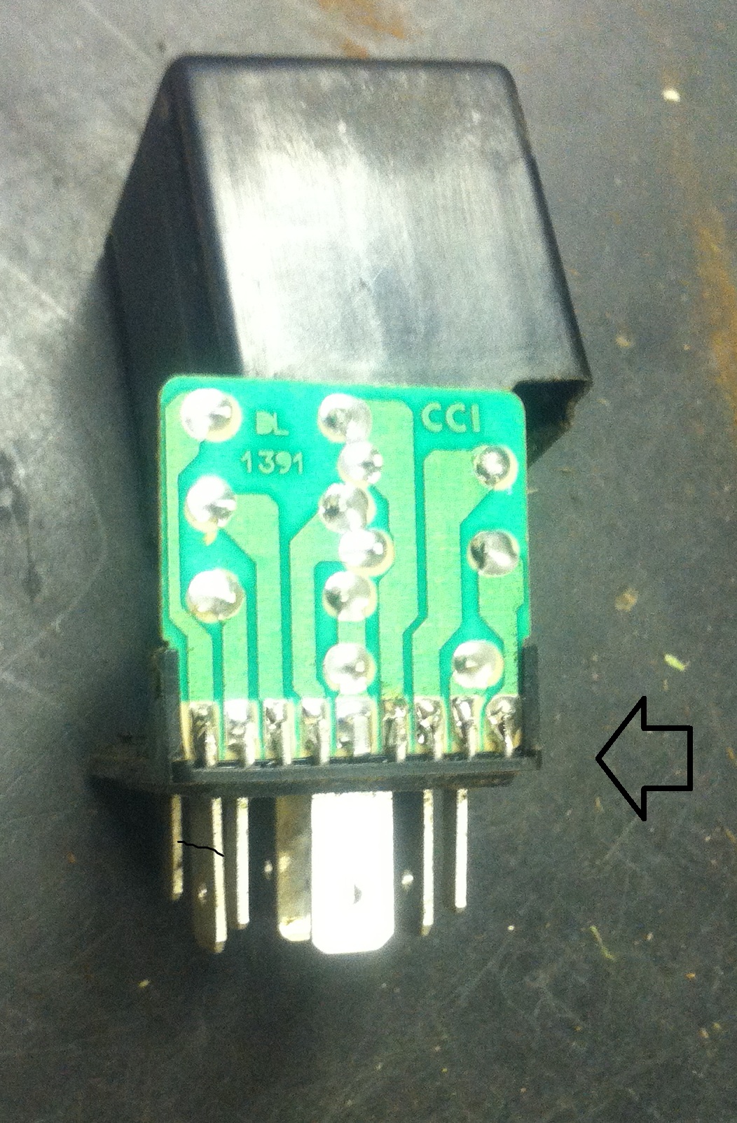

I finally got time to find the problem so I thought I'd report what I found incase it can help someone else out. I removed the blown flasher fuse and connected the fuse terminals with my ampmeter so I could momentarily flip the flashers on and see how much current was being drawn. With a schematic in hand I proceeded to unplug parts of the wiring under the dashboard. The flasher circuit is connected to diode packs under the dash. I removed them and tested them with an ohmmeter. I was getting intermittent readings with my ohmmeter and the cover was easy to pop of so I removed it and was able to see cracked solder joints inside. I attached a photo of the diode pack with cover removed. The arrow is pointing to where the solder was cracked along the edge of the little circuit board. This was not the cause if my fuse blowing problem, but I resoldered it anyways. I figure I'm fixing another intermittent problem before I notice the symtoms. Both diode packs under the dash had broken solder joints.

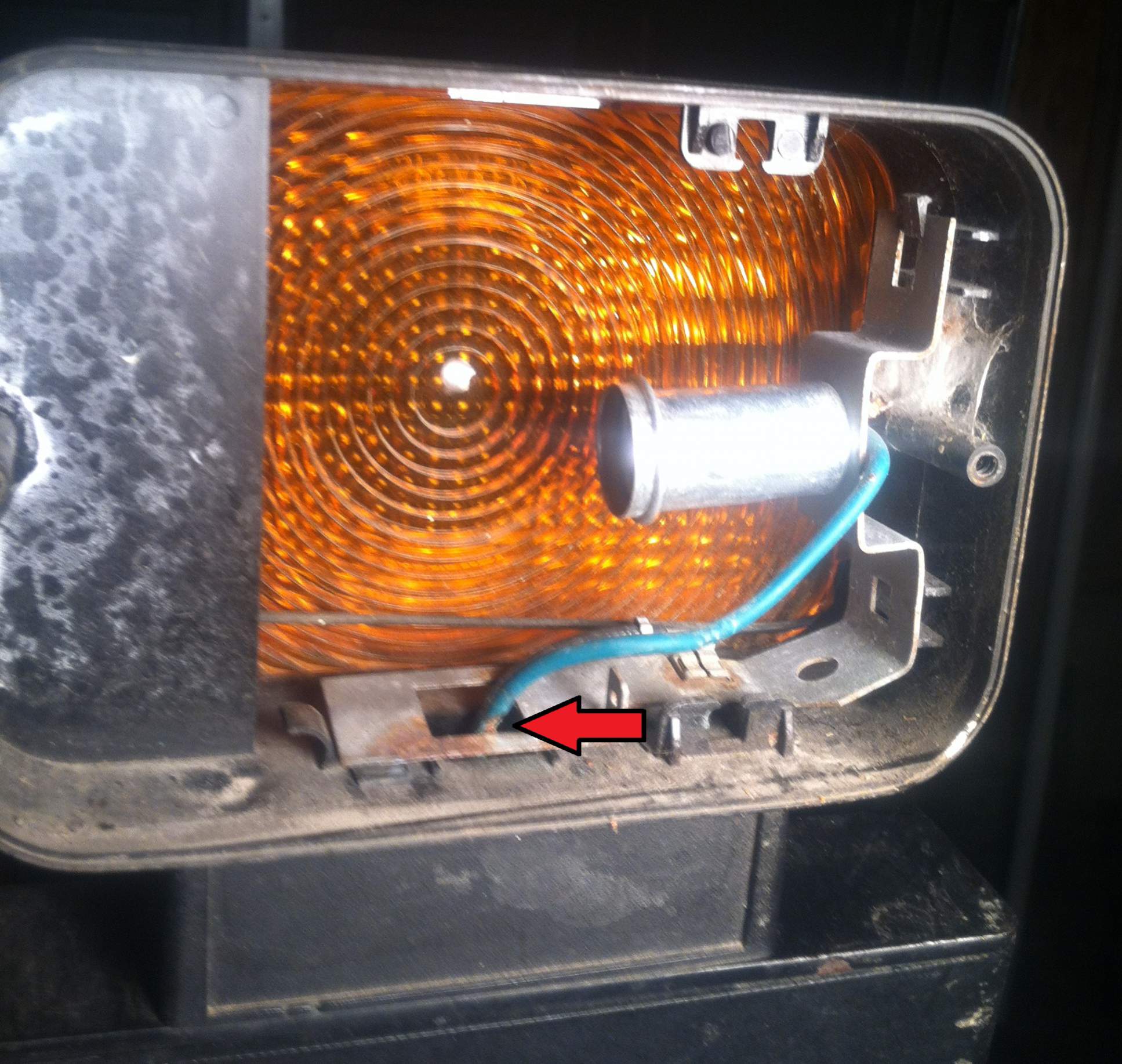

Back to finding my short... I unplugged everything I could under the dash and I removed all the light bulbs in the flashers and found that the wiring going to the lights was still shorted. Examing the wiring, I discovered that the wire had worn through the metal piece that holds the light socket. The wire had no slack and that caused it to be tight against the metal. I found the same problem on both flashers. My fix was to cut the wire, solder in a 3" piece of wire with a plastic tube over the wire so it would no longer rub against the metal. The attached picture shows the location of the short. These are the yellow flashers that are mounted on the roll bar.
