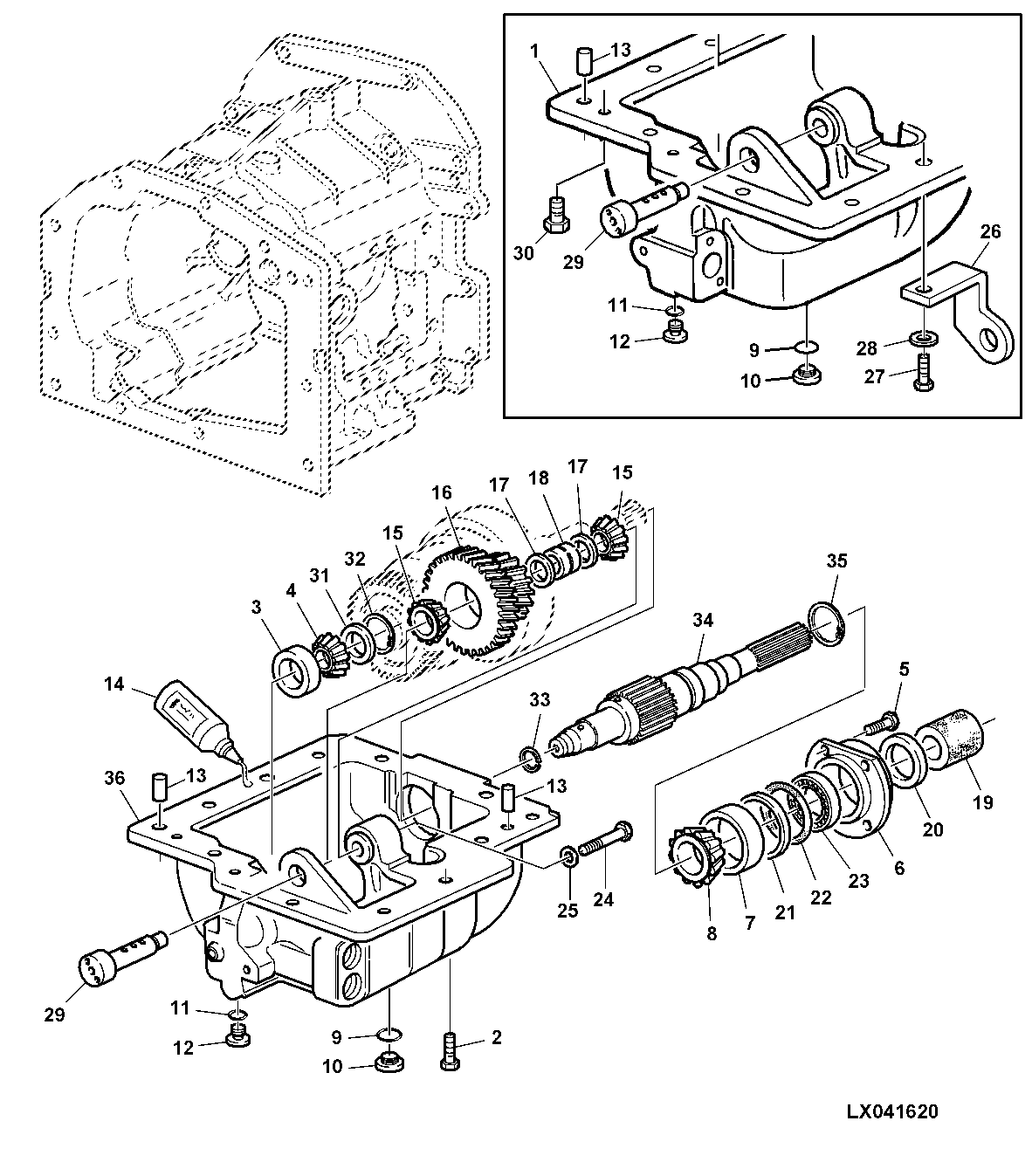

   / JD6410 remains in FWD #5

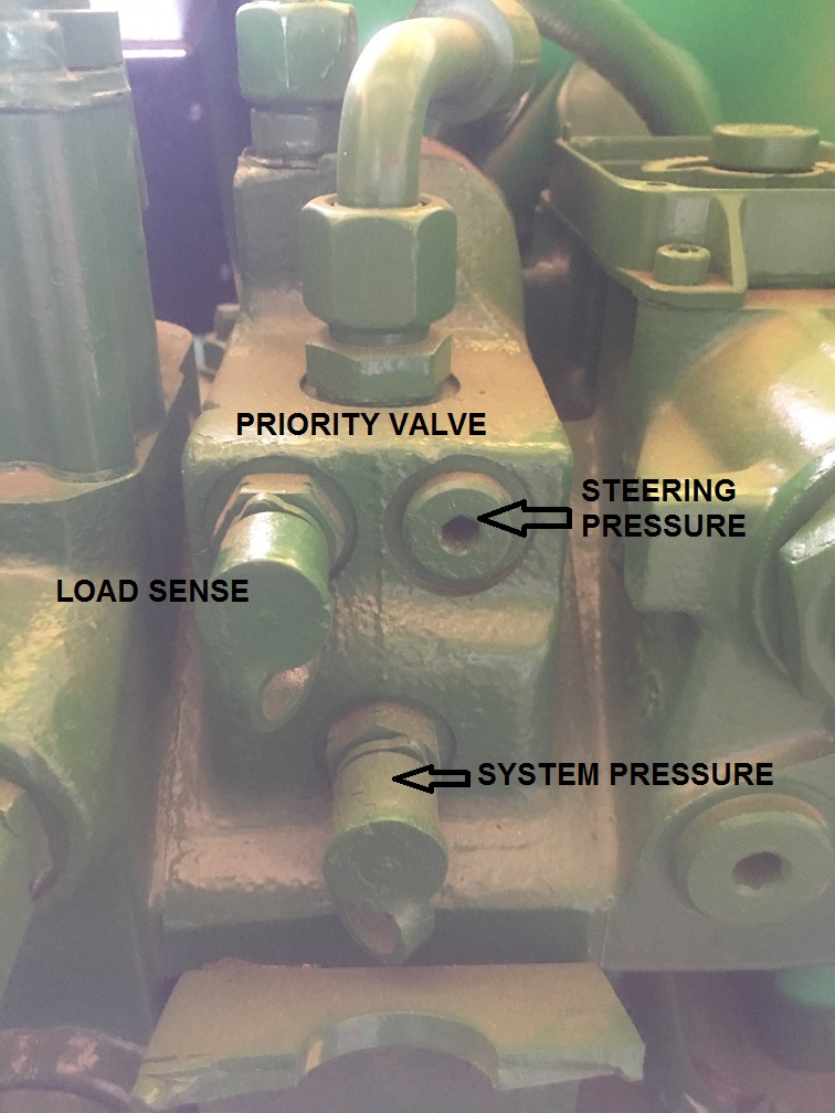

To check transmission system pressure, there should be a port marked SYSTEM. There is also a SYSTEM port on the Priority valve at the rear of the tractor. There are three ports, two on the top and one at the bottom. Bottom one is system pressure. The top two are load sense and steering pressure.
For the MFWD (mechanical front wheel drive, so not to confuse FWD with forward), test port is at the bottom by the solenoid, key 12 in the drawing. You must have pressure to disengage MFWD (170psi for USA tractors)
Again many thanks.
Will leave transmission for now since now problems there.
Found key 12: L41709 PIPE PLUG.
Hex bolt that sits above the draw bar next to solenoid.

   / JD6410 remains in FWD #7
Again many thanks.
Just some planning:
Is there a deluge of oil going to flow out?
That's the plug. Never worked on one, so no idea how much oil you will lose.
Ok, my friend from USA.
4x4 is now working!
Adaptor and gauge gave reading of 0 bar.
Toggled rocker switch and reading remained 0 bar.
Checked reading at solenoid and 0 volt.
Pulled toggle switch out and fiddled wires, intermittent 12v output.
So, replaced it with new rocker switch and voila 10bar(145psi), and tractor popped out of MFWD!
Many thanks again.
Found Priority valve, pls check my photo for correctness.
What should the pressure be at each port.?
