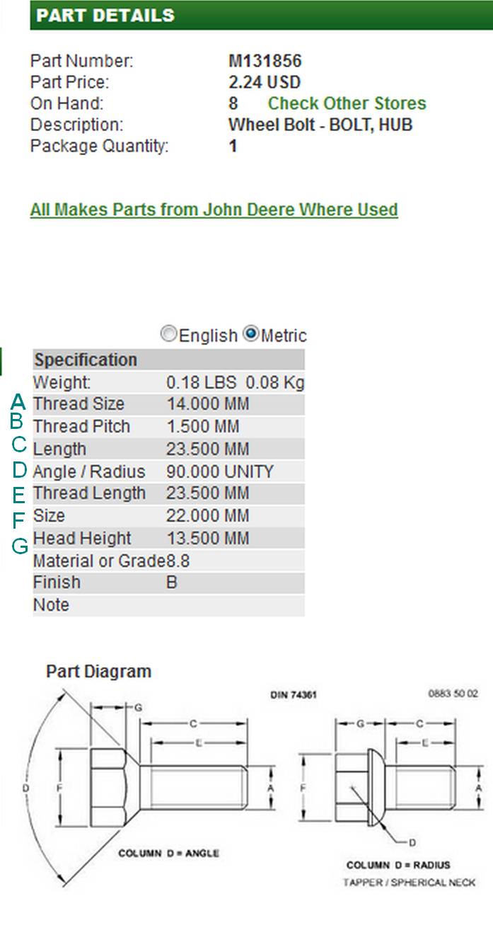

If this is the correct part number and I'm reading the diagram right, it should be 22mm.

Explain why there are three different wrench sizes listed here:
Metric Bolts - Head and Wrench Sizes
The classic standard are DIN, then came the ISO and made a mess, to save cost ISO reduced some head sizes one millimeter, 19 to 18, 17 to 16 and most cheap tools set stick to DIN. The Japanese has of course had JIS and are fond of 14 and 12 mm in the smaller dimensions.
