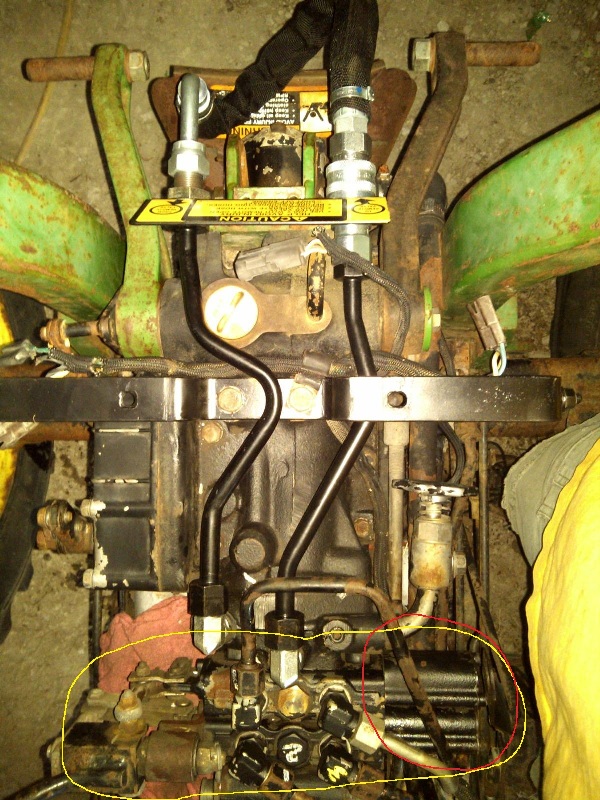

Can you show pic of your valve?
You said you had a seized valve/spool.
You mean that the lever will not move the spool at all?
Have you taken off the can's on the bottom of the valve?
There are springs under there that can get rusty from water not draining out.
The spool should move freely unless there is a spec of metal or debris binding the spool.
If the valve is controlled by cables, they could be rusty or binding.
   / jd955/ 70A loader- problem #9
Here's a picture I took when I installed the Power Beyond on my 955. Circled in yellow are the two SCVs (the spools are horizontal). Circled in red are the two end caps (as I called them) or cans (as JJ called them). Pull those off and make sure they're not all crudded up inside. Clean throughly and reinstall.
