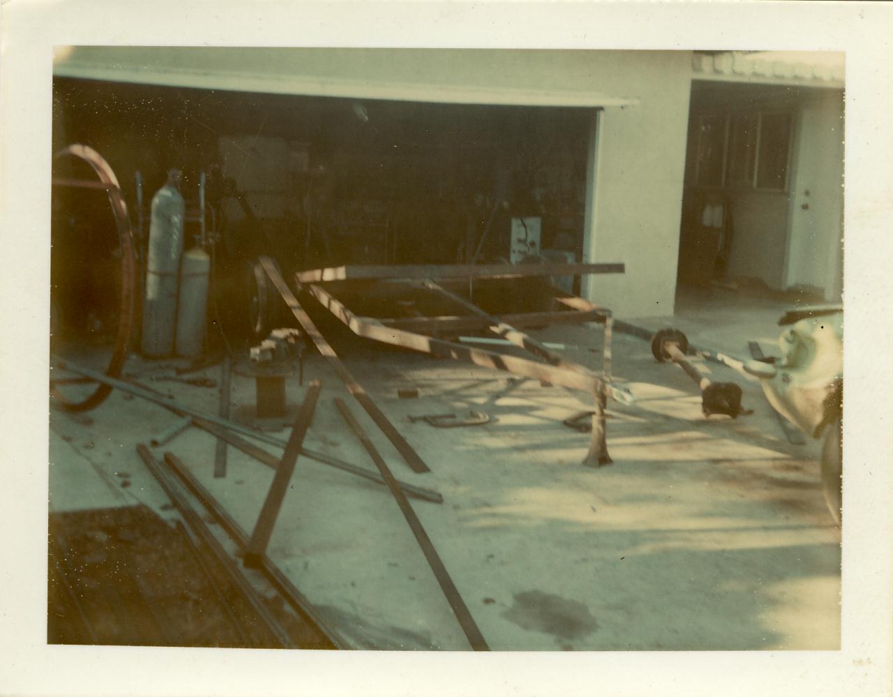

Almost thirty years ago I was playing with dirt track cars in Southern California. Budget was tight and I needed a trailer. With a street stock-figure eight car you need a tilt trailer. They're low to the ground and invariably when it comes time to load up at the end of an evening of racing and banging around for grins, well, a tilt works best.
I'd helped a friend clean up a double wide mobile home fire. So he gave me what I could salvage out of the mess. I found two decent axles and a couple of straight sections of frame.

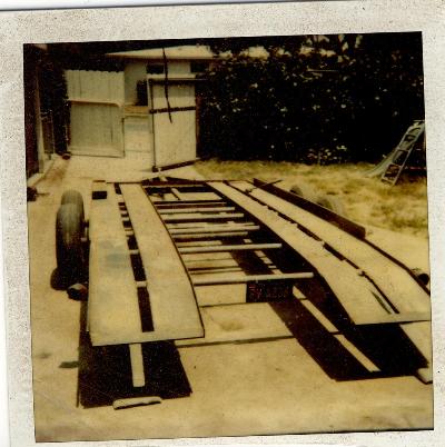

I laid the I beam frame sideways and trimmed out the flange where two pieces made one ramp.

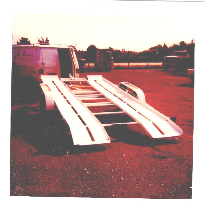

What made it work was blocks of wood.
The tongue was hinged back by the front axle. To keep it low and since I was only hauling about five miles each way I didn't use springs.
To tilt the trailer I'd release the tongue retainer. Of course the trailer would still be attached to the tow vehicle.
Next I'd place a four by six block on top of two by eight block in front of each wheel on the front axle.
I'd pull forward centering the front axle wheels on the blocks.
This would tilt the trailer.
When I sold it I put a coat of paint on it and a hydraulic cylinder jack so the new owner didn't have to look so country bumpkinish at the track.

It wasn't the greatest trailer, but I was young, it worked, and a the next season after I built it there were copycats in the pits.
I guess I wasn't the only guy on a budget those days.
So if you're wanting a tilt trailer you can use scrap materials available and a little southern engineering and get by.

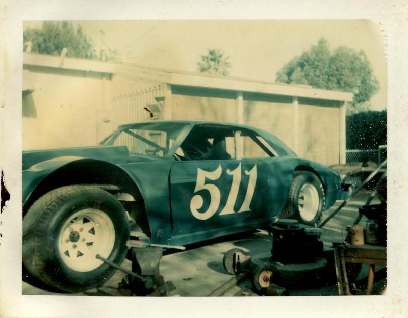

This was the second car I built for myself. It was deadly fast, terribly fun, and suffered a horrible fate.
