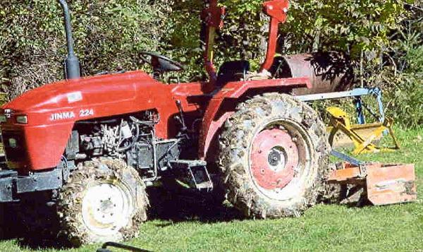

Whats the easiest way to increase the rear tire stance for stability? Switch each tire to the opposite side with wheel weight on inside? The manual leaves a lot to be desired. How many inches will the increase be? Thanks.

Hard to conclude from your photo John, but it does look like you've got quite a bit of rubber under that fender. What is the sidewall to sidewall outside measurement?
Are your rims bolted to the inside or the outside of the spokes?

Ttractor is how it came. It is 50 miles from here and was wondering the ways to increase the spread. Thanks..

Anyone with axcess to a mill and metal lathe can make a spacer as wide as needed,match it to the axle,bolt it on and bolt wheels on /forums/images/graemlins/cool.gif

Without making a spacer what is the way to get more width. Back to my original post...Thanks..

JohnK,you can take the centers of the rims off and reverse them and gain about 8-10 inches.Not a big deal to do
