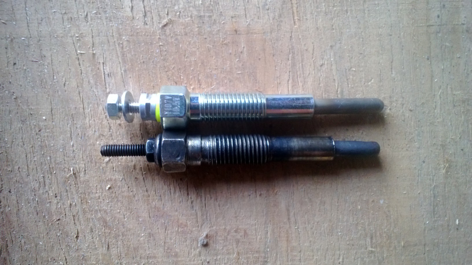

Happy to be a new member of what appears to be a great forum. I have recently acquired a JM-254 circa 2001 with a Y385 engine. I appear to be getting some blowby characterized by loss of power under load and smoke coming out of the crankcase breather. Tractor does start and run. The tube connected to oil fill on the valve cover is sucking and free from obstruction. From my research on this forum and CTOF it appears that my most likely candidates for this are stuck/bad rings on one or more of the pistons or a crack in the block. Before tearing everything apart I'd like to test compression. I suspect that pulling the glow plugs and testing compression there is my best bet. Can anyone help me with the following questions:
1. Am I missing any obvious or easy troubleshooting steps here?
2. Are there any best practices or known procedures out there for running a compression or leakdown test on these. Anyone know what the glow plug threading is?
3. What sort of pressure should I see? Specification on Y385 is 22:1 so I'd expect 22 atm or 323 psi or more right? Anyone have practical experience on this value?
4. As long as I'm pulling the glow plugs for compression testing I plan to replace them and the sealing rings? Manual says model 1055 Part No. Y480G-12200 it also calls it the "A Shrouded Electrothermic or Preheat plug 10-12-65, 12V" I'd sure like to cross these to a locally supplied champion, ngk or autolite part number anybody have some advice on how to do that? I've tried calling napa, autozone, etc with no success

Not sure on the actual cylinder compression readings-Bob Rooks may be able to help, as for the electrothermic plug, I just replaced mine on a Shanghai tractor the part was only about $20 plus shipping I'm sure Affordable or Circle g or Farm Boys can help- that's where I got mine...But the others can help to...
OH and WELCOME to TBN:)

gromitbeast I re read your post and think i may have given you bad advice about the elecrothermic plug ,I checked my Invoice and believe the same nomenclature is being used for a heating only glow plug and a fuel type electothermic plug. my part # for the fuel type(it has a fuel connected as well as switched 12 volts) isGLW-cT26 fits TY-395, 495A,4100 engines'
The main thing with the electro thermic unit I listed is there is only one, and it is mounted at the beginning of the intake manifold..and also has a diesel fuel line attached to it. From your description the type you want is a true glow plug that heats the combustion area and mounts in the head and you have 1 for each cylinder with no fuel connections. i would call Tommy
Affordable Tractor Sales
http://api.viglink.com/api/click?fo...ales Company&jsonp=vglnk_jsonp_13665580452137 think it works now:thumbsup:

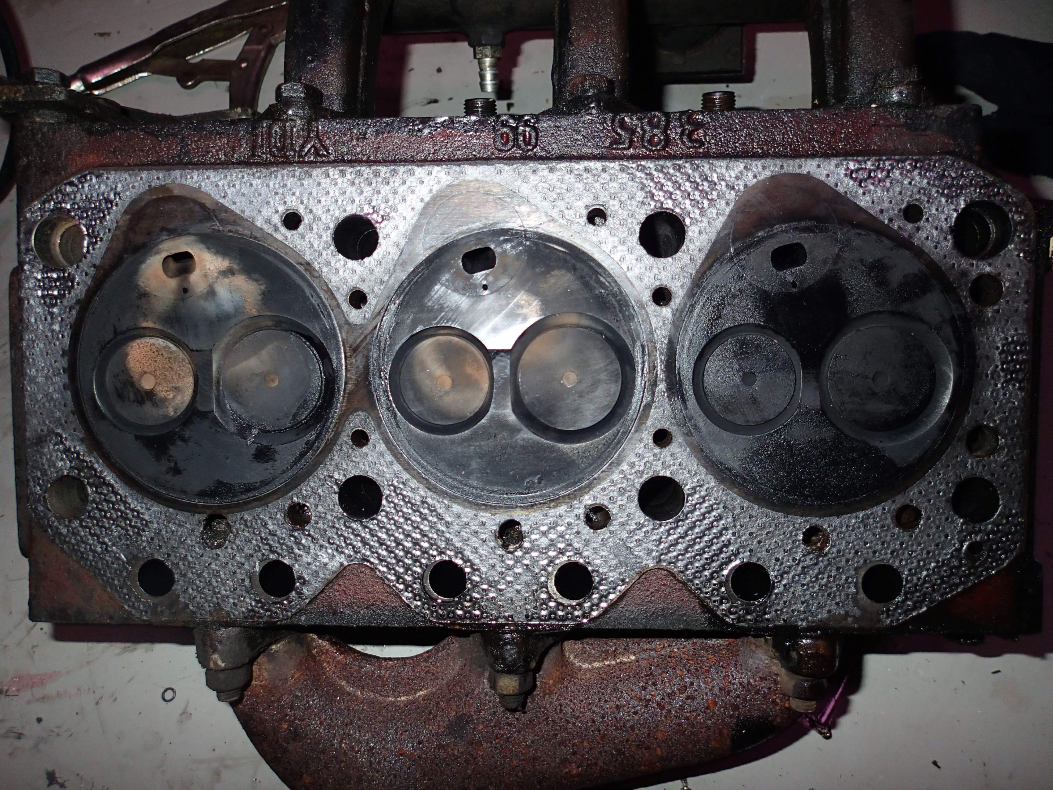

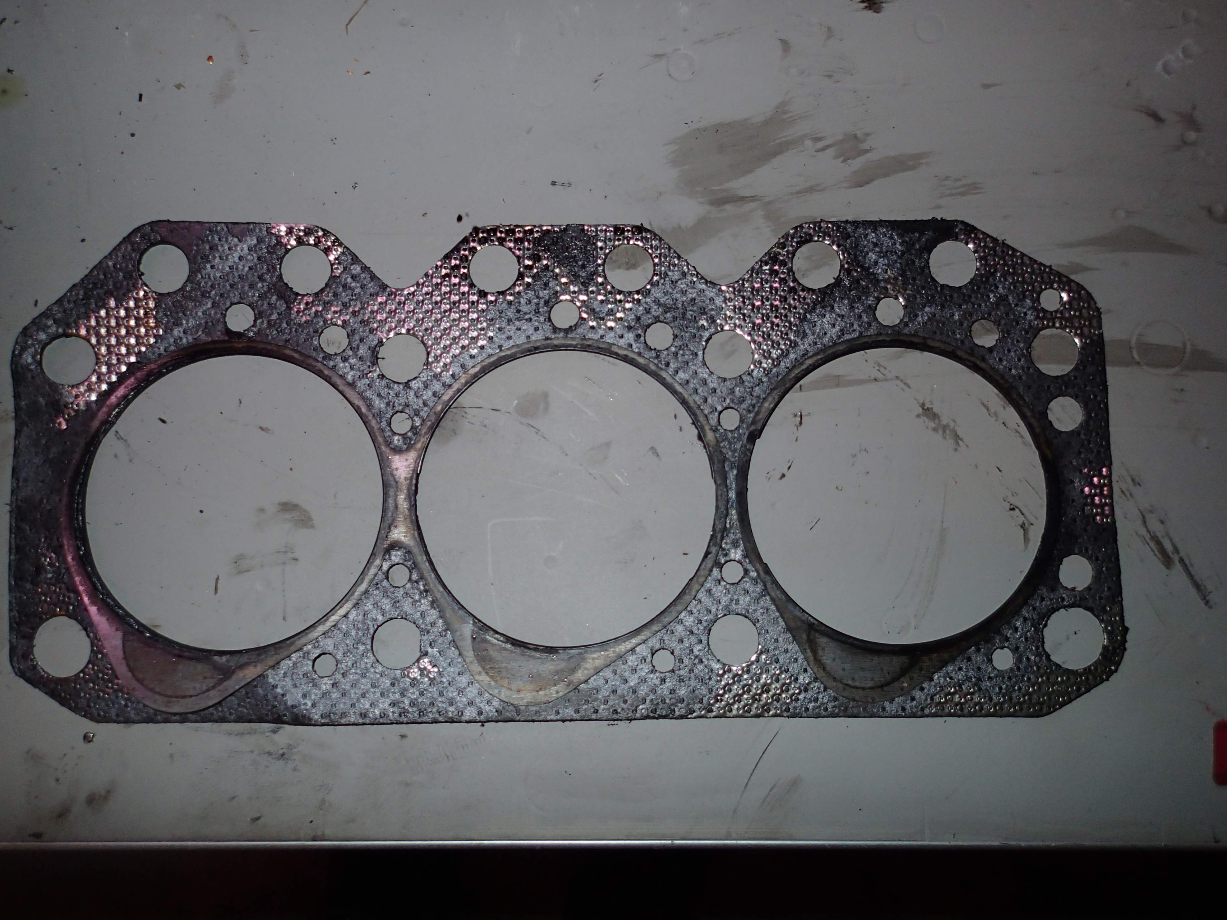

After some additional testing (leakoff > 25% in each cylinder, adding oil (per Bob R), adjust valve lash, etc.) I decided to pull the head. Upon removal I noticed the head gasket was in pretty bad shape (see pictures) and it looks like there may have been some cross flow between cylinders 1 and 2. I brought the head into a performance shop to get it magnafluxed and they suggest reface, and exhaust valves, guides, seals. I went ahead and ordered those as well as intake just to do a complete valve job as long as I was at it. Ordered up valve parts and head gasket / valve cover seal from Affordable and hoping to get them later this week.
Block

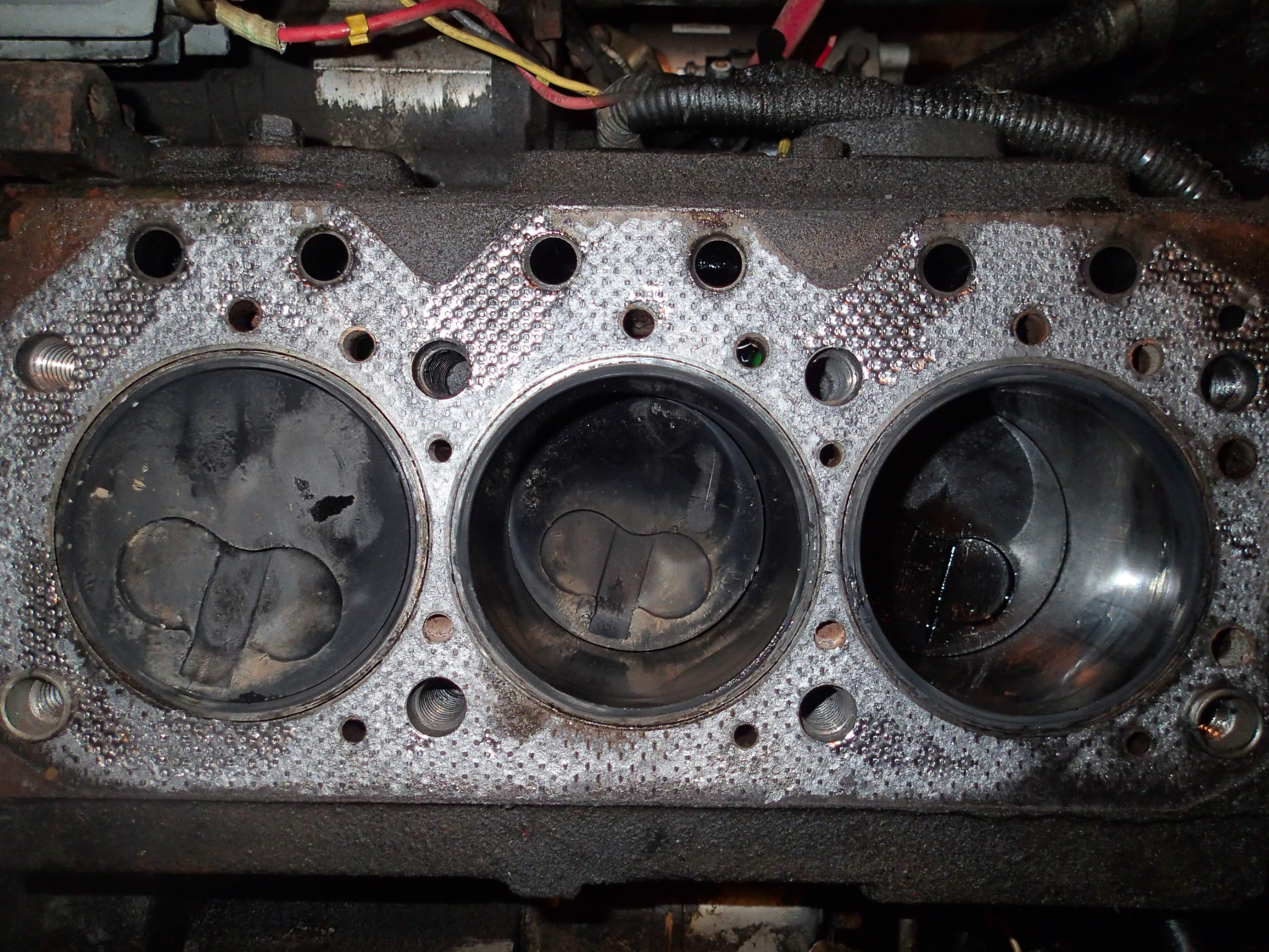

A bit of carbon built up on all cylinders and some dings on top of the pistons in all cylinders makes me think something nasty got in there and maybe tore up the head gasket a bit (pictures below). I've polished up the block surface with a wire brush and there does not appear to be any cracks or pitting or anything nasty. Cylinder sleeves look pretty good and tight...
Fuel
I also gave the fuel tank a thorough cleaning and there was some pretty nasty looking stuff in there. The intake filter and the wire mesh filter in the petcock were completely disintegrated. While I wait for parts/head maintenance I'm going to build my own pop off tester and try to balance my injectors having a hard time crossing from the high pressure line on the injector to 1/4 NPT but it looks like the ORB threading might do the trick. For glow plugs I've found some glow plugs (NGKY107V) that appear to pretty closely cross over (threading is perfect, length is about right, wattage slightly different see photo). I guess I'm a risk taker so I'm going to risk it and try using them (at $6 / piece v. $25 / piece for the Jinma ones I'd sure like to make these work)
Some pictures below. I'll update again once I have everything back together for a trial run. Fingers crossed.
